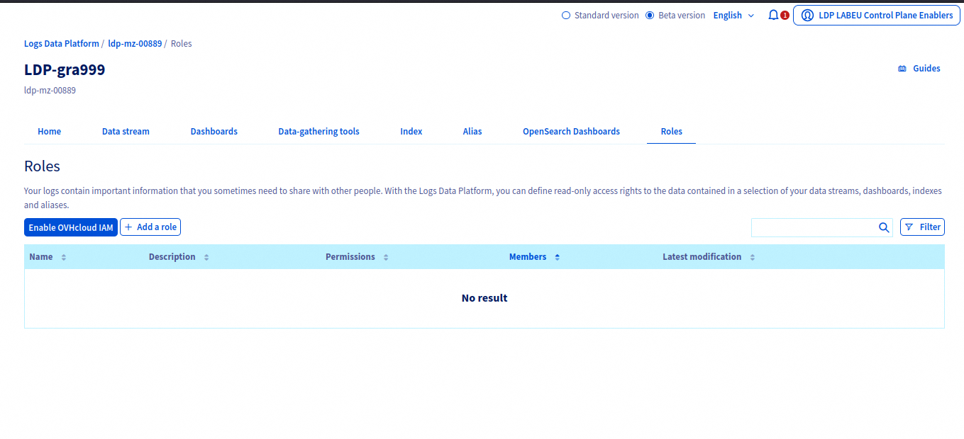

How to enable OVHcloud IAM for my existing account in Logs Data Platform?
If you have an existing service, follow these steps:
  • Replace all your Roles and permissions with appropriate policies.
  • Ensure you have no Roles declared in your service.
  • Ensure your service is not in any Roles.
  • Ensure you don't have any tokens.

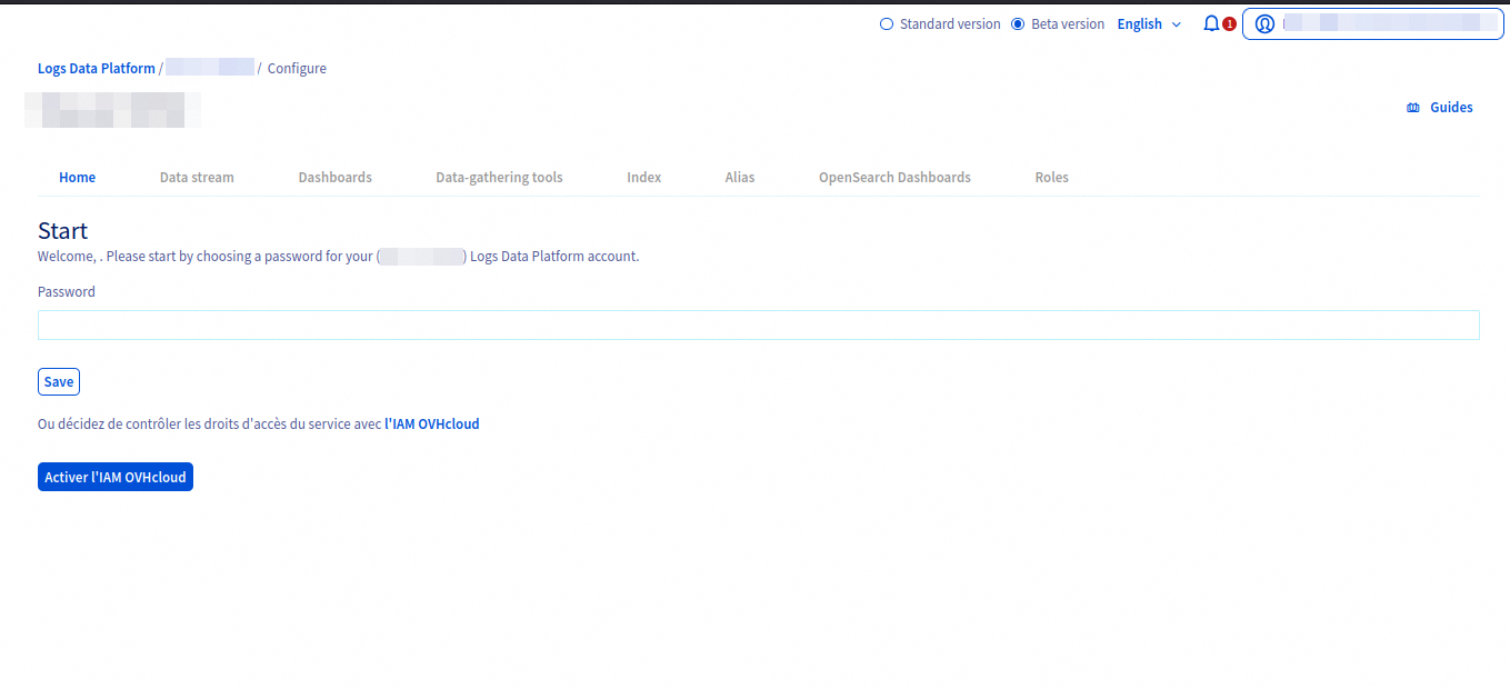

  • Use the dedicated Enable OVHcloud IAM in the Roles sections of the Logs Data Platform Control Panel.
Activate IAM

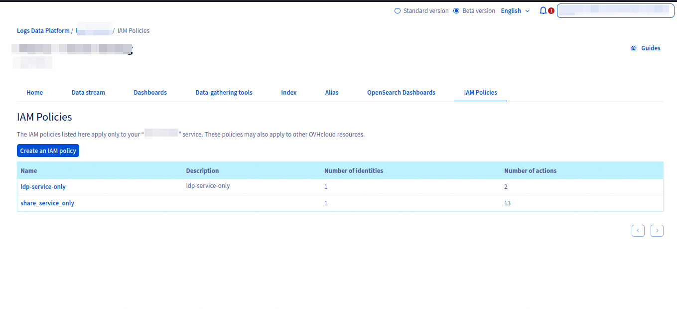

Once IAM is activated, a new IAM Policies section will replace the previous Roles section.
Activated IAM

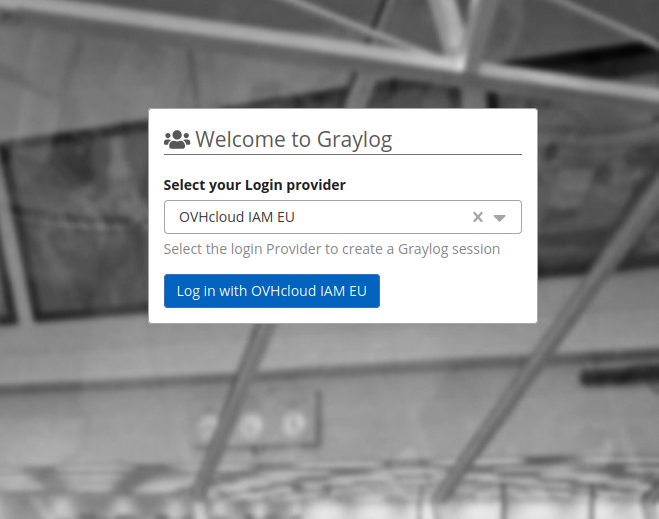

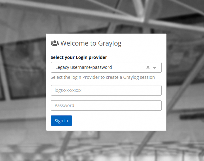

When connecting to Graylog, you can choose between the legacy username/password system (for services without IAM activated) or any OVHcloud IAM providers (EU, CA, or US). Clicking the corresponding Log in button redirects you to the appropriate OVHcloud IAM provider to complete authentication.

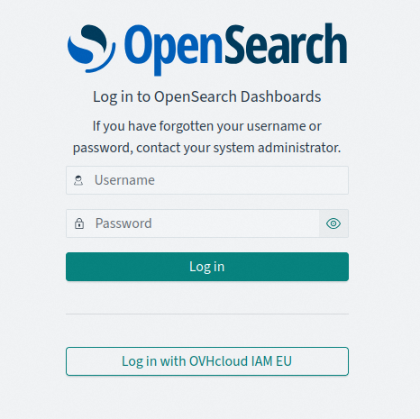

When connecting to OpenSearch Dashboards, select the provider linked to your OVHcloud service. The Log in with OVHcloud IAM button redirects you to your provider to complete authentication.
OSD login
Once completed, you will be redirected back to the OpenSearch Dashboard instance fully authenticated.

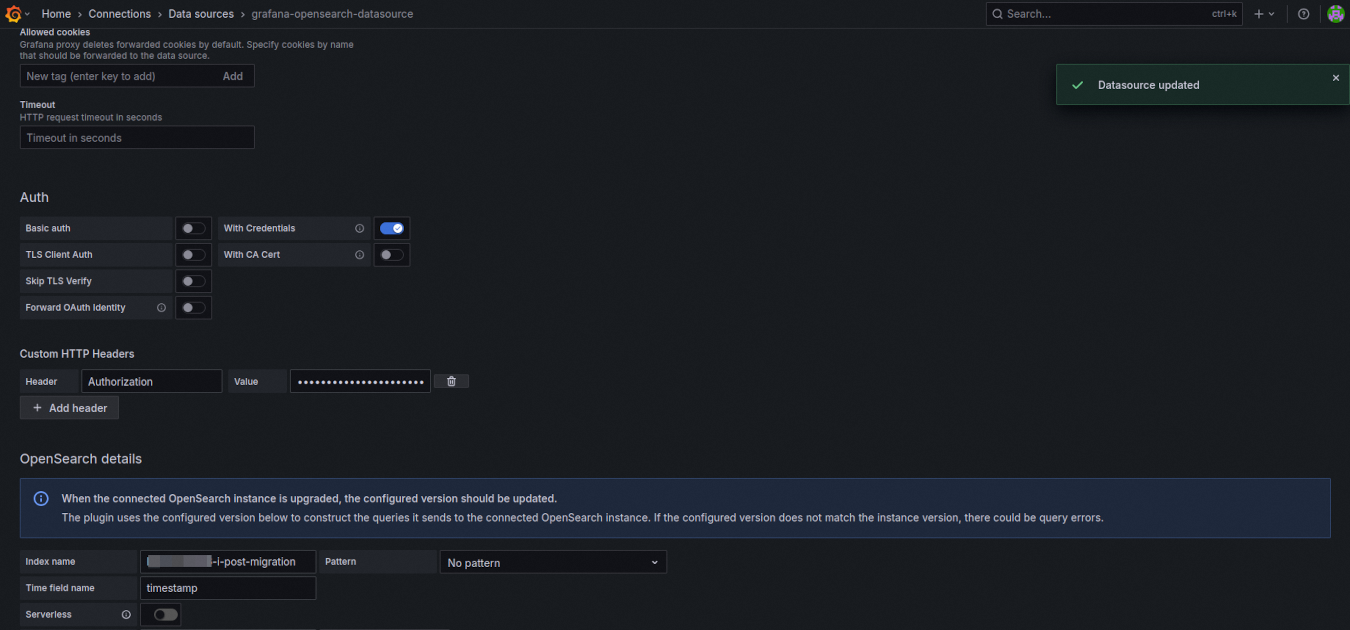

  • If your Identity Provider is the OVHcloud IAM, you can select the option Forward OAuth identity to forward the identity connected to the Logs Data Platform.
  • If you use another authentication provider, you can forge an Authorization header with an IAM compatible token. See the next section to see how to generate that kind of token. The content of the header must be Bearer: <Your Token>. Replace <Your Token> with the value of your token.
