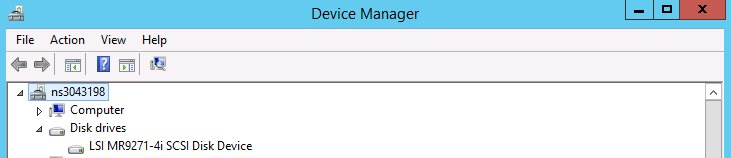

Step 1 : Verify that the server has a MegaRaid card
So we go to the menu Device management, and we see the presence of the MegaRaid card (9271-4i)
device

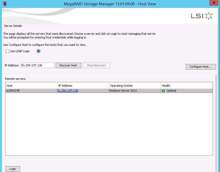

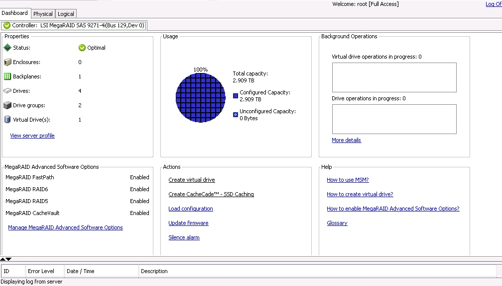

At first, we will open MegaRAID Storage Manager.
login
Then click Login, and fill in your login/password. (The manipulations in our case are carried out by being Administrator).
Then we arrive on the Management screen of the MegaRaid card.
dashboard

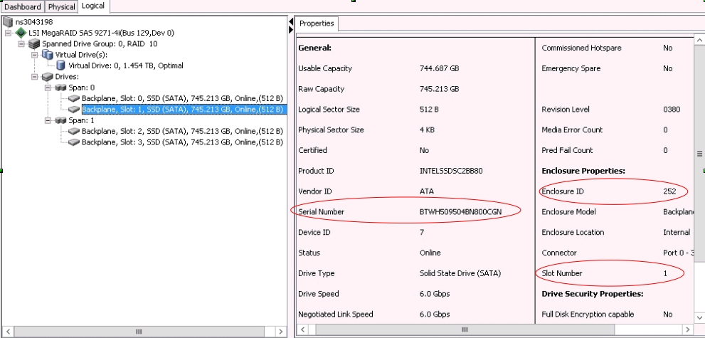

We will now check the Serial Number of our HS drive and its position in the server (Enclosure ID and Slot ID).
We go to the Logical tab, and we get to this.
logical-view-2
On this screen, a lot of information is present.
We see, on the left, the logical view of our RAID. Here we have a RAID 10 (id0) in optimal state. It consists of two clusters of 2 disks.
We can see that our Slot Number 1 drive is in the 1st cluster. On the right side of the screen, we retrieve the information we need (Enclosure / Slot / Serial).
So our disk has for Enclosure ID 252, Slot Number 1, and Serial Number BTWH509504BN800CGN.

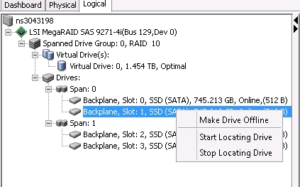

From now on, we will be able to light (physically flash) the disk to be replaced for replacement by a Datacenter technician.
Step 3 : Turn on a disk

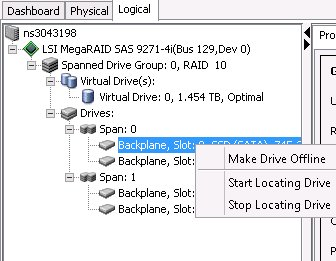

With the MegaRAID Storage Manager it will be very easy to turn on the LED of the disk to be replaced.
First of all, it is better to stop the Locator on each disk in order to avoid any error in Datacentre. Indeed, if during a previous intervention the LED has not been turned off, there will be two disks of lights on the server.
To do this, right click on each disk, and click on stop locating drive.
stop-locate
Now we can turn on the disk we are interested in.
Right click on our disk, Slot ID 1, and Serial Number BTWH509504BN800CGN.
clic-locate
Then click on start locating drive
At this point, the procedure is ready to be performed. You can then provide the information previously gathered (Enclosure ID, Slot ID, and Serial Number), and indicate that the drive is turned on.

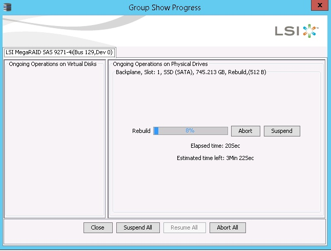

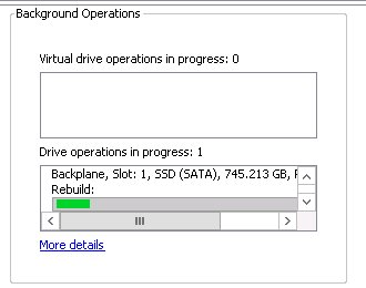

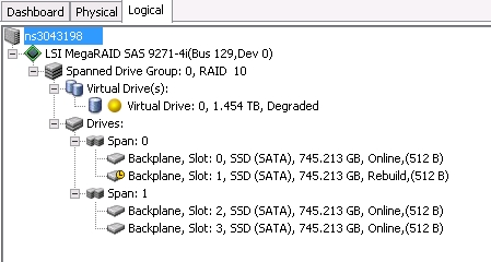

Step 4 : Check the rebuilding
Once you have completed the Datacenter, you can go back to the MegaRAID Storage Manager in the Background operations and check that the disk is Rebuild.
back
The detail will return you this type of result :
1
Also, on the Logical tab, we always have the details of RAID and disks.
2
The Slot ID 1 is in doing of Rebuild.
The RAID is in degraded state during Rebuild, which is normal.

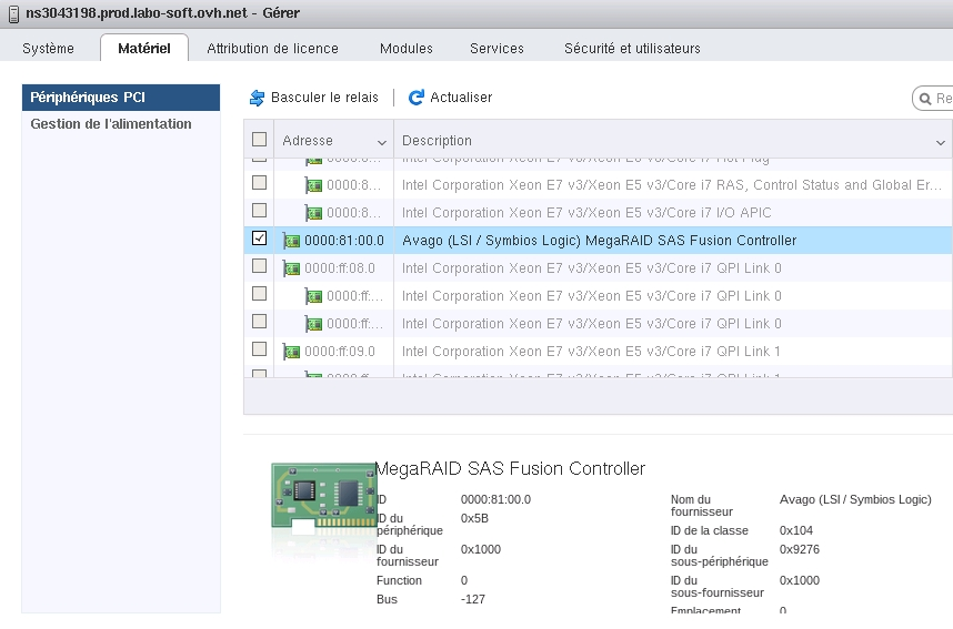

Before continuing, we will verify that the server has a MegaRAID card.
 lspci | grep -i mega
0000:81:00.0 Mass storage controller: Avago (LSI / Symbios Logic) MegaRAID SAS Fusion Controller [vmhba2]
Via the Vsphere client, you can also find this information in Manage, then Hardware Tab.
gerer-host
We have an LSI MegaRAID card.

Slot Number: 0
Firmware state: Online, Spun Up
Enclosure Device ID: 252
Slot Number: 1
Firmware state: Rebuild
Slot Number: 2
Slot Number: 3
The RAID is in degraded state during rebuild, which is normal.
You can also check the progress of the rebuild with the following command :
 [root@ns3043198:/opt/lsi/MegaCLI] ./MegaCli -PDRbld -ShowProg -PhysDrv [252:1] -a0
Rebuild Progress on Device at Enclosure 252, Slot 1 Completed 93% in 0 Minutes.
Exit Code: 0x00
