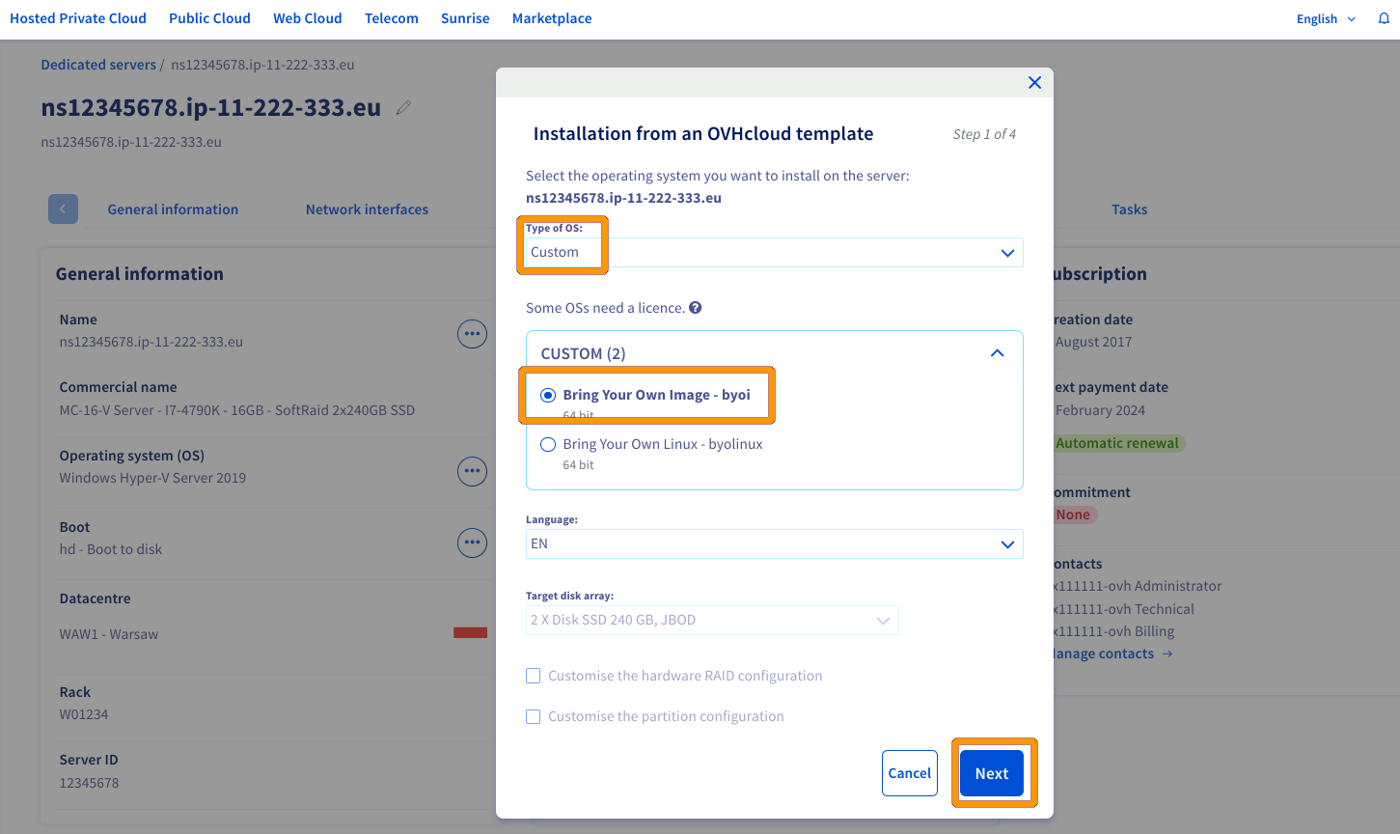

Deploy your image via the Control Panel
In the General information tab, click the ... button next to "System (OS)" then click Install.
BringYourOwnImage Control Panel 01
In the window that appears, select Custom in the menu, then Bring Your Own Image - byoi, and click Next.
BringYourOwnImage Control Panel 03

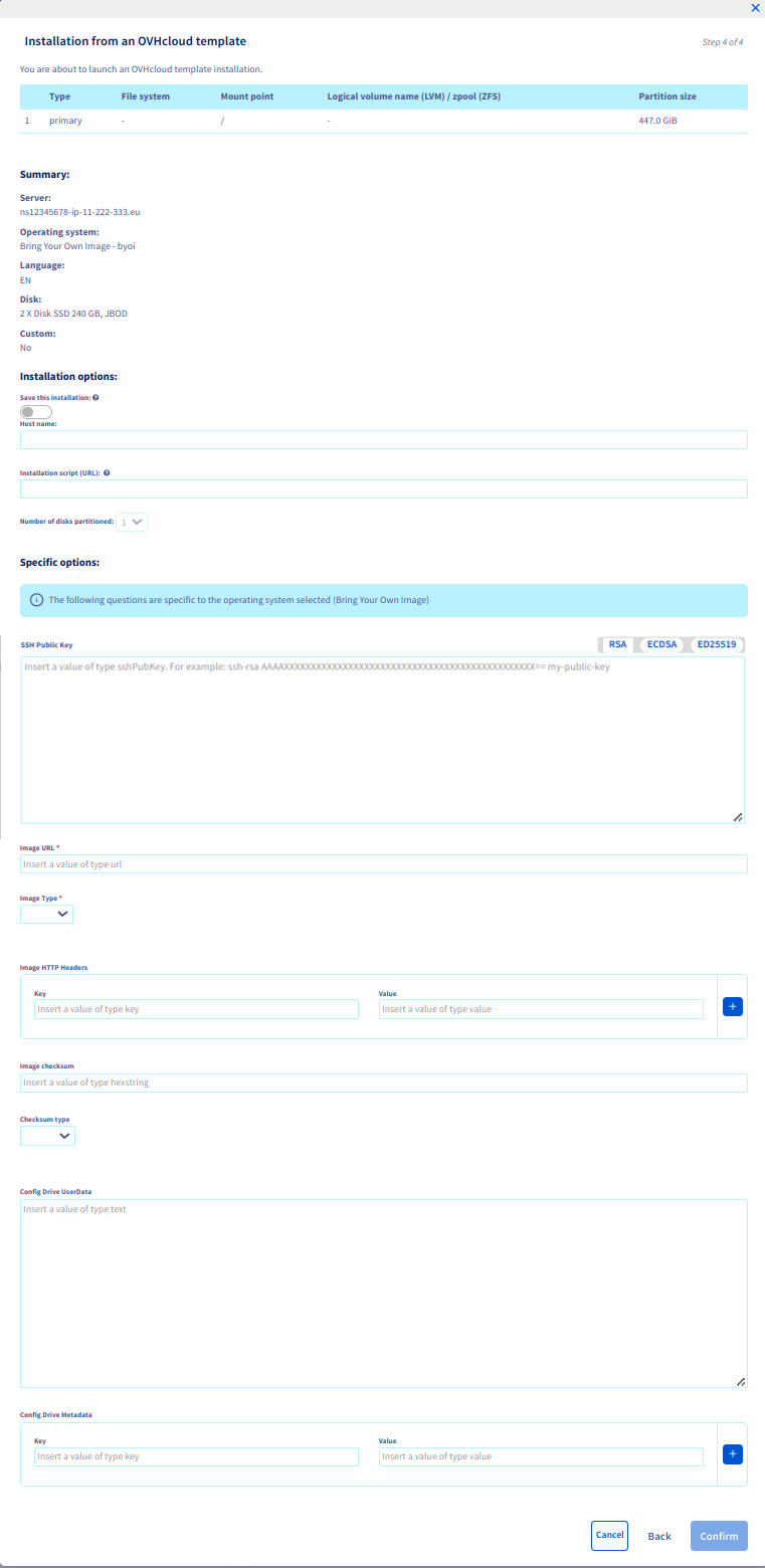

You will be redirected to the configuration page. Make sure your image URL is in the correct format. Fill in the rest of the required fields on this page. Once you have confirmed that the information is correct, click Confirm.
You can find more details on the options in the deployment options section below.
For more information and examples about Cloud-Init's ConfigDrive, please read the official documentation on this page.
