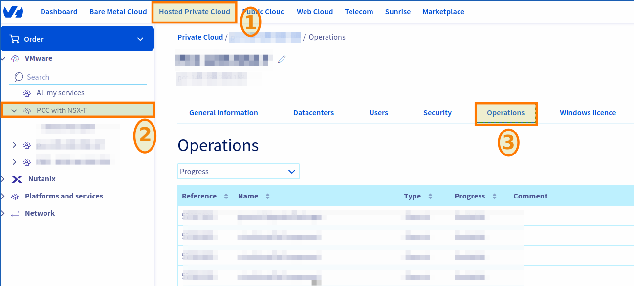

How to access Hosted Private Cloud operations
Log in to your OVHcloud Control Panel with an administrator account, and click on the Hosted Private Cloud tab.
Select your infrastructure under VMware then click on the Operations tab.
Maintenance Operation

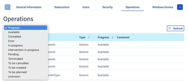

To see the operations in progress or refresh the old operations, use the Refresh button located in the top right-hand corner of the operations table.
You can change the processing date of an operation in progress by clicking on the ... button to the right of an operation, then on Modify the processing date.
For more information on rescheduling a maintenance operation, please read our guide on Rescheduling a maintenance operation on your Hosted Private Cloud.
You can also filter operations by status via the dropdown menu above the table on the left.
Maintenance Operation Filter
