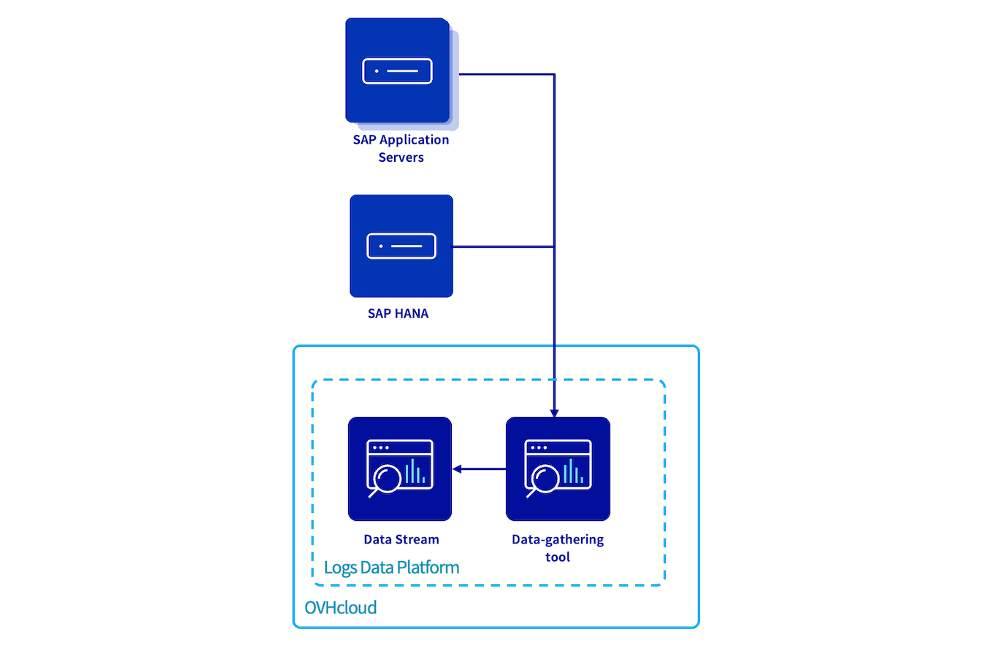

Data-gathering tools
Due to the quantity and diverse type of SAP logs, the deployment of a data-gathering tool to process, format, and structure each type of logs provided by SAP appropriately is essential.
The chapter "Host a logstash collector on Logs Data Platform" of our documentation helps you during the deployment of a data-gathering tool.

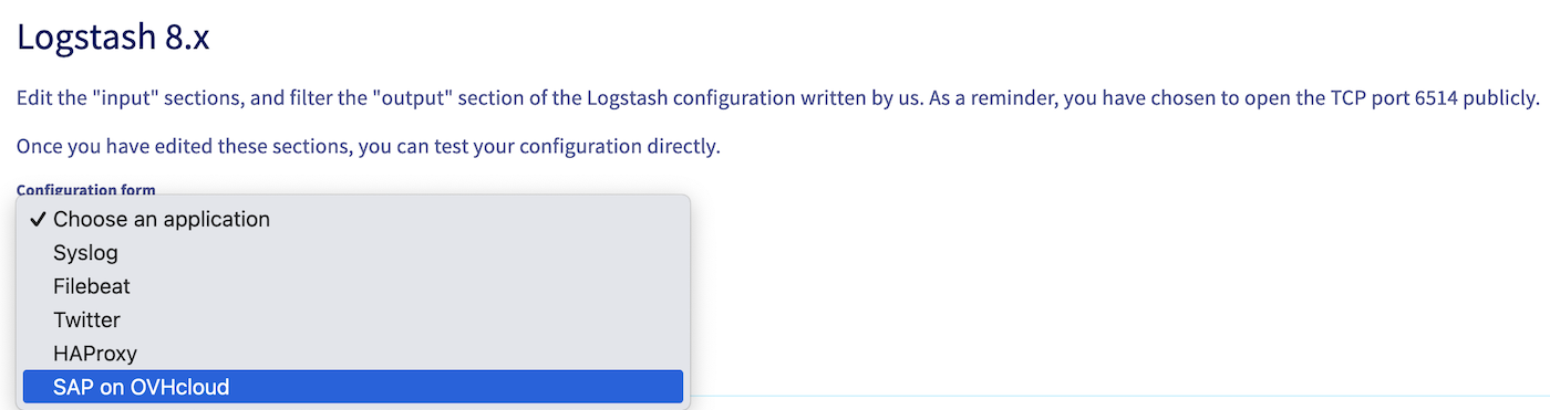

The SAP logs on OVHcloud Logs Data Platform feature provides a Logstash configuration which filters and processes your logs received from a SAP Central Services server, a SAP Application Server, a SAP HANA database, a SAProuter, or a SAP WebDispatcher.
1. Select SAP on OVHcloud in the dropdown list.
sap_on_ovhcloud
2. The Input, Filter and Customized Grok templates sections will be automatically filled. You can as well develop your own filter if you have introduced new logs.
3. Click on Finish the configuration.

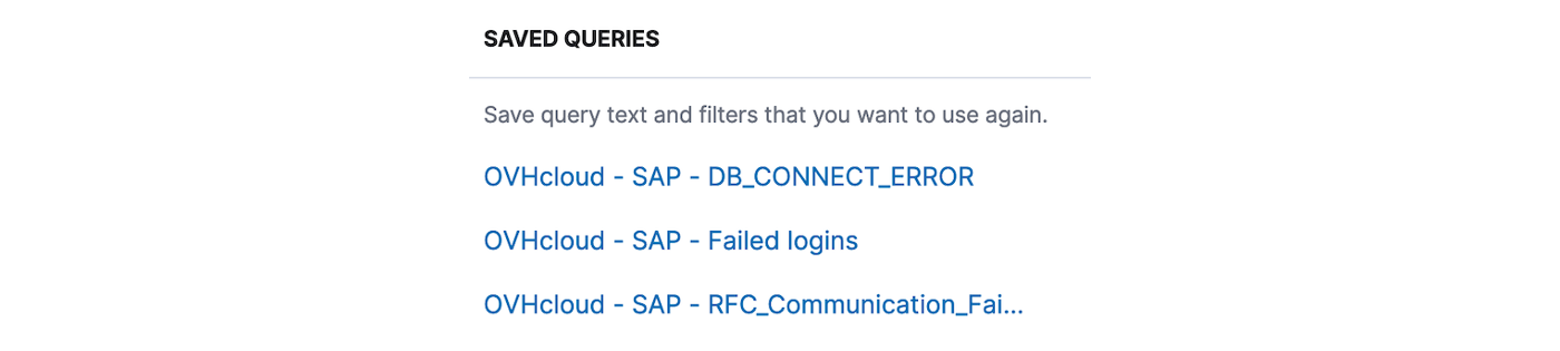

OVHcloud provides a collection of saved queries and dashboards that can be directly accessed on our GitHub repository. These objects can be downloaded and imported in your OpenSearch Dashboards.
In the downloaded files, the keywords <replace-with-your-alias-id> and <replace-with-your-audit-alias-id> must be replaced with the alias ID of your data stream.
In the case of you have only one data stream for your technical logs and your security audit logs, replace both keywords by the same value.
You can find this ID in your OpenSearch Dashboards instance, Stack Management, Index patterns, then select your alias. The ID is displayed in the URL and is composed of alphanumeric characters.
In your OpenSearch Dashboards instance, use the left panel to navigate to Stack Management, then Saved Objects and click on Import to import the file previously downloaded.
By following these steps, you have now many objects available on the Saved Objects page.

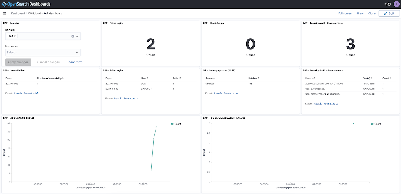

Still in your OpenSearch Dashboards instance, in the main menu, you have now two new dashboards created by OVHcloud. You can also access the saved queries by clicking on the save icon.
queries
Your logs are now sent to the Logs Data Platform and displayed on your data stream via OpenSearch Dashboards.

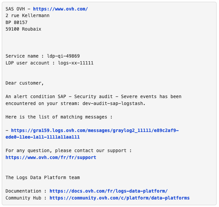

Set up SAP alerts
You can receive email notifications when specific patterns or threshold values are detected in your SAP logs.
You can create an alert with our documentation Configuring a Field Aggregation alert condition.
Upon choosing the appropriate alert type for your requirements, we provide some example of alerts:
Alert conditionNameFieldValueThreshold typeThresholdAggregation typeGrace periodBuild-up of messagesRequest filter
Content fieldSAP - Security audit - Severe eventsSeveritySevere15saplog: security_audit_abap and not Class: Logon and not Details: "Non-encrypted &A communication (&B)"
Number of messagesSAP - DB_CONNECT_ERRORMore than512saplog: dev_w and sap_sid: "" and message: "ERROR-DB-CONNECT_ERROR"
Number of messagesSAP - Short dumpsMore than50110saplog:syslog and message: ("Short dump" and "created")
Content fieldSAP - Failed loginsDetailsLogon failed (reason=&B, type=&A, method=&C)53saplog:security_audit_abap and sap_sid: ""
Content fieldSAP - UnavailibitiesmessageUnavailable11saplog: available
Content fieldSAP HANA - Memory outagesmessageOUT OF MEMORY11saplog: *alert* and hana_sid: ""
Number of messagesSAP HANA - Backup issuesMore than125saplog: backup_tenant or saplog: backup or saplog: backint_tenant or saplog: backint and message: *ERROR* and hana_sid: ""
Number of messagesSAP HANA - Services alertsMore than10210saplog: *alert* and hana_sid: ""
Number of messagesSAP HANA - Modified parametersMore than5520saplog: nameserver and message: "alter system alter configuration"
Number of messagesSAP HANA - Failed loginsMore than315saplog: syslog and program: (HDB_SYSTEMDB or HDB_TENANTDB) and message: "authentication failed"
When a threshold is triggered, you receive an email.
