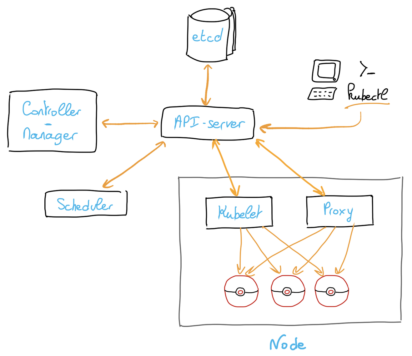

ETCD is one of the major components of a Kubernetes cluster. It's a distributed key-value database that allows to store and replicate cluster state.
Kubernetes components
