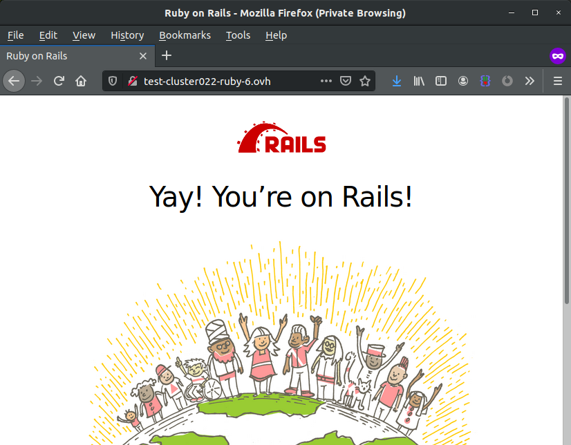

Then restart your instance and your Rails will be online.
Rails

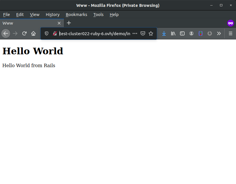

Now let's generate a Hello World with Rails:
export SPRING_SERVER_COMMAND="$HOME/www/bin/spring server"
rails generate controller demo index
Create the template app/views/demo/index.html.erb:
vim app/views/demo/index.html.erb
&lt;h1>Hello World&lt;/h1>
&lt;p>Hello World from Rails&lt;/p>
Build the Hello World:
./bin/webpack
After another restart, your Hello World will be available in https://yourdomain.ovh/demo/index.html.
