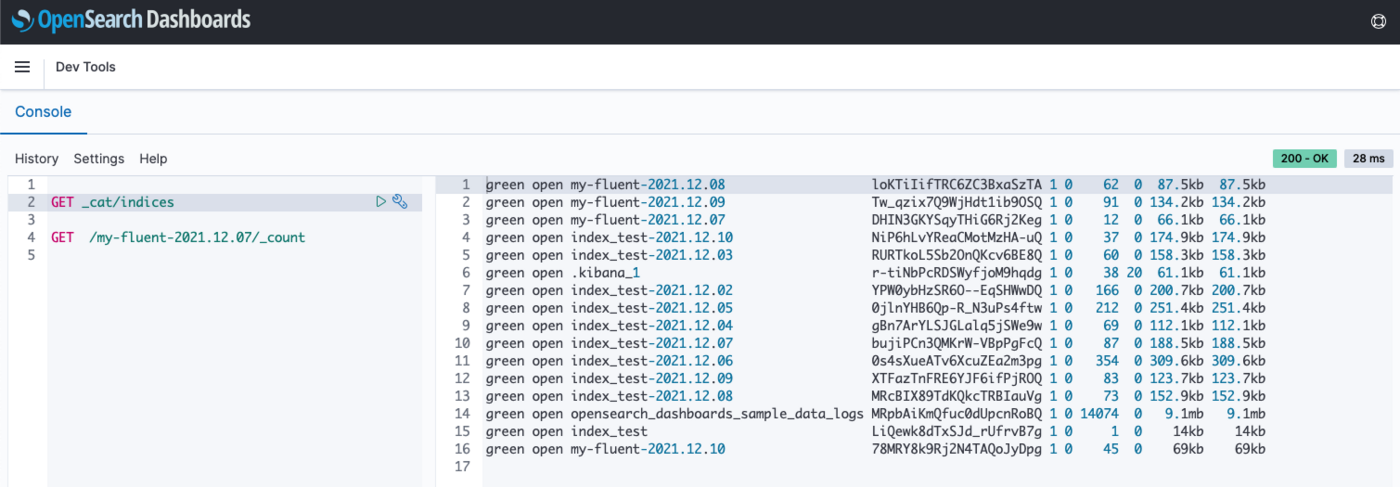

Now that we have Logstash running and parsing the Apache access log file, let's do a different connection to the Apache service and validate that Logstash is forwarding all access data to OpenSearch. Let's also connect to the OpenSearch Dashboard to check that the corresponding index has been created and that some first documents have been populated.

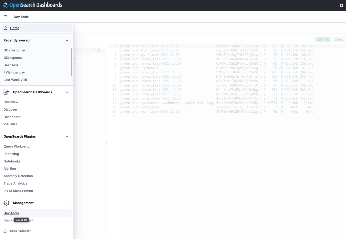

Use the Dev Tools to query the indices:
Dev Tools in OpenSearch Dashboard
Then, in the console, execute a GET /_cat/indices command to get the index list with the number of documents for each:
GET the index list and number of docs

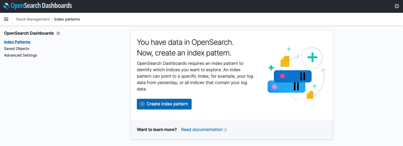

Create an index pattern
To aggregate all corresponding daily indices, we have to create an index pattern from the Stack Management menu:
Stack Management
To create the first index pattern:
First index pattern

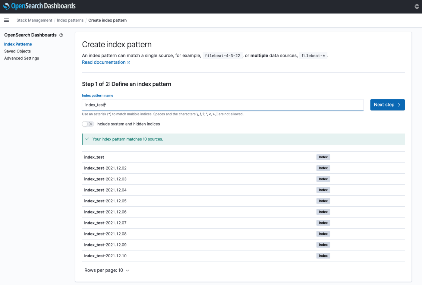

As we want to consolidate all our daily indices, let define the pattern as index_test:
Index_test pattern

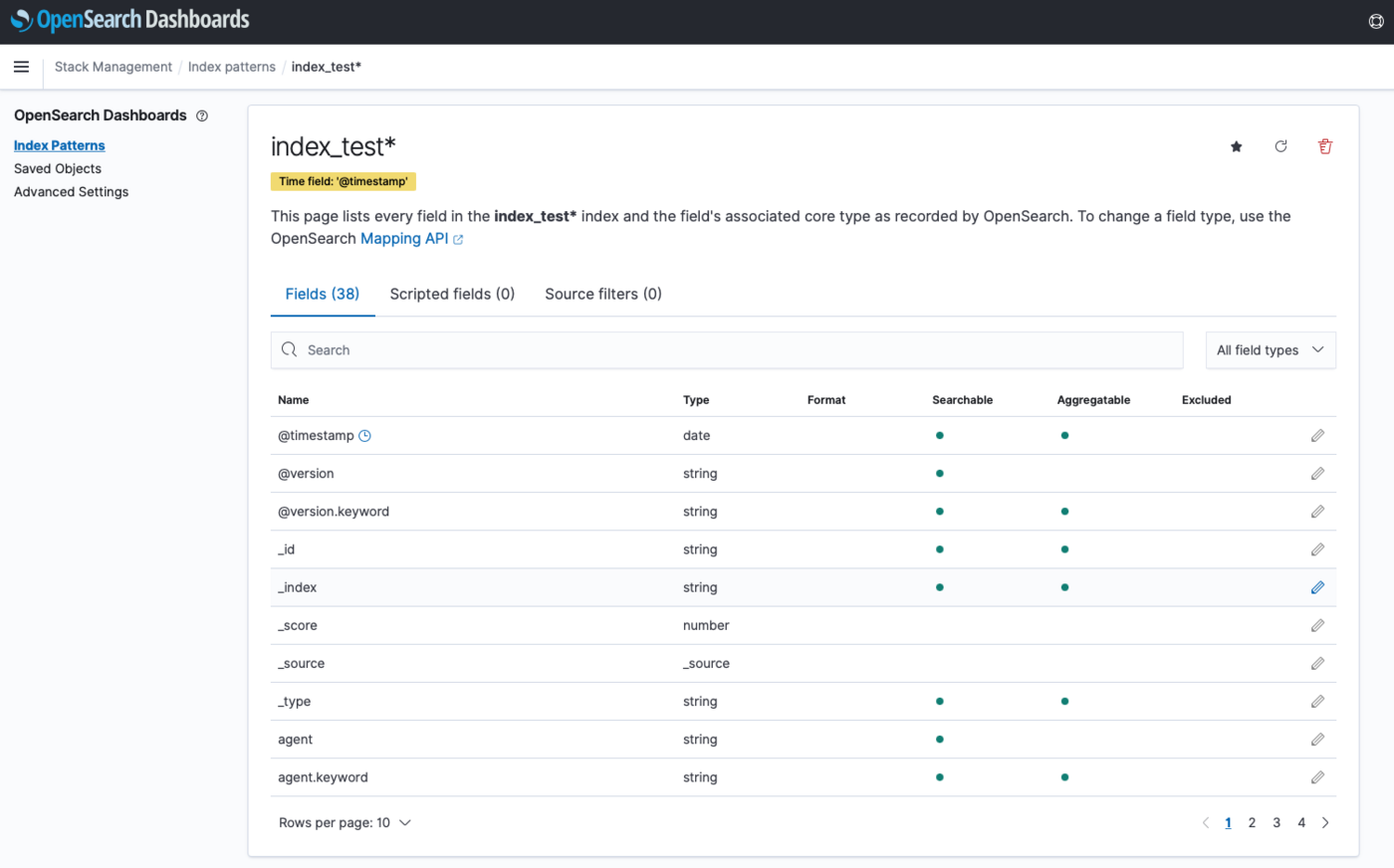

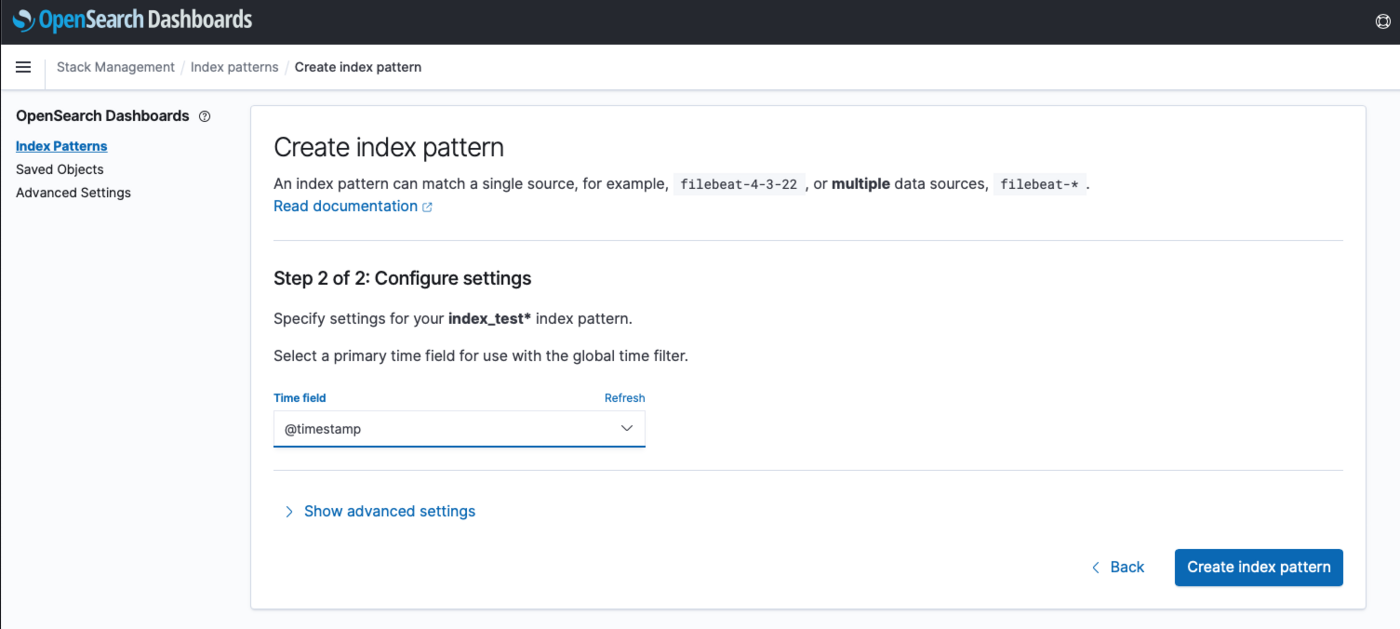

Then define the timestamp:
index_test timestamp
OpenSearch will then define all fields available and their type directly from stored documents in the index:
index_test ready

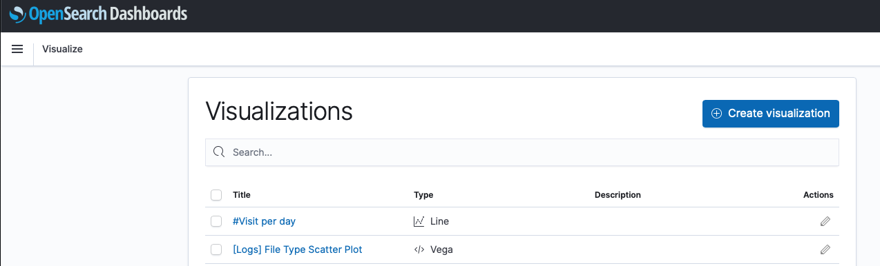

Create a new visualization
In the OpenSearch Dashboard / Visualize, create a new visualization:
index_test ready

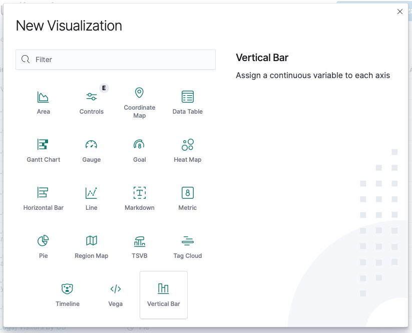

Select the visualization type:
index_test ready

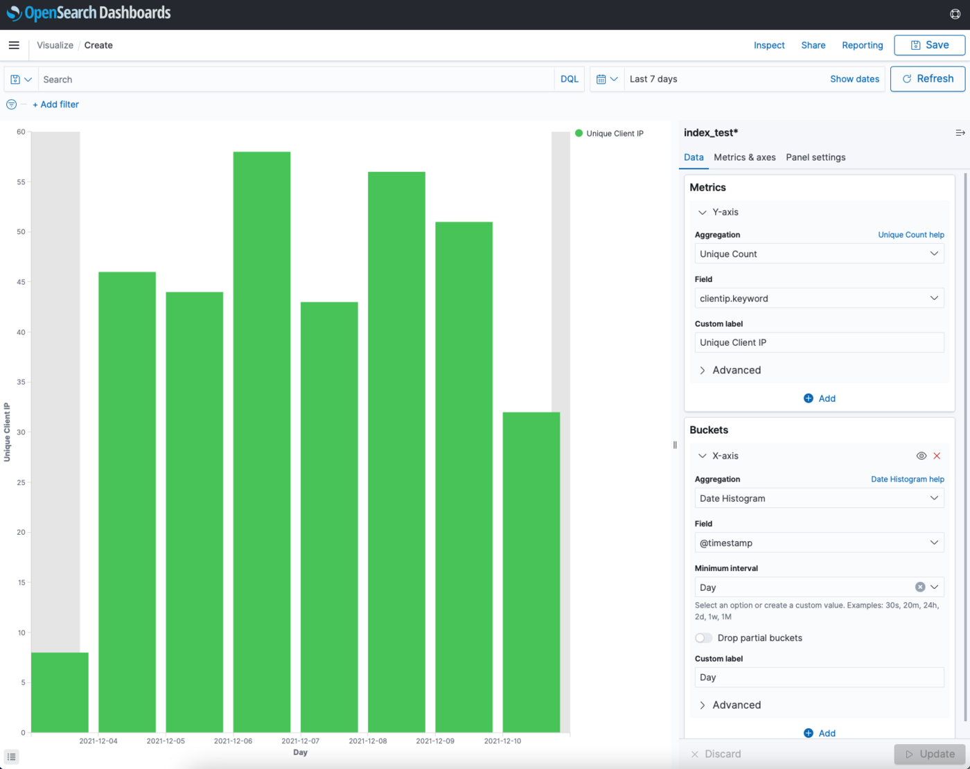

You now have to define all criteria that you need to visualize:
  • the period (last 7 days in our example);
  • for the metrics, the Y-axis data (aggregation/field);
  • and same for Buckets with time interval in case of date aggregation.
Click on update if there are any changes in the data definition, or refresh if you change the data time scale.
index_test ready

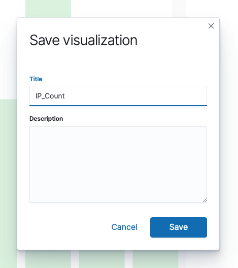

Save your visualization:
Save visualization

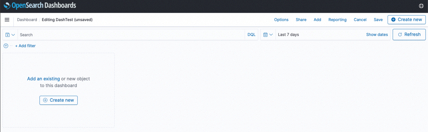

Let's make a dashboard with the visualization you've just saved.
Create a new dashboard :

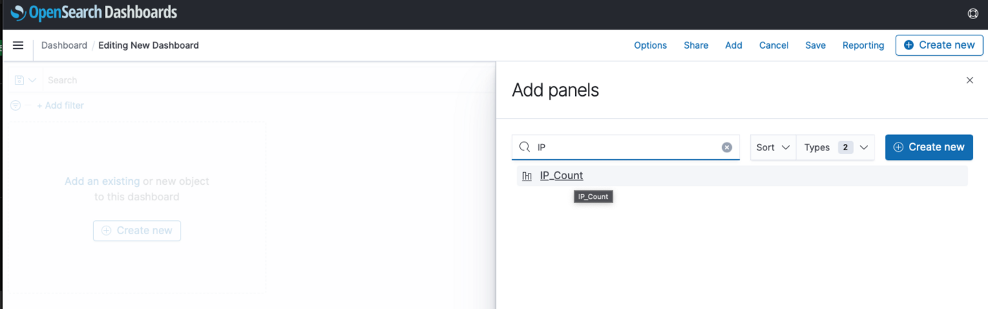

As we have already created a visualization, Add an existing object:
Search and select the one we just created:
Reuse the created visualization

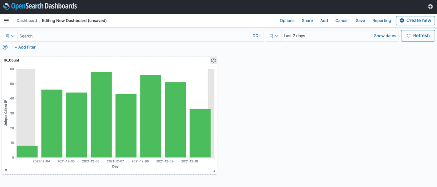

Reorganize your panels, add new or existing ones as wanted:
Dashboard saved
We now have a real time dashboard showing us the unique IP address per day, found in Apache logs.
