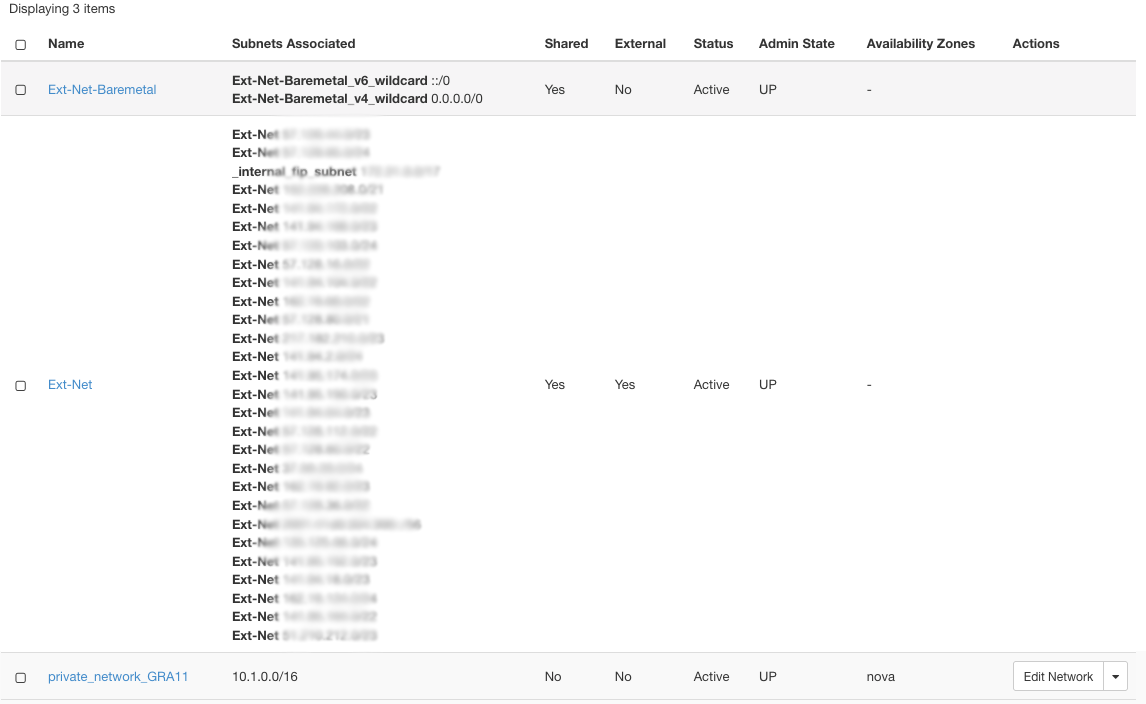

Click on Project > Network > Networks. The page will display the list of networks available which contain an OVHcloud managed network for public connectivity (Ext-Net) as well as your network.
network list

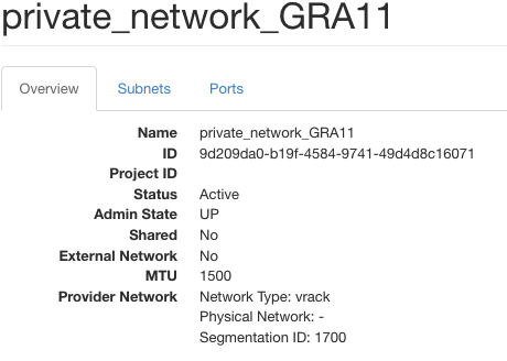

In that list, click on your network name ("private_network_GRA11" in this example). The network detail page is then displayed.
network details

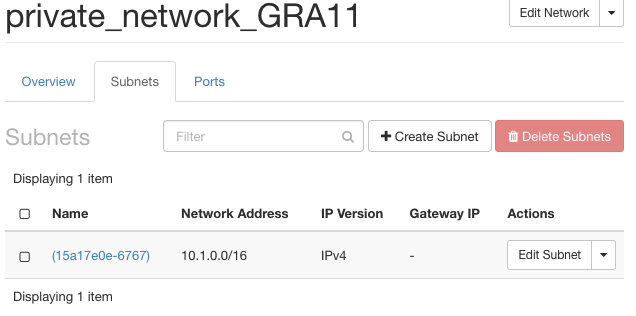

Click the Subnets tab: the subnets from the private network are listed.
subnets list

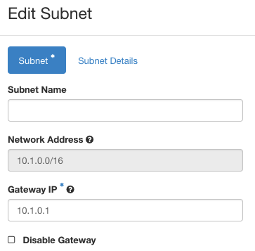

Click on your Edit Subnet. For this guide, our target is to add a gateway IP:
  • Click untick the Disable Gateway. The field Gateway IP will appear. Fill it in with an IP within your CIDR (usually the first IP of the range is used). In our case, 10.1.0.1.
gateway IP

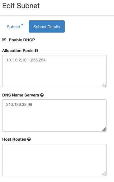

  • Click on Subnet Details. Update the Allocation Pools to remove the gateway IP that you entered in the previous step. In our case, we need to update from 10.1.0.1,10.1.255.254 to 10.1.0.2,10.1.255.254
subnet details
Click on Save and your subnet is updated with a gateway IP !
