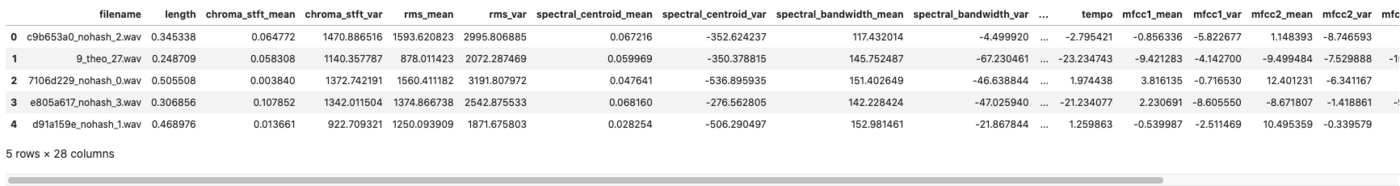

Audio to csv file with features extraction
The first Python file is called data-processing-audio-files-csv.py. It allows to transform all the sounds into Librosa parameters and to make a csv file.
Refer to the comments of the code for more information.
The head of the csv file:

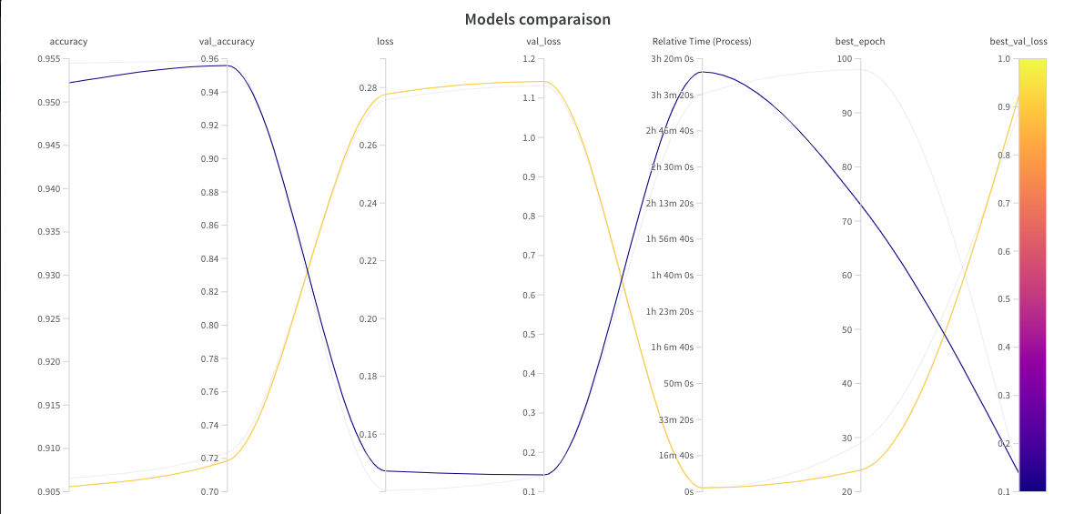

You can now compare your models with Weights & Biases.

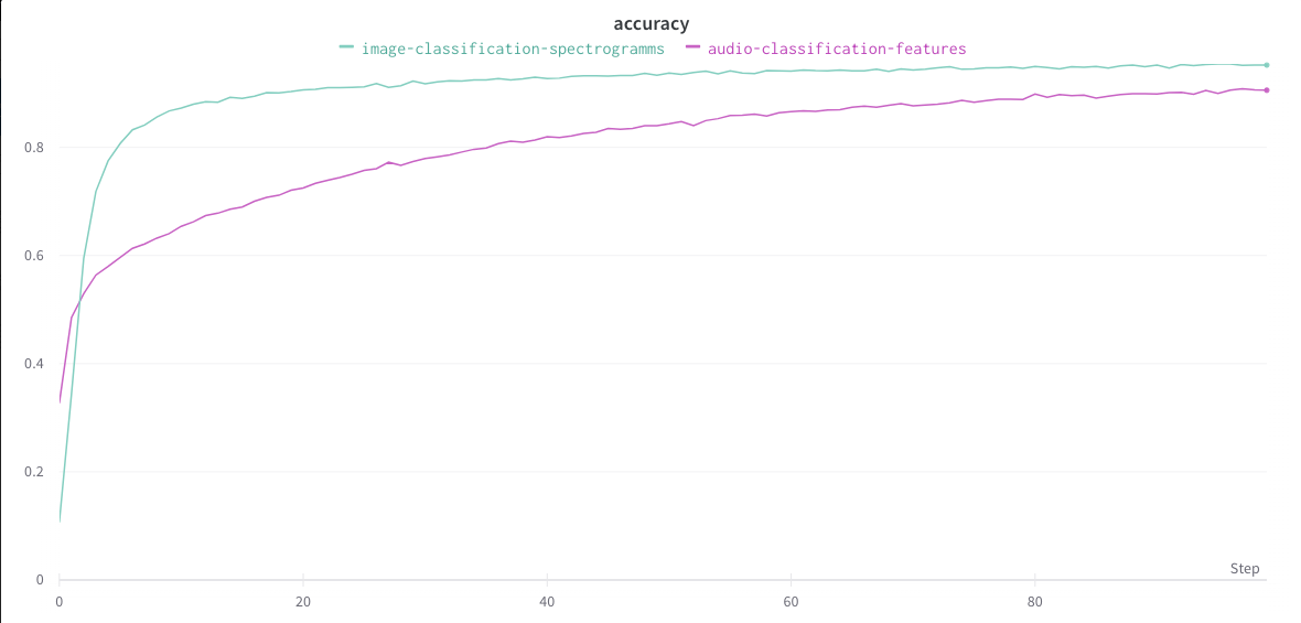

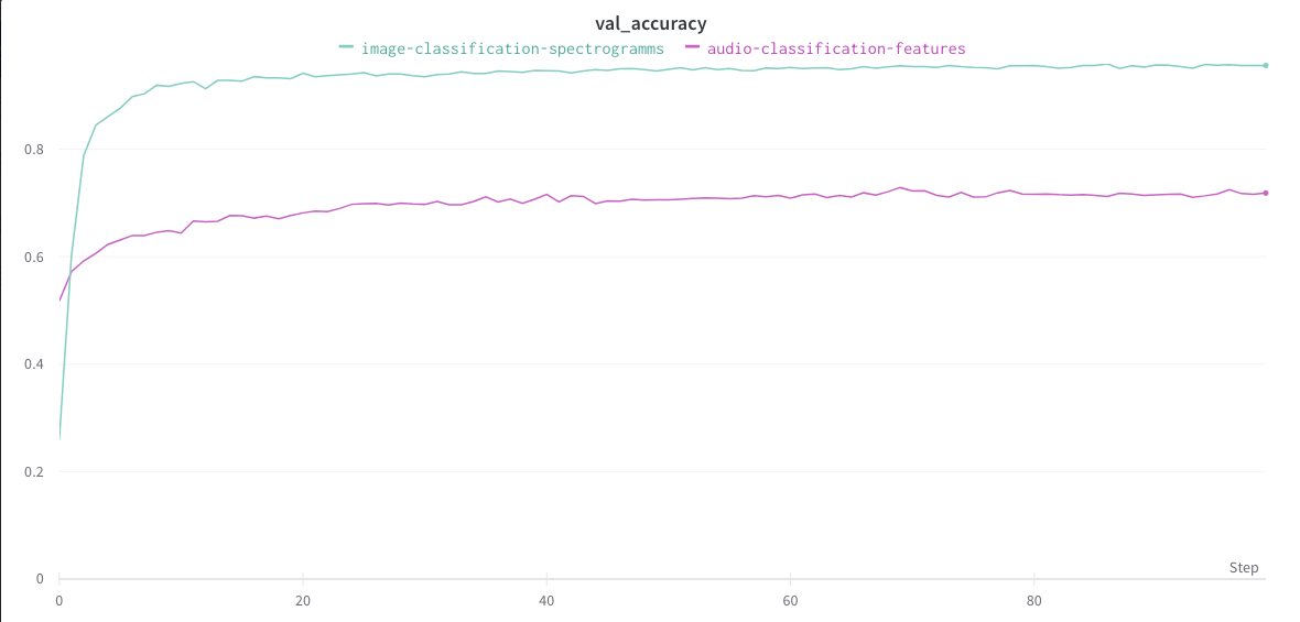

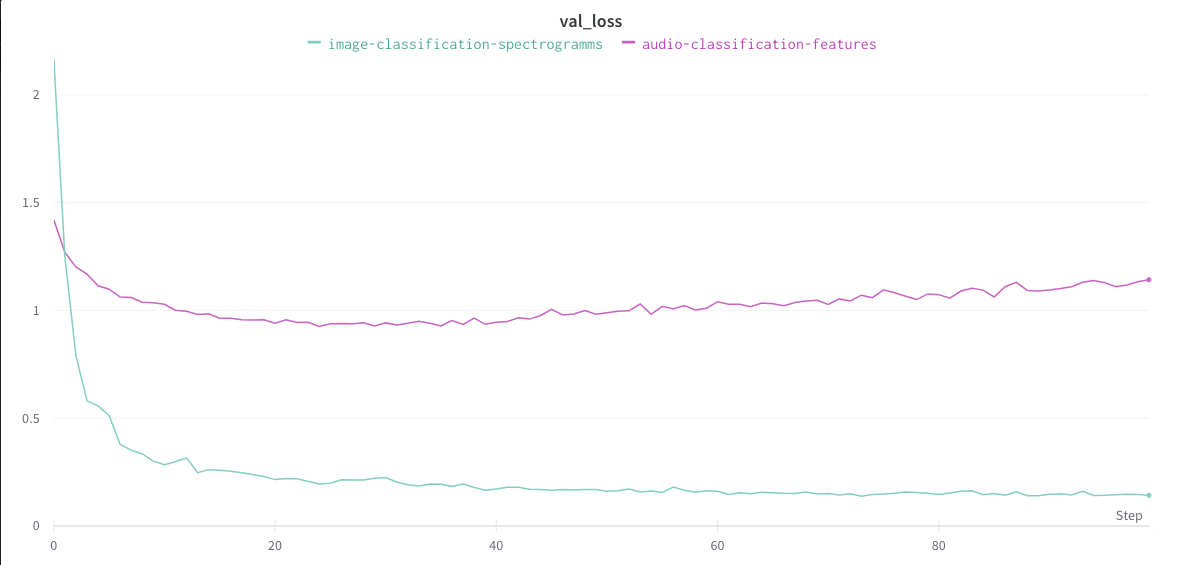

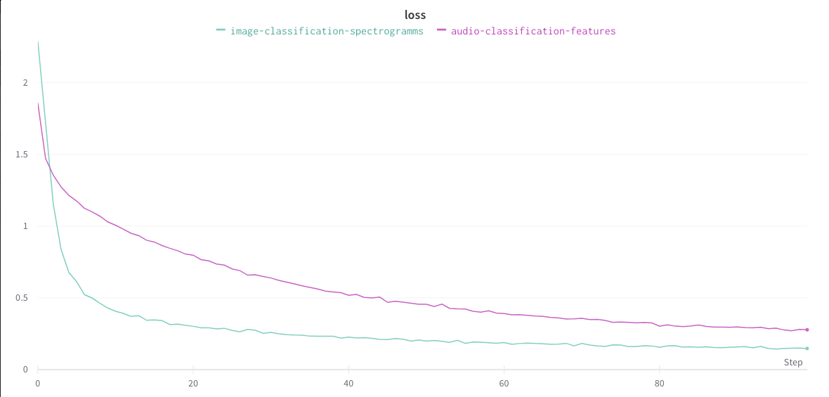

Compare with Weights & Biases
You will be able to check your models training once your jobs are in running status. Run the following command:
ovhai job get <job-id>
Once the jobs are in running status, you can check the logs to obtain the Weight & Biases link. Run the command:
ovhai job logs <job-id>
Now, you can access the Weights & Biases panel. You will be able to check the accuracy and the loss values for the training and the validation sets.
  • Training data:
Accuracy:
Loss:
  • Validation data:
Accuracy:
Loss:

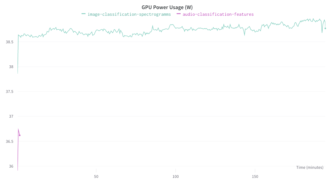

You can then observe which model is better in terms of speed, accuracy or resource consumption...
In this case, we see that the model classifying the spectrograms is better in terms of accuracy and loss on the validation set.
However, it takes longer to train and consumes more computing resources.
