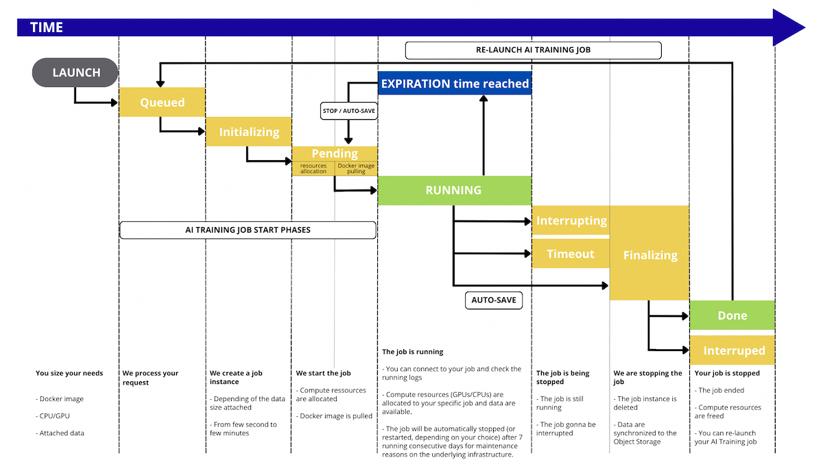

AI Training job lifecycle
By default, your AI Training job will automatically shut down after 7 consecutive days of being in a RUNNING state. You can also enable Automatic Restart to have it restart every 7 days, or contact our support to extend this period to 28 days.
During its lifetime, the AI Training job will go through the following statuses:
  • QUEUED: The job run request is about to be processed.
  • INITIALIZING: The job instance is created and the data is synchronized from the Object Storage. To know more about the data synchronisation check out the Data - Concept and best practices section.
  • PENDING: First, the system allocates the necessary compute resources (CPU/GPU) for the job. Then, the specified Docker image is pulled for use in the job.
  • RUNNING: The job is running, you can connect to it. Compute resources (GPUs/CPUs) are allocated to your specific job and data are available.
  • INTERRUPTING: The job is still running but an interruption order was received and is about to be processed.
  • FINALIZING: The job instance is deleted and the data is synchronized back to the Object Storage.
  • DONE: The job ended normally.
  • TIMEOUT: The job is still running but is about to be interrupted because the timeout was reached.
  • INTERRUPTED: The job is ended and was interrupted.
  • FAILED: The job ended with an error, e.g. the process in the job finished with a non 0 exit code, Docker image could not be pulled. For more information, refer to this section of our Troubleshooting documentation.
  • ERROR: The job ended due to a backend error. You may contact our support.
lifecycle

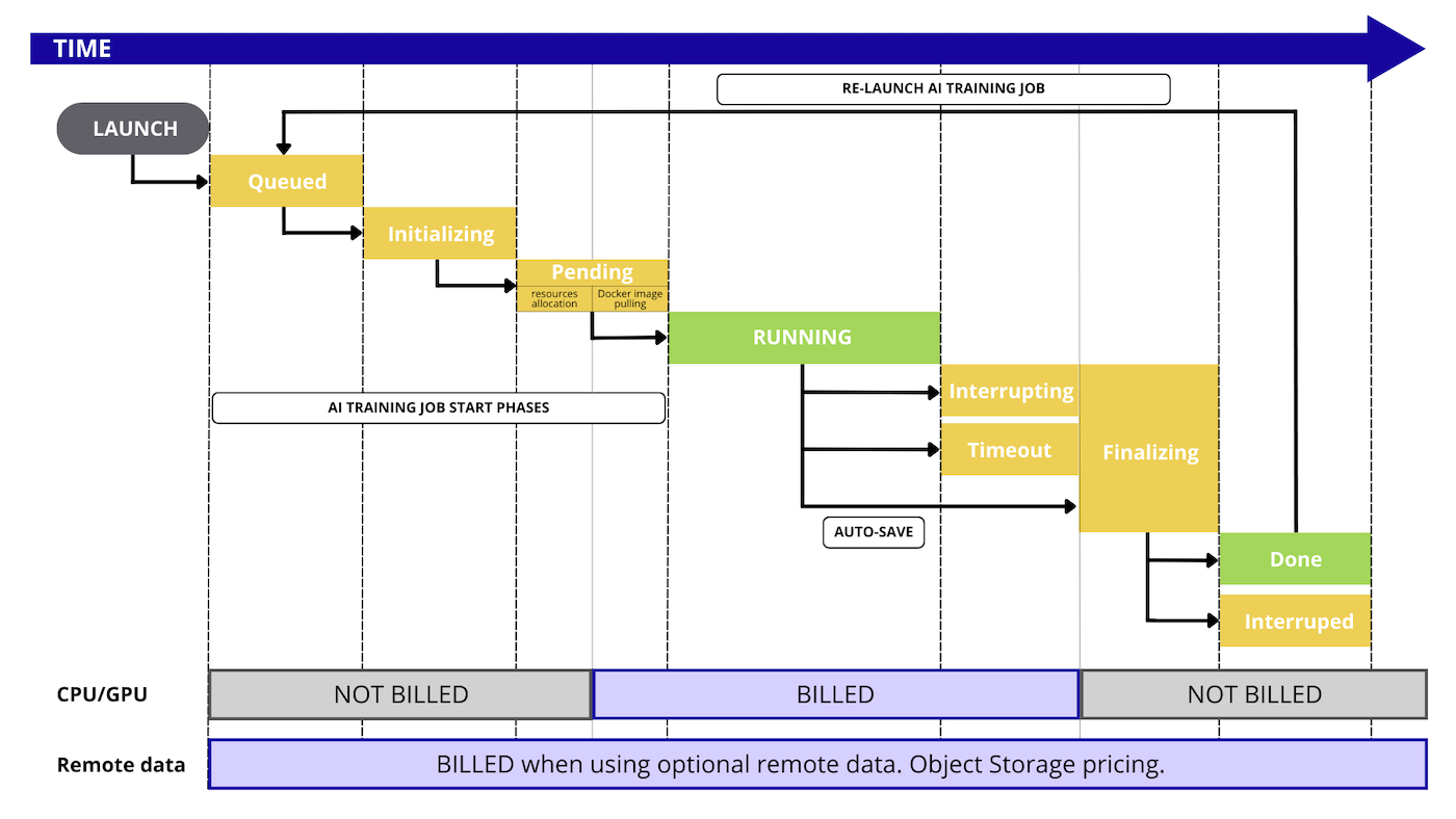

Billing principles
AI Training is a pay-per-use solution. You only pay for the resources consumption, during the PENDING and RUNNING phase of your jobs.
Billing principle is quite simple, you select the amount of compute resource (CPUs or GPUs) you would like to work with and pay only for this.
Included in AI Training resources:
  • AI Training managed service
  • Dedicated CPU/GPU compute resources (based on the selected amount)
  • Ephemeral local storage (size depends on the selected compute resources)
  • Ingress/Egress network traffic
Optional with AI Training:
  • Remote storage space, based on OVHcloud Object Storage pricing
  • Egress traffic for remote Object storage
Here is a detailed graph that illustrates every step that is billed or not during the AI Training workflow:
billing
