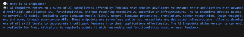

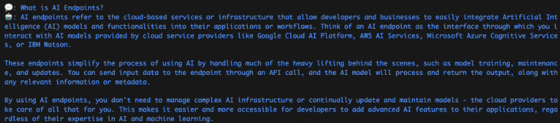

Note that the chatbot will use the streaming mode, as explained in the Memory Chatbot with LangChain4j tutorial.
Test the chatbot without knowledge base
As you can see below, the LLM gives an answer, but not the expected one.
chatbot-without-rag
This is not a surprise, since the model was trained before OVHcloud created AI Endpoints. The model does not know this platform.
That is why we are going to create a knowledge base, to improve the LLM's answers.

    _LOG.info("\n💬: What is AI Endpoints?\n");
    TokenStream tokenStream = assistant.chat("Can you explain me what is AI Endpoints?");
    _LOG.info("🤖: ");
    tokenStream
        .onNext(_LOG::info)
        .onError(Throwable::printStackTrace)
        .start();
Thanks to your knowledge base, our new chatbot will answer with relevant information from your custom data source.
