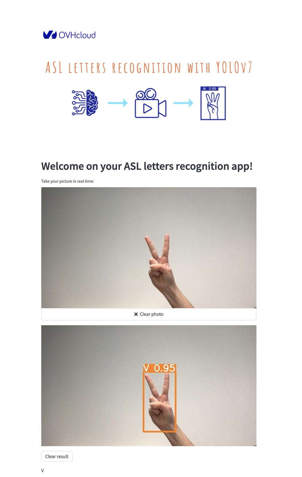

Here is an overview of the Sign Language recognition app:
Overview

Define the main and start your app:
if __name__ == '__main__':
    st.image("/workspace/head-asl-yolov7-app.png")
    st.write("## Welcome on your ASL letters recognition app!")
    model = load_model()
    img_file_buffer = st.camera_input("Take your picture in real time:")
    result_list = analyse_image(img_file_buffer, model)
    path_file = display_letters(result_list)
    if st.button("Clear result"):
        if os.path.isfile(path_file):
            os.remove(path_file)
            print("File has been deleted")
        else:
            print("File does not exist")
    if (os.path.exists(path_file)==True):
        with open(path_file, "r") as f:
            content = f.read()
            st.write(content)
            f.close()
    else:
        pass
