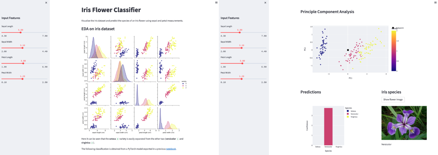

The objective of this tutorial is to deploy an application for Exploratory Data Analysis (EDA) and interactive prediction.
The use case is the IRIS dataset. It is a collection of data containing information on 50 observations of four different variables: petal length, petal width, sepal length and sepal width.
Overview
The first objective is to perform data mining on the source data from the Iris dataset.
Then, the goal is to make predictions using a trained model. We will therefore use a neural network and weights from this notebook to classify iris flowers between different species (Setosa, Versicolor and Virginica). The four features are sent as input to the neural network.
The PyTorch model will be loaded and run, and the prediction probabilities for each class will be extracted. Depending on the input data, it will be possible to visualize the corresponding iris on a PCA plot to compare the input to other data points in our Iris dataset.
In order to do this, you will use Streamlit, a Python framework that turns scripts into a shareable web application. You will also learn how to build and use a custom Docker image for a Streamlit application.

Create the Streamlit application
Two Python files are created for the purpose of loading the PyTorch model and building the Streamlit app.

Write the app.py file
Load the IRIS dataset for EDA.

Display EDA figure based on source dataset.

Create a sidebar with sliders.

Run a PCA.

Create a function that filters out negative values from the dataframe. Only positive values in the dataframe are kept. If a value is negative, it is set to zero.

Define a Python function to display image according to Iris species.

All the functions defined above are called in the main Python file app.py to build the Streamlit app. You can find this part of the code as well as the different functions defined previously on the GitHub repository.
