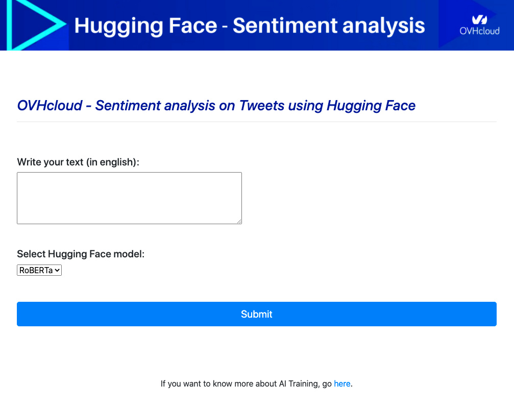

The purpose of this tutorial is to show you how to deploy a web service for sentiment analysis on text using Hugging Face pretrained models.
In order to do this, you will use Flask, an open-source micro framework for web development in Python. You will also learn how to build and use a custom Docker image for a Flask application.
Overview of the app:
