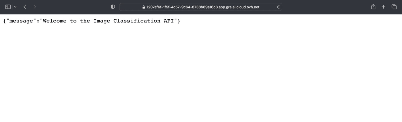

Define the GET method:
@app.get('/')
def root():
    return {'message': 'Welcome to the Image Classification API'}

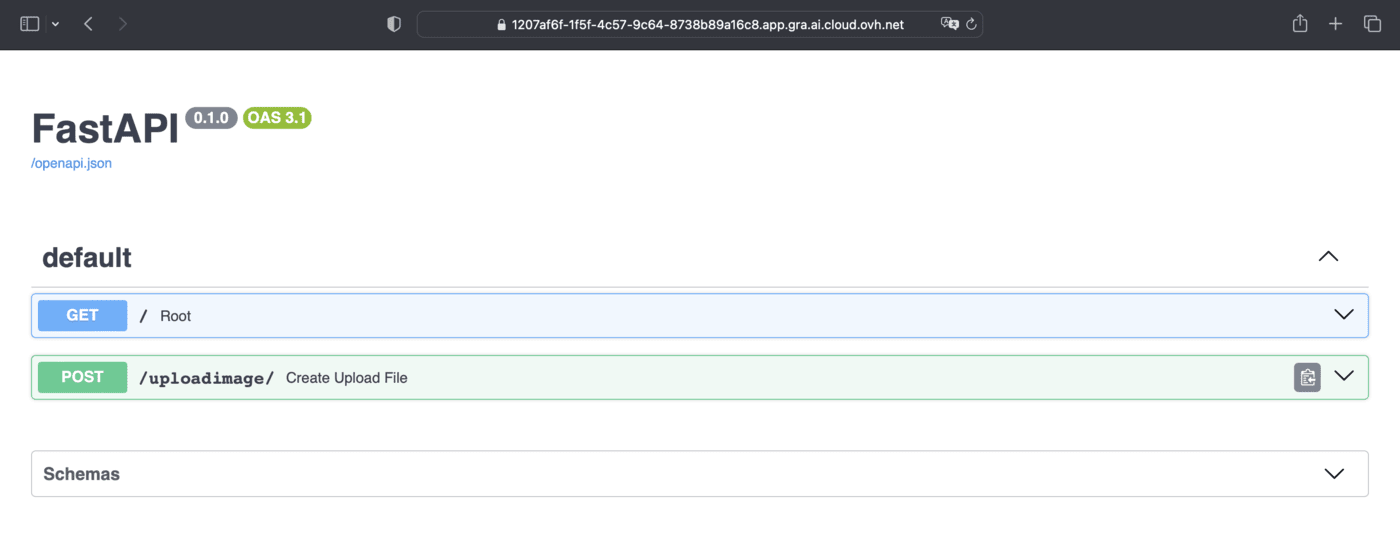

You can add /docs at the end of the URL of your app.
In our example, the URL is as follows: https://1207af6f-1f5f-4c57-9c64-8738b89a16c8.app.gra.ai.cloud.ovh.net/docs
It provides a complete dashboard for interacting with the API!
APIDocs

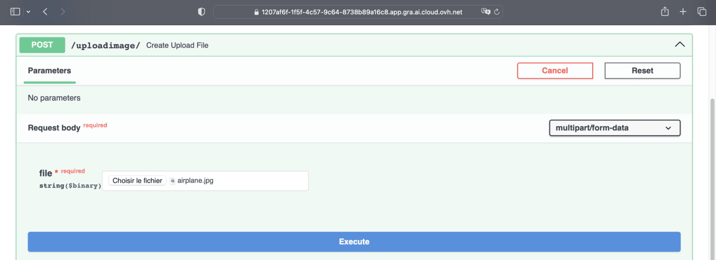

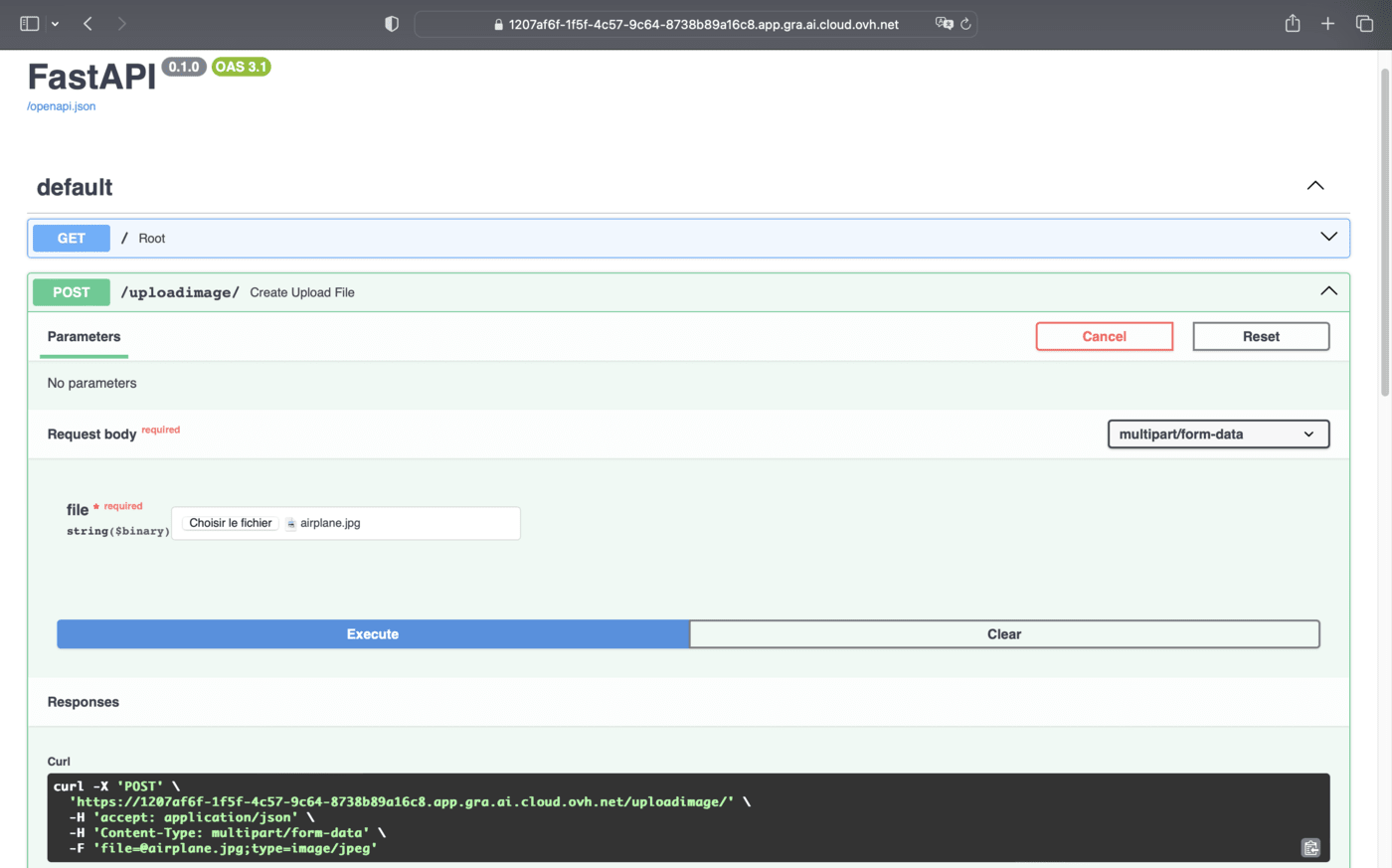

To be able to send an image for classification, select /uploadimage/ in the green box. Click on Try it out and add the image of your choice in the dedicated zone.
APIImage

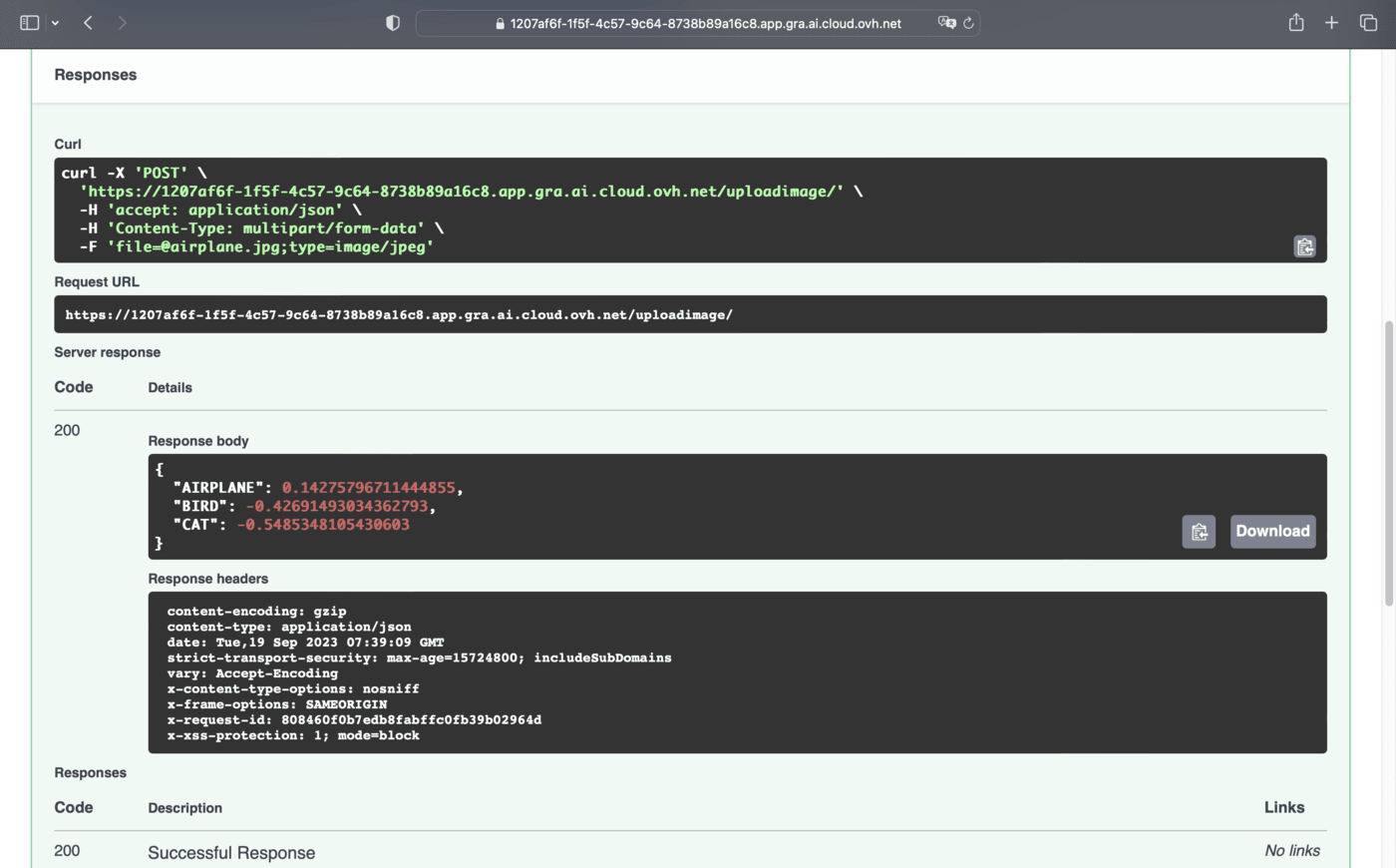

To get the result of the prediction, click on the Execute button.
APIPrediction
Congratulations! You have obtained the results of the prediction with the labels and the confidence scores.
