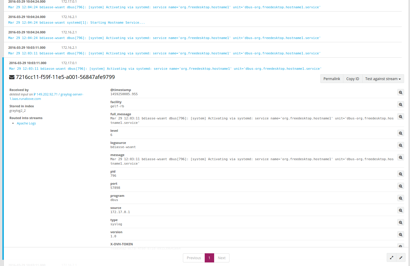

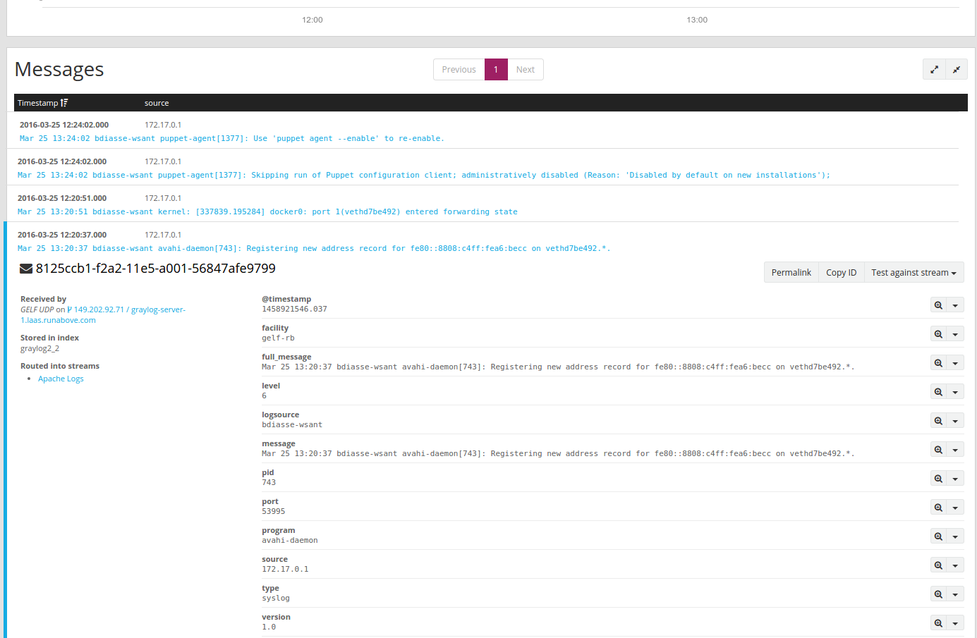

You will have the following result in your stream in Graylog:
local_logstash_graylog
So, let's suppose you have a lot of hosts and you want to send all your syslog outputs to Logstash. One way to do it is to put one Logstash on one of your machines and send all the logs to this hosts. This will work but what happens if your hosts go down? Or is not fast enough? Or if it isn't compatible with Java? Don't worry, the best thing about the Logs Data Platform is that we can host your Logstash for you. We also allow you to configure the input and the filter as you wish and you can even define custom Groks. The next section will tell you how to do it!

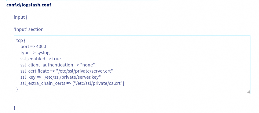

If we take the configuration example above and if we enable the SSL encryption, we have the following configuration for the Input Section:
 tcp {
     port => 4000
     type => syslog
     ssl_enabled => true
     ssl_client_authentication => "none"
     ssl_certificate => "/etc/ssl/private/server.crt"
     ssl_key => "/etc/ssl/private/server.key"
     ssl_extra_chain_certs => ["/etc/ssl/private/ca.crt"]
logstash_creation
As you can see, this is roughly the same configuration that before. The SSL configuration needs 5 extra parameters:
  • ssl_enabled: that allows to enable SSL. Must be set to true.
  • ssl_client_authentication: this deactivates the client certificate verification process that needs a trusted certificate on client side.
  • ssl_certificate: the location of the auto-generated server certificate.
  • ssl_key: the location of the associated key.
  • ssl_extra_chain_certs: the array contains the path to the CA certificate.

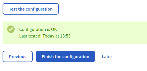

To validate the settings, you will have to click on Test the configuration button. After some fancy calculations you should see on the screen a green confirmation.
logstash_testing
You can then click on Finish the configuration button to save your configuration!

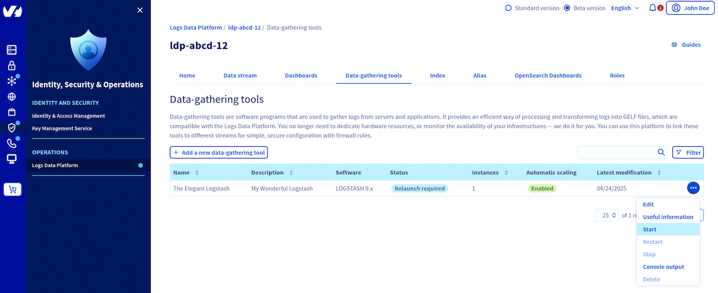

Starting the input
Starting the input is done by using the Start Button in the ... menu at the right of your input. Click on it to deploy your collector on Logs Data Platform.
input_start

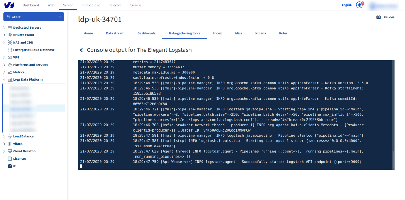

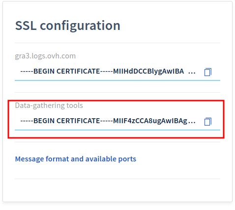

Collector useful information
Once your collector is started, you can copy several pieces of information to your clipboard.
  • The hostname
  • The public IP
  • The SSL Certificate
The hostname is in the following form:
<your_cluster>-XXXXXXXXXXXXXXXXXXXXXXX.<your_cluster>.logs.ovh.com
This is an address of your collector for the cluster on Logs Data Platform. Send your logs to your address to have them processed by your collector. Use for example the previous syslog Lines to test your collectors. If you head to Graylog, you will find your Logs in the attached Stream just as before.

SSL CA certificate
The CA certificate you can use to verify the authority presented by our hosted collectors can be copied from the homepage of the Logs Data Platform manager.
input_ca
Console output
Last but not least, if you have concerns about the way your logstash is handling your logs, you may be interested to follow the messages coming from your collector. To do this, please go to the dedicated page by clicking on the Console output button.
input_console
