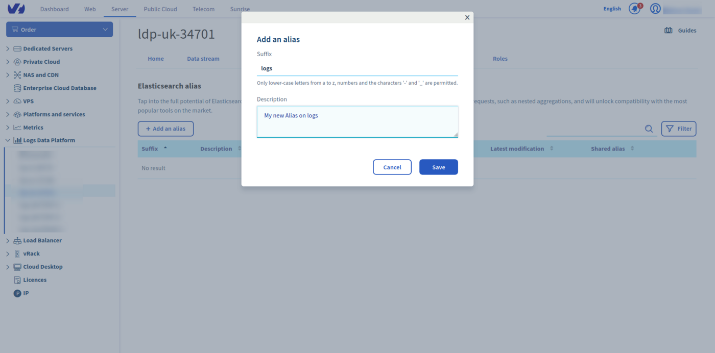

In order to deploy ElastAlert, it is important that you have data for which you can see alerts. If you only have Graylog stream, you can use aliases to enable the OpenSearch API on your stream data. Here is how:
  1. In the Alias tab, click the Add an alias button.
  2. Choose a name and define a description for your alias.
  3. Save the entry by clicking the Save button.
  4. Once the alias has been created. Use the ... menu on the right side and select the Attach content to the alias option.
  5. Define there the data streams you want to associate to your alias.
  6. That's it.
Alias creation
