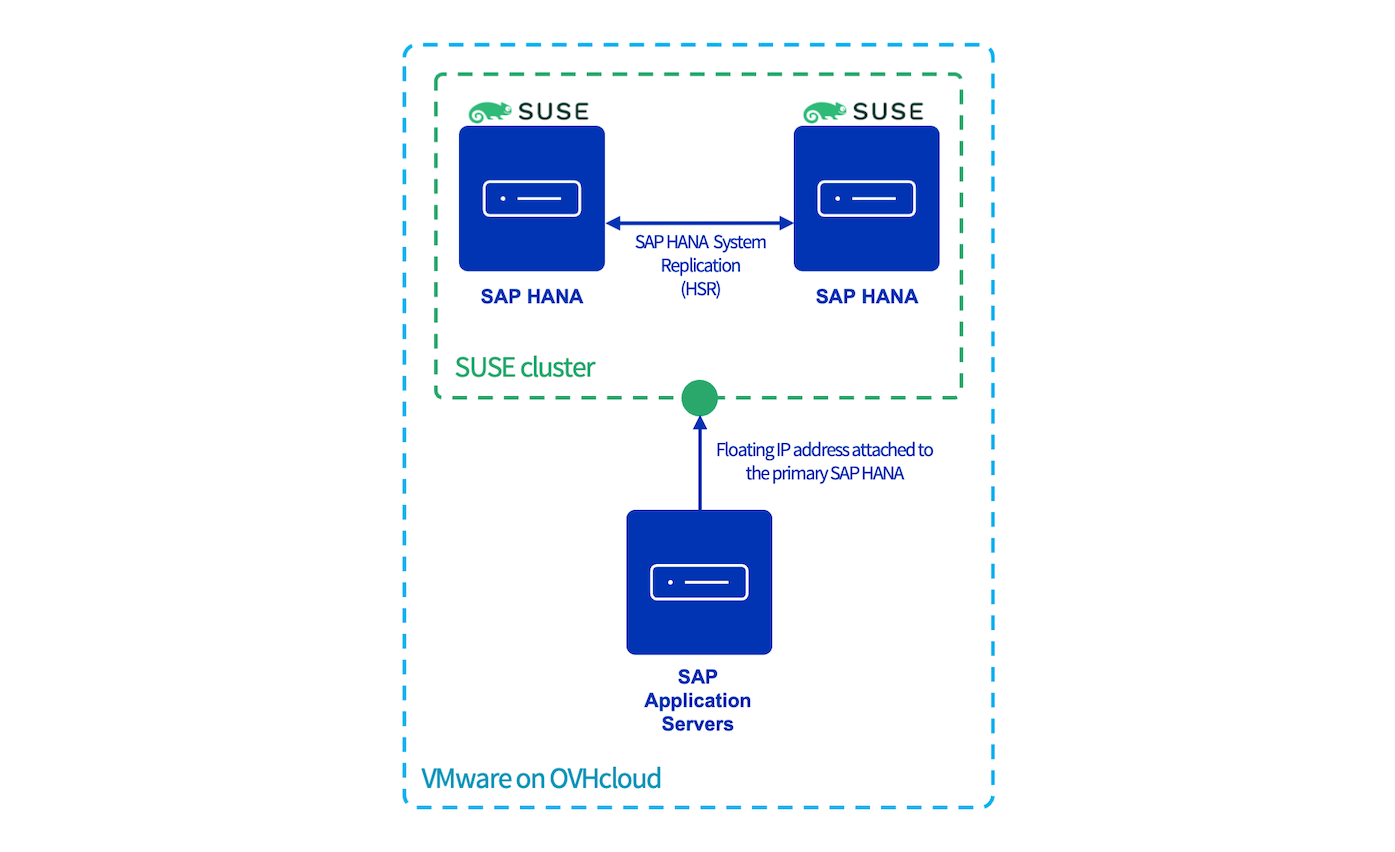

This guide provides instructions for configuring a SAP HANA cluster with SLES using the services Corosync and Pacemaker.
This implementation reduces the Recovery Time Objective (RTO), in case of a virtual machine or ESXi host outage in the same OVHcloud location.
schema
