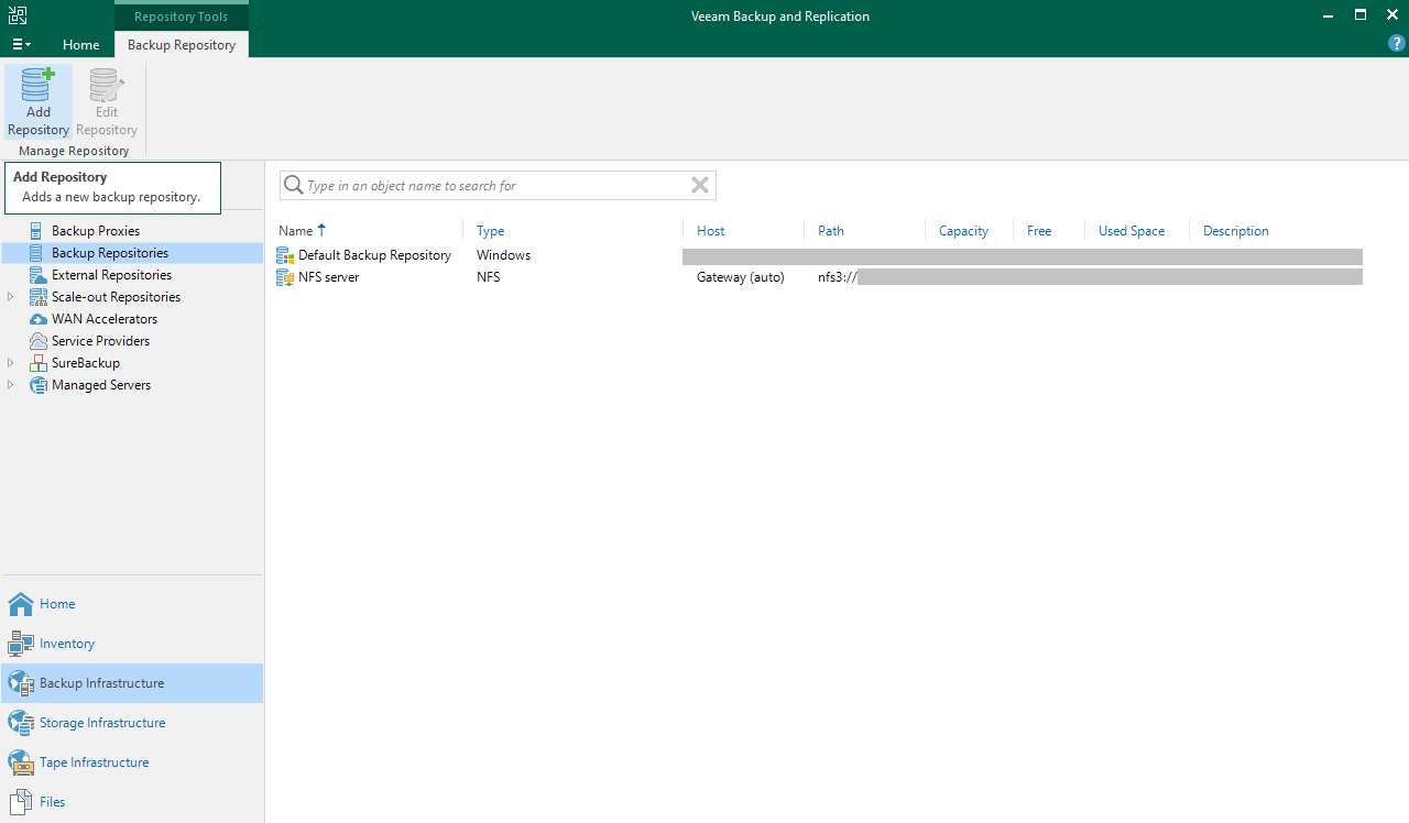

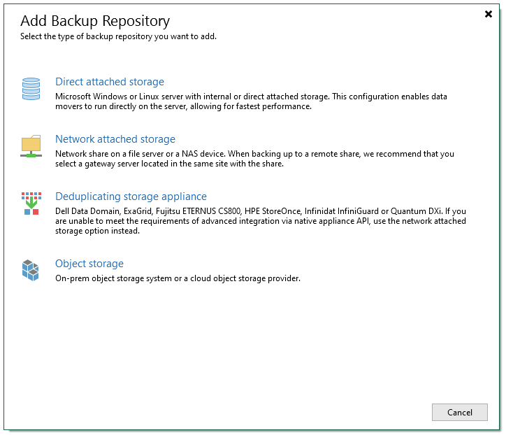

Open the Veeam Backup and Replication console, select Backup Infrastructure, then Backup Repositories.
Click on Add Repository to start the configuration assistant.
backup_repository_1
Select Direct attached storage or Network attached storage, depending on your situation.
  • Direct attached storage allows you to add a physical or virtual server as storage without NFS or SMB protocols.
  • Network attached storage allows you to add a file share via NFS or SMB (CIFS) protocols.

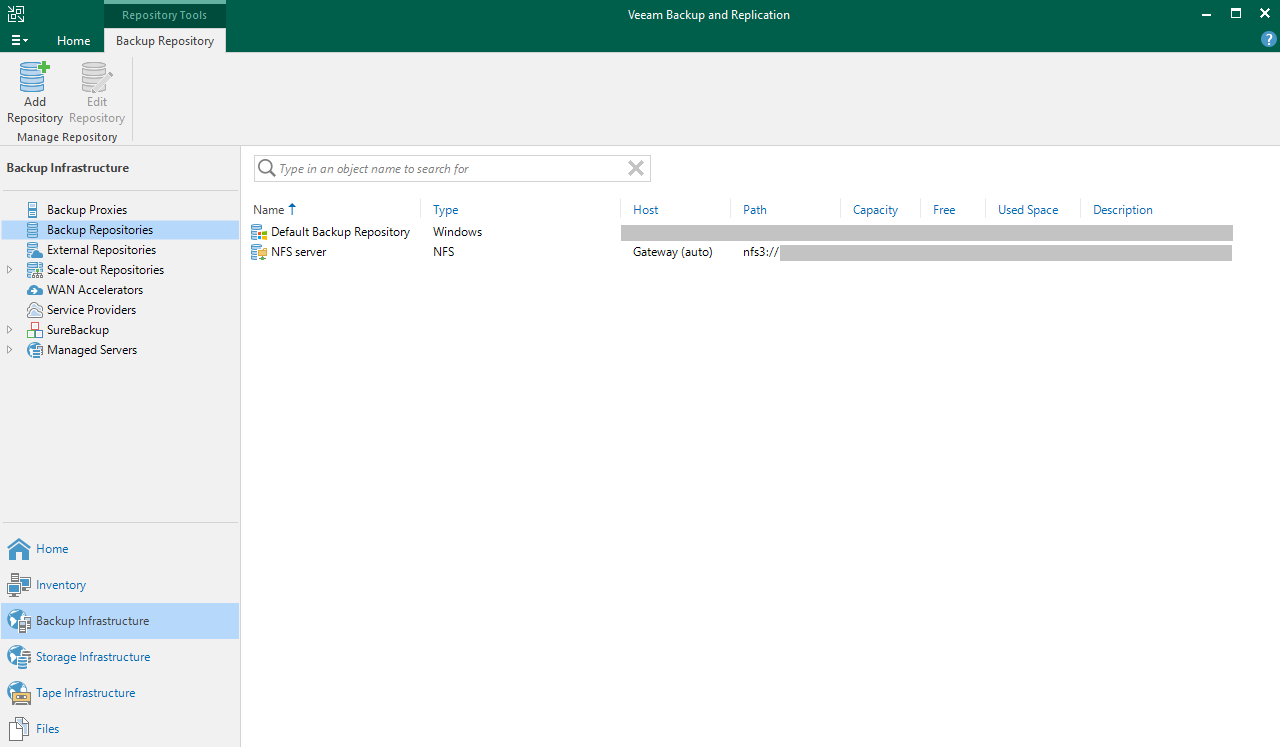

Your Backup Repository is now visible in the Veeam Backup and Replication console and ready to use with backup configurations.
You can go further in configuring this Backup Repository by setting access permissions for a specific user or a group of users, and by encrypting the backups that will be hosted in this Backup Repository. Find more information on this in the Veeam Backup and Replication 12 User Guide.

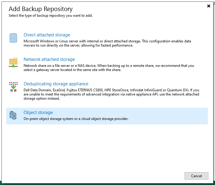

Click Add Repository to start the configuration assistant.
backup_repository_s3_1

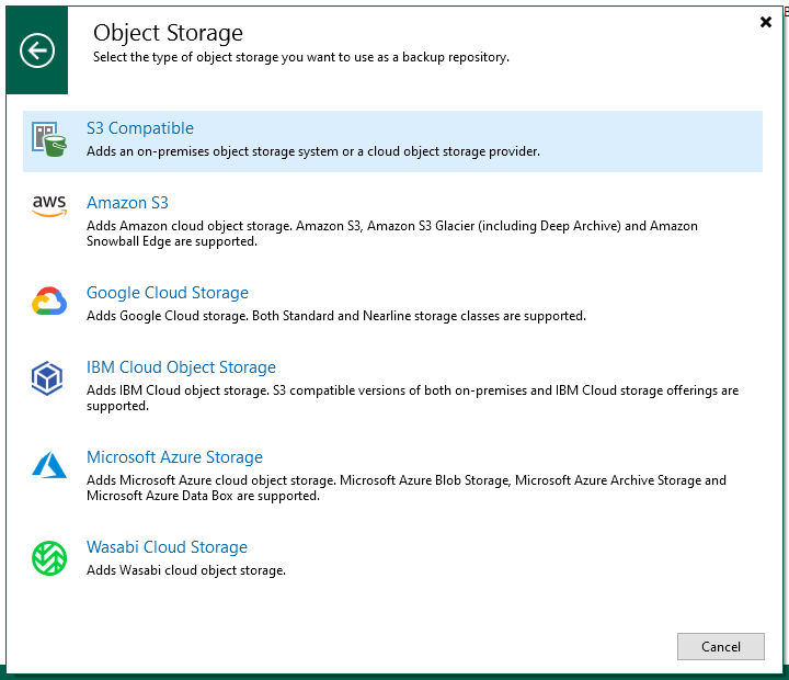

Select Object storage.
backup_repository_s3_2
Select S3 Compatible.

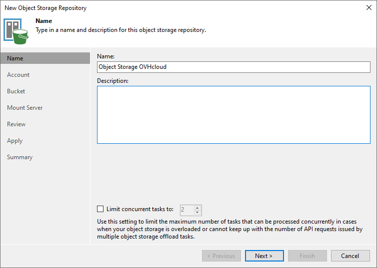

Give a name to your Object Storage Repository.

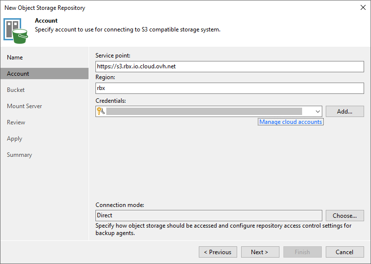

Enter the Service point which corresponds to the Object Storage endpoint, as well as the region (in lowercase) of your Object Storage.
Add the credentials of the Object Storage user who has the Administrator role on this Object Storage. This includes the access key and the secret key of the Object Storage user associated with the Object Storage. Find more information about the Object Storage user in this guide.

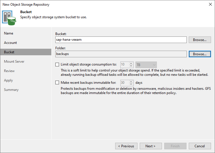

Indicate the name of the Object Storage bucket where you want to store your SAP HANA backups.
You must also indicate or create a directory in this Object Storage bucket.
backup_repository_s3_6

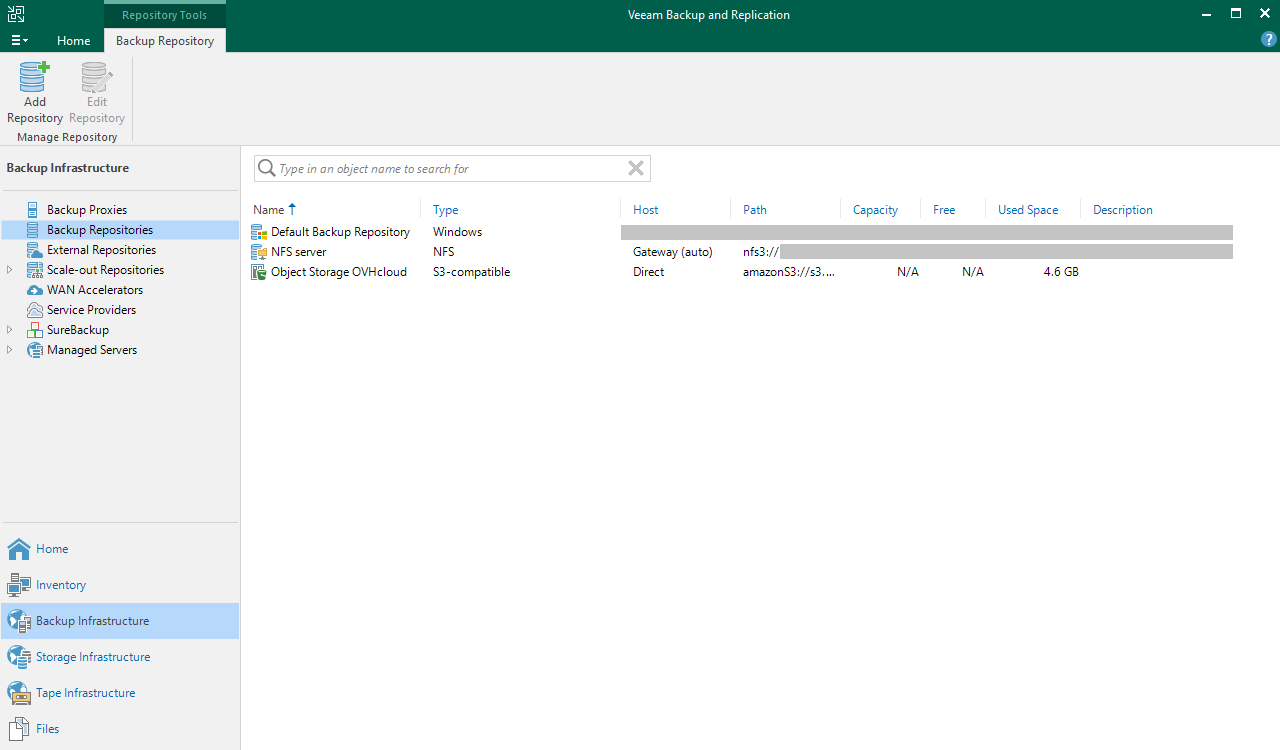

Your S3-compatible Backup Repository is now visible in the Veeam Backup and Replication console and can be used by backup configurations.
backup_repository_s3_7

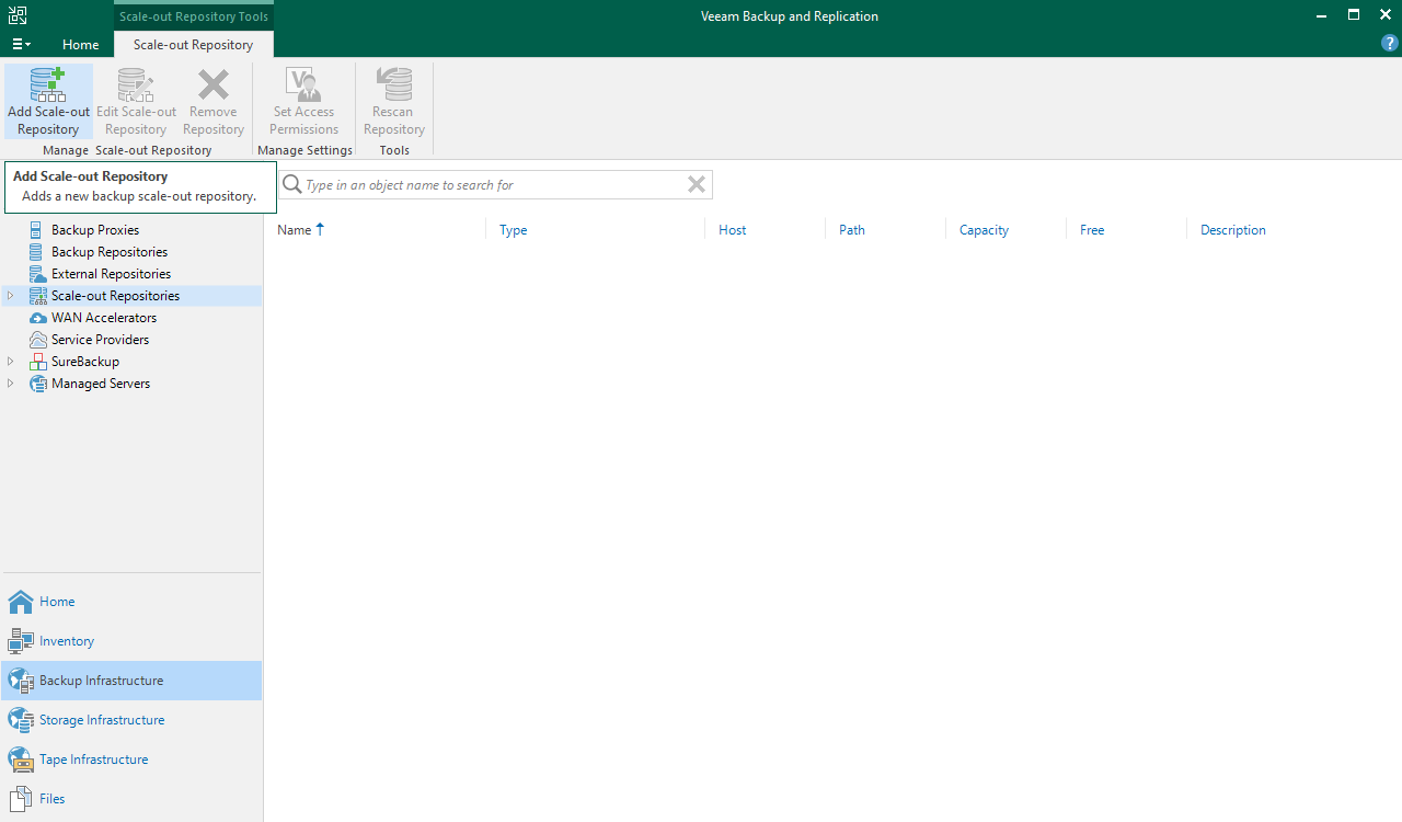

Open the Veeam Backup and Replication console, select Backup Infrastructure, then Scale-out Repositories.
Click Add Scale-out Repository to start the configuration assistant.

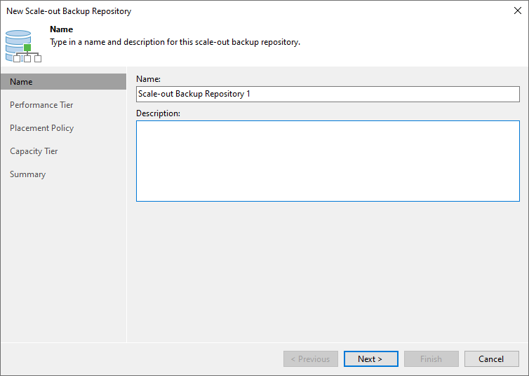

Give a name to your Scale-out Backup Repository.

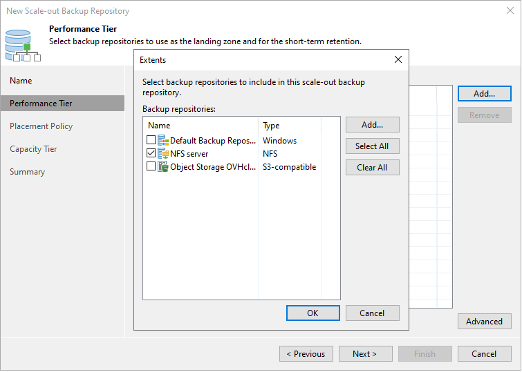

Click Add and select your previously created Backup Repository.
sbr_no_snc_3

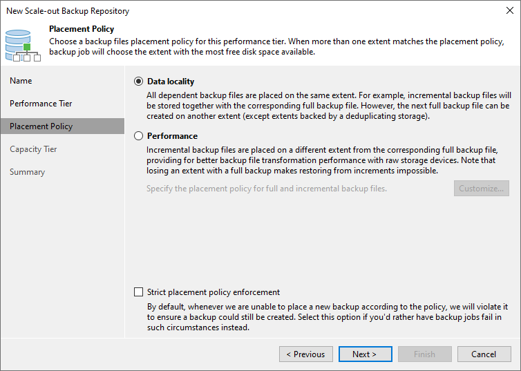

Select the desired location policy. We recommend the Data locality policy.
sbr_no_snc_4

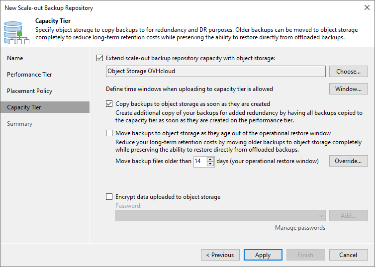

Check Extend scale-out backup repository capacity with object storage, then select the previously created Backup Repository Object Storage.
Check the Copy backups to object storage as soon as they are created option to replicate the backups from the first Backup Repository to the second Backup Repository immediately after their creation. This configuration provides quick protection for your backups.

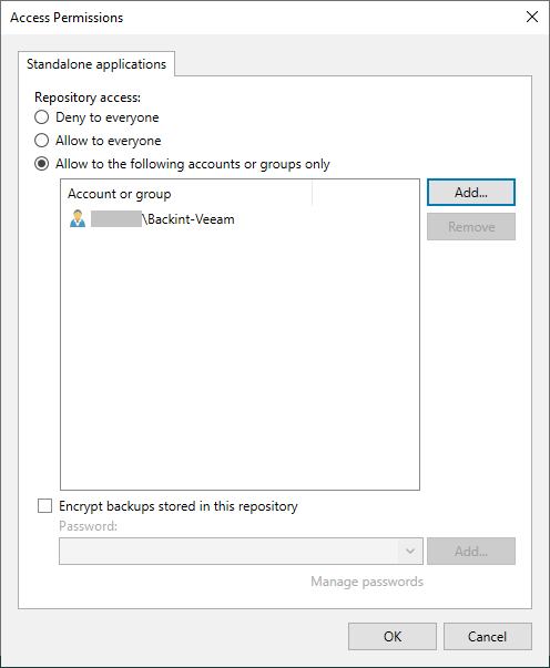

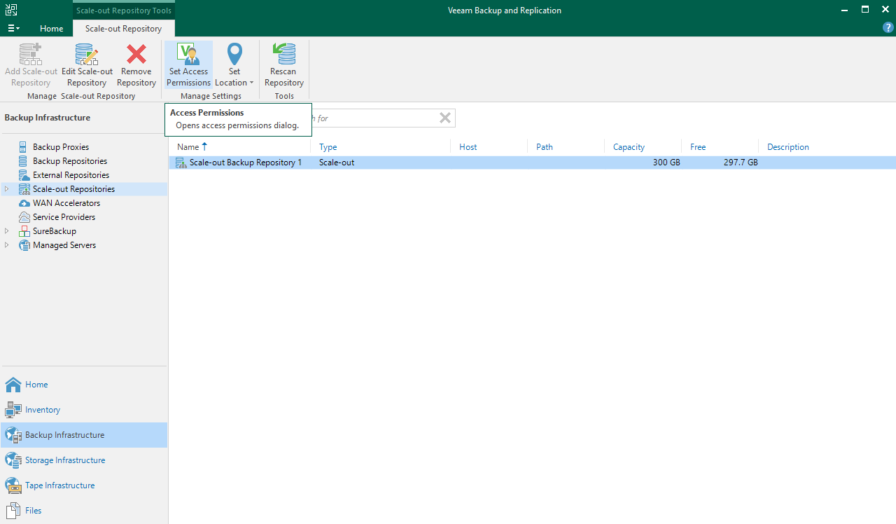

By default, no access is allowed to this Scale-out Repository.
Select your Scale-out Repository and click Set Access Permissions.
sbr_no_snc_6
You have the option to allow all user accounts to use this Scale-out Repository or limit it to a defined list. We recommend allowing only the necessary accounts.
sbr_no_snc_7

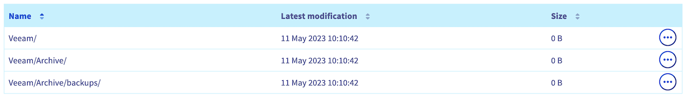

On your Object Storage bucket, a hierarchical structure has been generated and configured by Veeam Backup and Replication.
sbr_no_snc_8

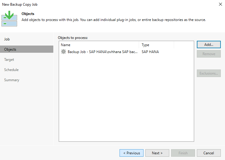

A Backup Copy job allows you to duplicate backups from one Backup Repository to another, ensuring the security of these backups on a separate storage location. This operation is useful for protecting critical data from loss or corruption by keeping a copy on a remote backup site. With this feature, you can configure advanced backup strategies to ensure the resilience and availability of your data in the event of a disaster.
Ports tcp/2500-3300 must be open between Backup Repositories.

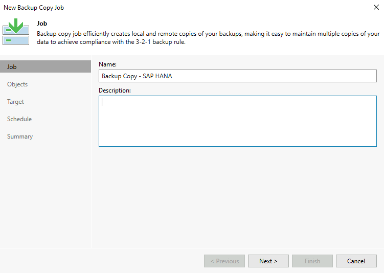

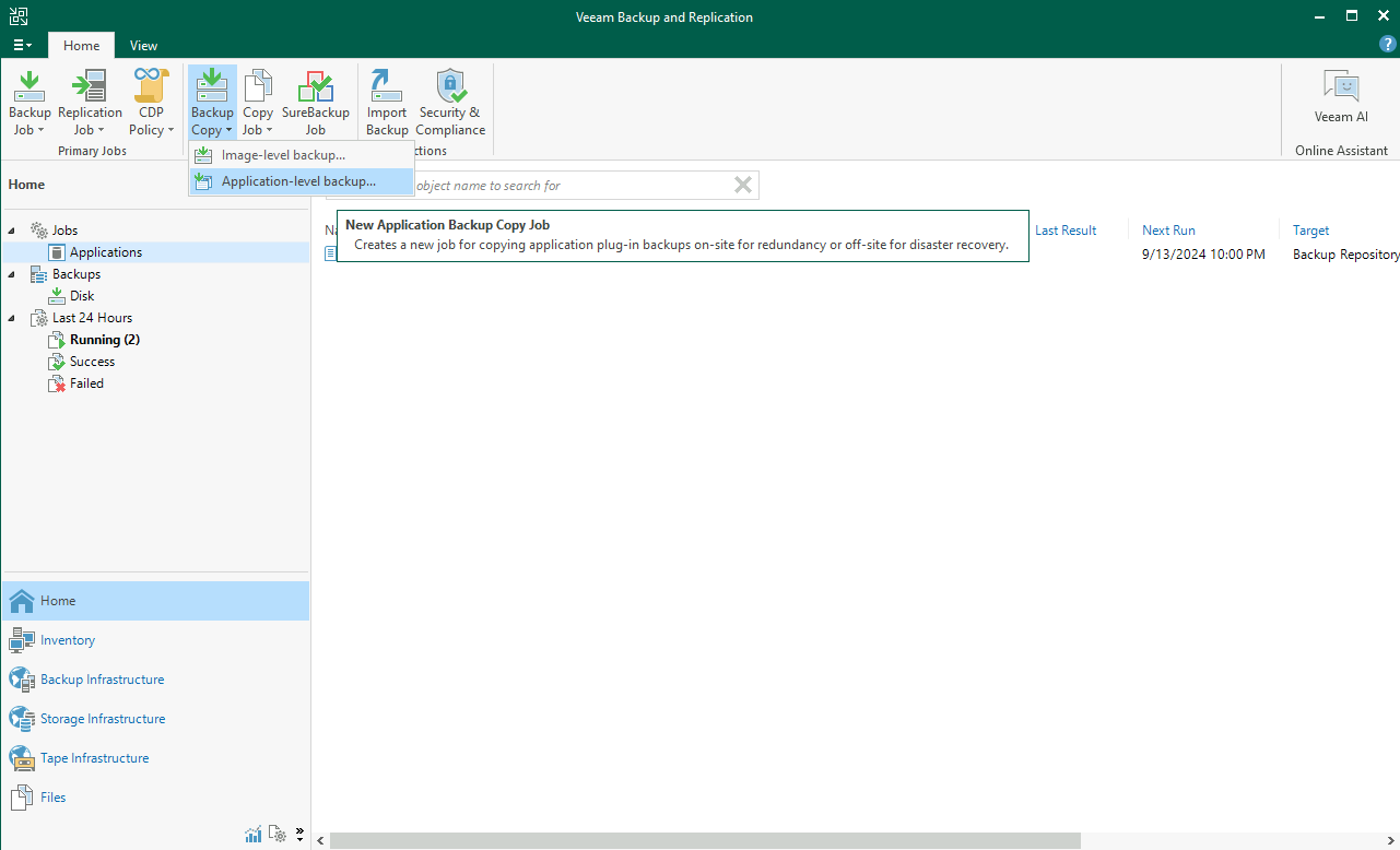

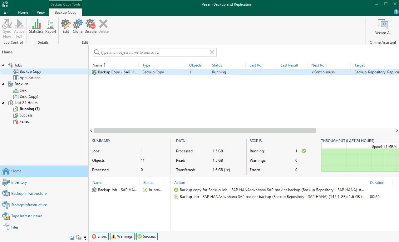

Open the Veeam Backup and Replication console, select the Home menu, Backup Copy, then Application-level backup....
backup_copy_1
Give a name to your Backup Copy job.
backup_copy_2
Add either the Backup jobs that manage your SAP HANA database backups or the Backup Repository where they are stored.
In this guide, we have chosen to use the Backup job.
backup_copy_3

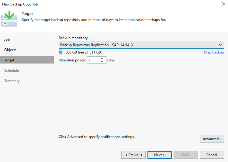

Select your second Backup Repository that will host the backup copies.
Review the available settings in the Advanced menu.
backup_copy_4

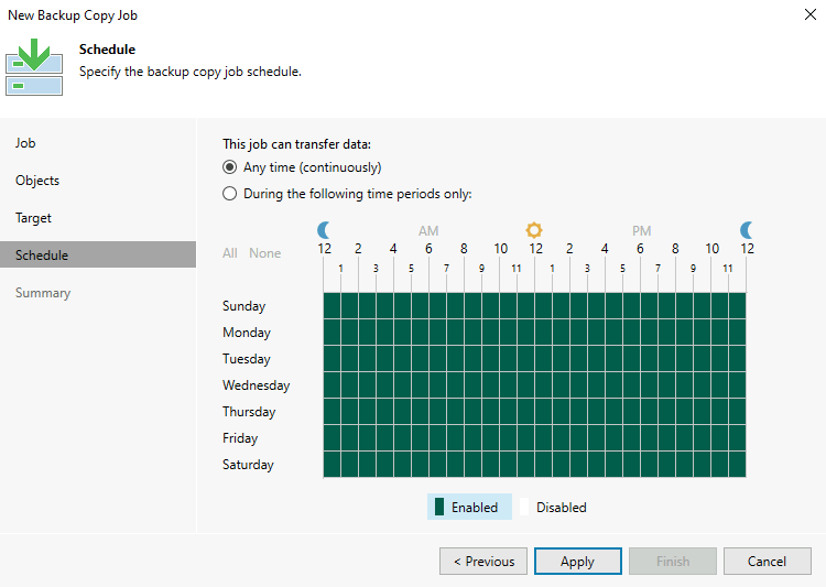

Configure the replication slots if desired. By default, a copy is triggered as soon as a backup is made.
backup_copy_5
Your Backup Copy job is now operational.
backup_copy_6

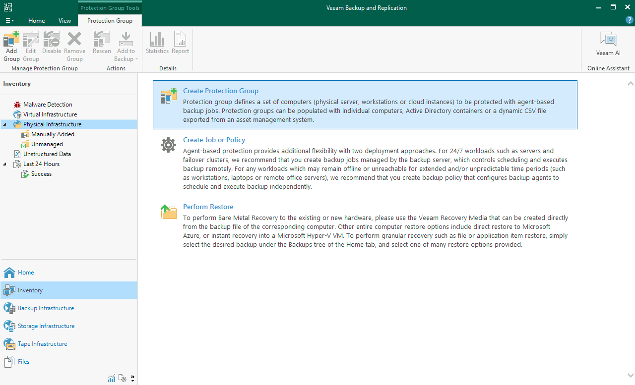

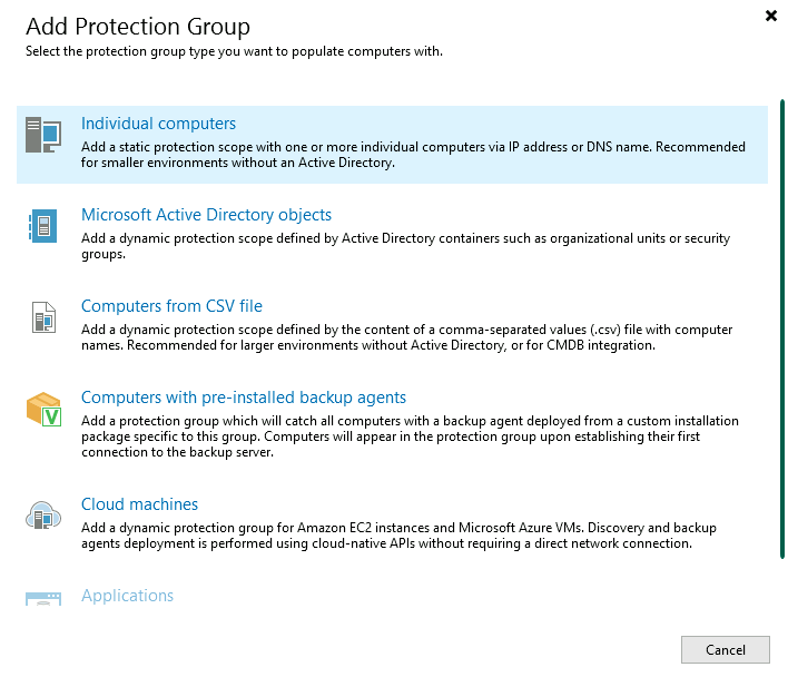

Open the Veeam Backup and Replication console, select Inventory, then Physical Infrastructure.
Click on Create Protection Group.
pg_hana_1

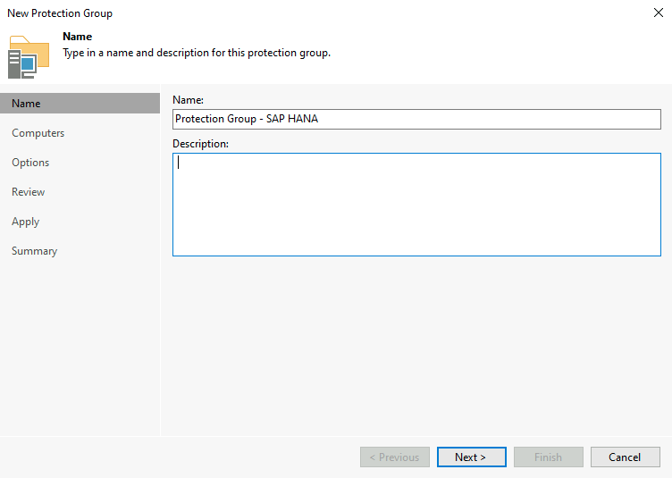

Click on Individual computers.
pg_hana_2
Name your protection group. Then click on Next.
pg_hana_3

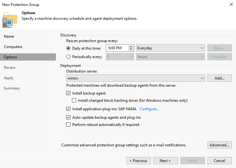

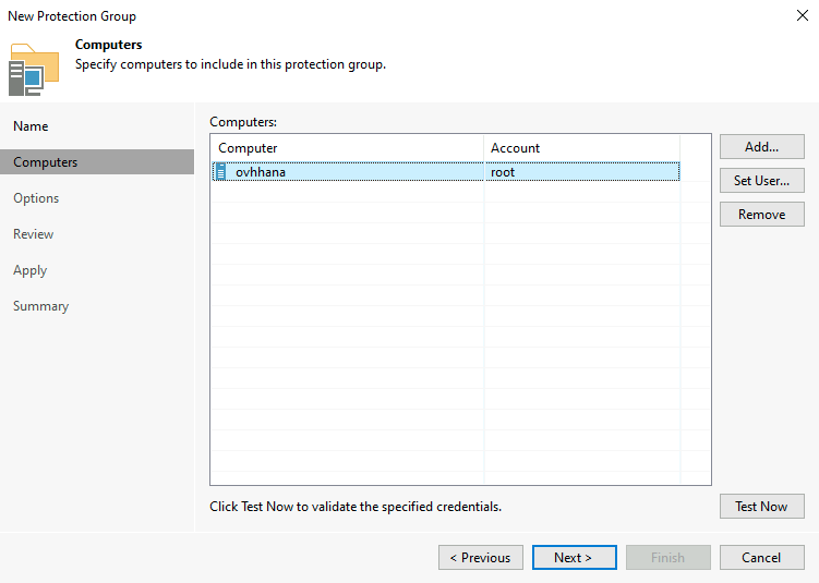

Add the desired SAP HANA databases to this protection group. For example, you can group your production databases.
For security reasons, it is recommended to create a dedicated Linux account for the Veeam connection to your server instead of using the root account.
pg_hana_4
Configure the protection group scan frequency.
Check Install application plug-ins. Click on Configure, then check SAP HANA.
Click on Next to proceed.
pg_hana_5

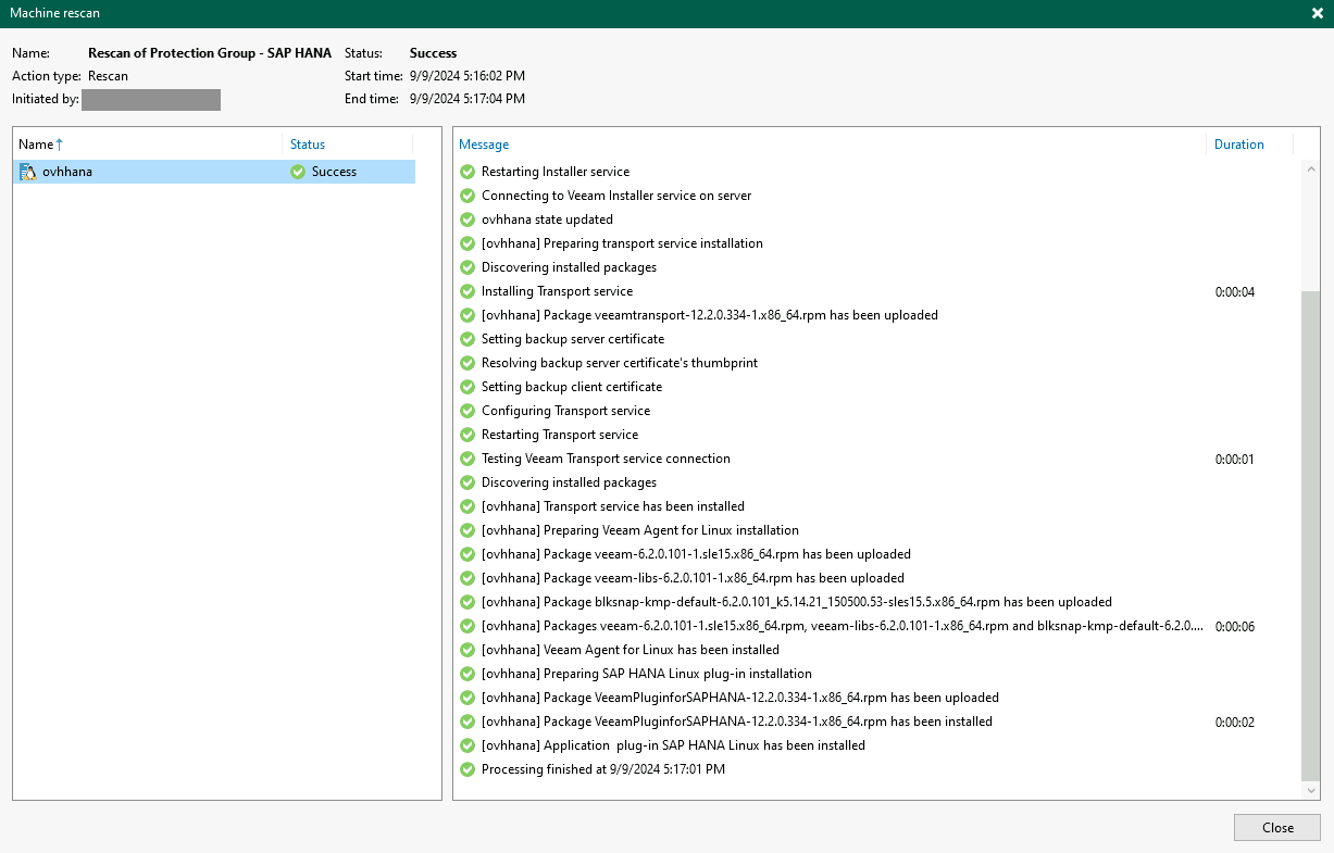

The protection group creation begins, a first scan is launched on the SAP HANA database(s) you previously added, and the Veeam Plug-in for SAP HANA installation along with its dependencies starts.
pg_hana_6

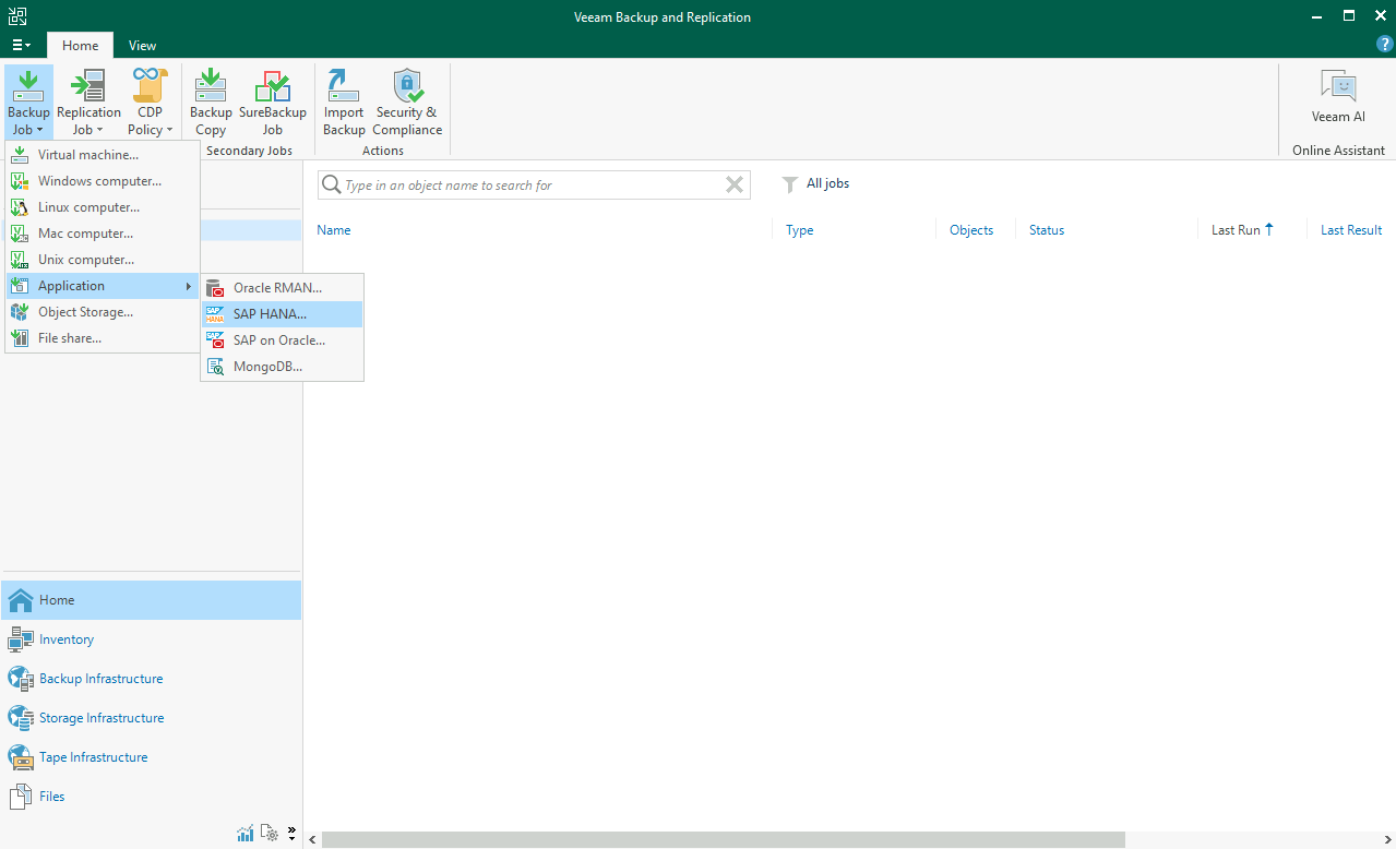

Open the Veeam Backup and Replication console, select the Home menu, Backup job, Application, then SAP HANA.
bj_hana_1

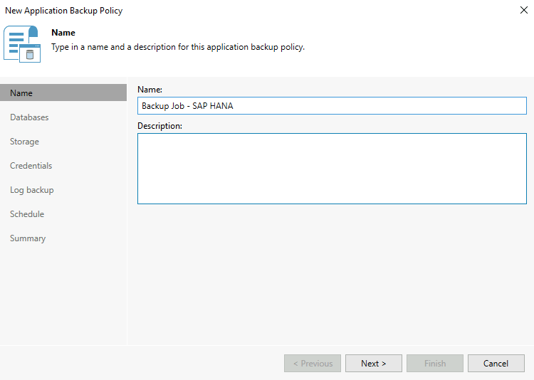

Give a name to your SAP HANA backup job. Then click on Next.

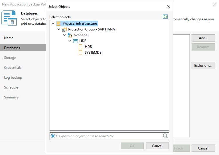

Select your SAP HANA databases, as well as the associated TENANTs (SYSTEMDB and/or TENANTDB) that you want to manage with this backup job. Then click on Next.

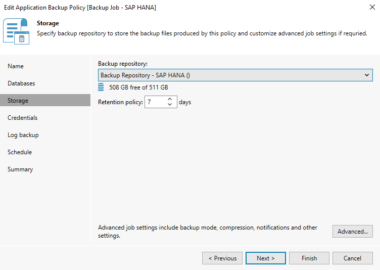

Select the Backup repository where you want to store your SAP HANA backups. You also have the option to manage the retention of backups in this Backup repository. However, retention does not delete backups in the SAP HANA backup catalog.
Click on Advanced... in order to schedule full backups, select the type of incremental or differential backups. In the SAP HANA tab, you have the possibility to configure the number of channels to optimize the speed of SAP HANA backups.
Click on Next to continue.

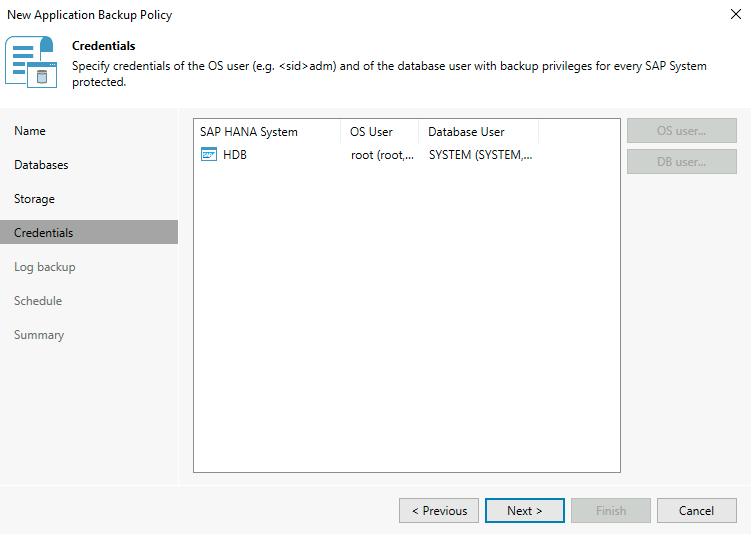

Configure the OS and SAP HANA database credentials. Then click on Next.
For security reasons, it is recommended to create a Linux user dedicated to connecting Veeam to your server instead of using the root account. The same applies to the account allowing connection to the SAP HANA database, this account only needs backup privileges.
bj_hana_5

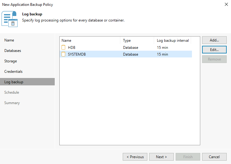

You have the option to manage log backups either by the SAP HANA mechanism or by Veeam. By choosing log backup management via Veeam, you get detailed information about log backups in the Veeam Backup and Replication console.
In this guide, we have chosen to use management via Veeam to present the feature to you.
bj_hana_6

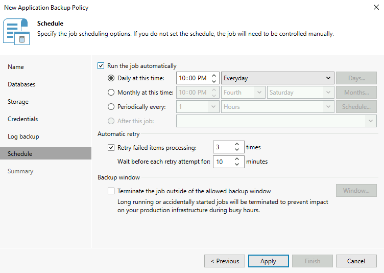

Configure the scheduling of the backup job execution. Then click on Apply.
bj_hana_7

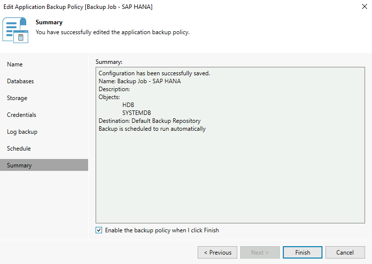

Make sure to check Enable the backup policy when I click Finish to activate the backup job. Click on Finish to complete the configuration of the backup job.
bj_hana_8

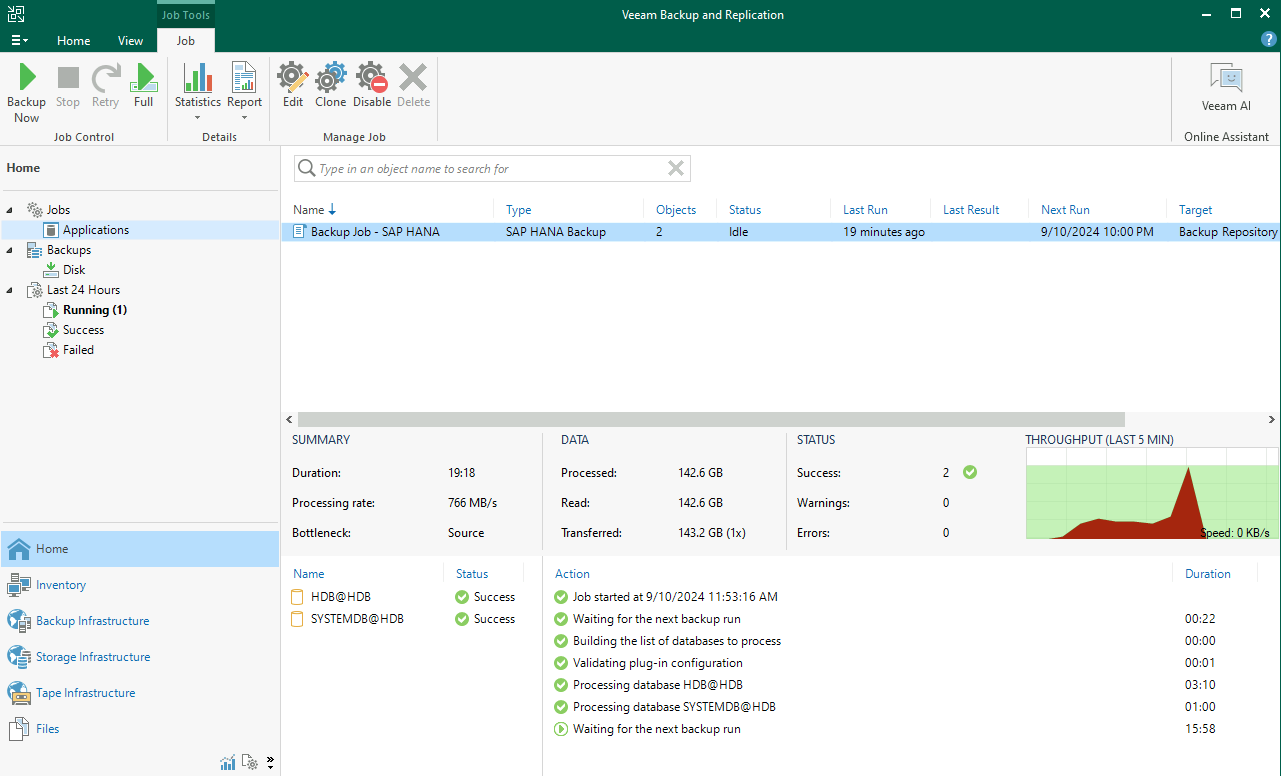

You can now run a backup of your SAP HANA database to ensure that your configuration works as desired.
To do this, simply go to the Home menu, select Jobs then Applications, then select your backup job and click on Full. This will launch a full backup of the SAP HANA databases configured in this backup job.
You can follow the progress of the backup job.
full_backup

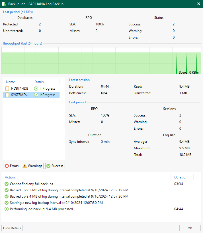

When performing log backups, you have the option to access detailed information.
log_backup

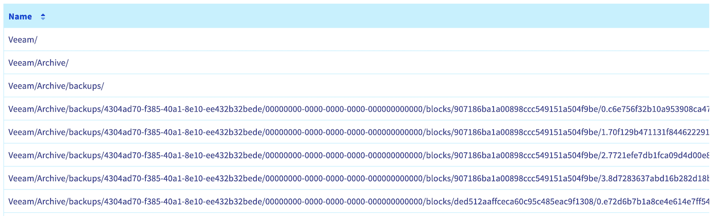

If you have configured a Scale-out Repository with an Object Storage bucket, you can observe your backups on your Object Storage bucket.
sbr_s3

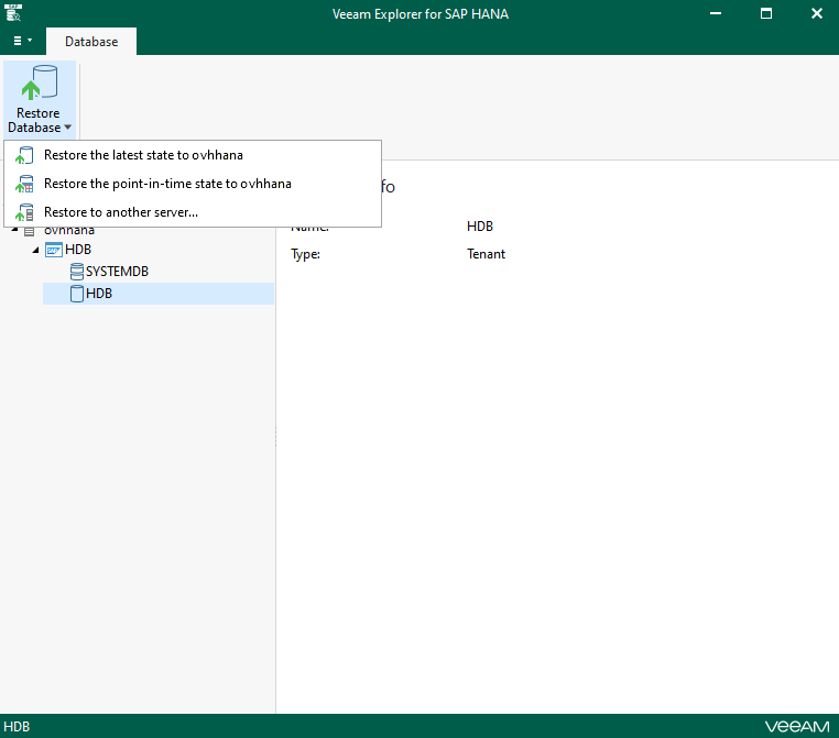

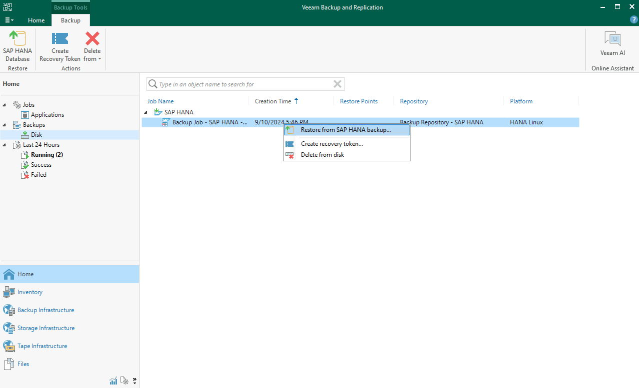

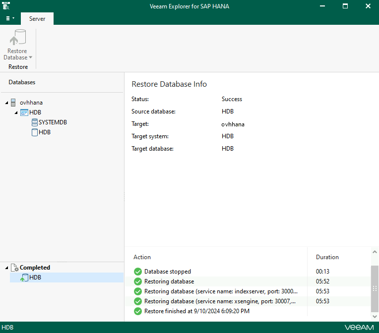

Open the Veeam Backup and Replication console, select Home, Backups, Disk, then click on Restore from SAP HANA backups... by right-clicking the backup of your SAP HANA database.
The Veeam Explorer for SAP HANA application opens and allows you to restore either the SYSTEMDB or the TENANTDB of your SAP HANA database. All restoration modes are available:
You will be guided through the restoration steps based on the mode you select.
The restoration of your SAP HANA database is executed. You have the possibility to follow the progress of the restoration via Veeam Explorer for SAP HANA.
Once the restoration is completed successfully, your database is started.
