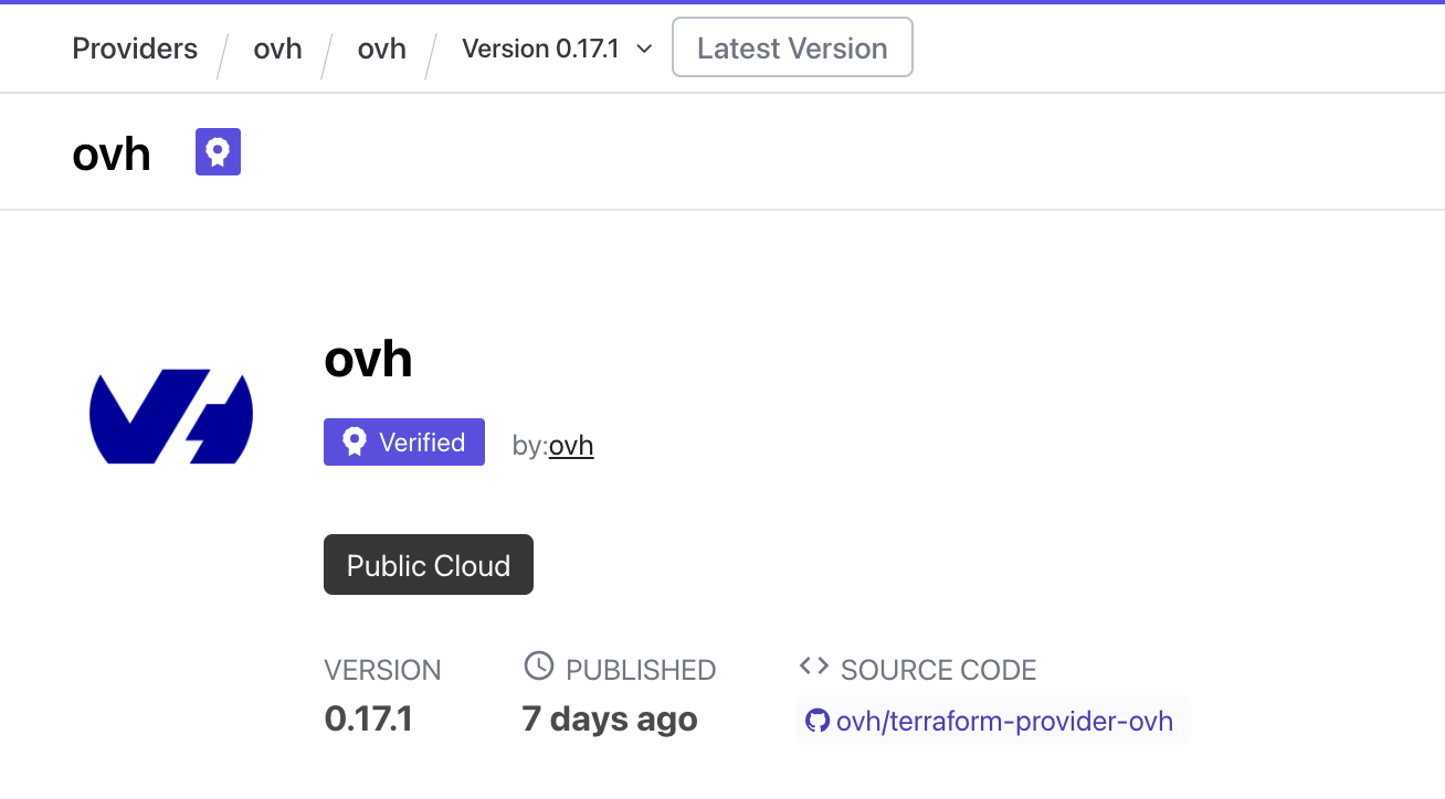

OVHcloud Terraform provider
Terraform
In order to create a private registry and other resources, OVHcloud provides a Terraform provider which is available in the official Terraform registry.
Terraform registry
All available resources and data sources have their definition and documentation.

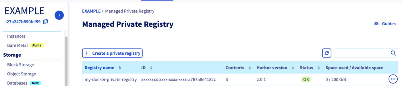

If after running the terraform apply command, you get the error message Error: Your query returned no results. Please change your search criteria and try again, it means you have entered an incorrect region.
Now, log in to the OVHcloud Control Panel, go to the Public Cloud section and click on Managed Private Registry.
As you can see, your registry has been successfuly created:
Private registry created
