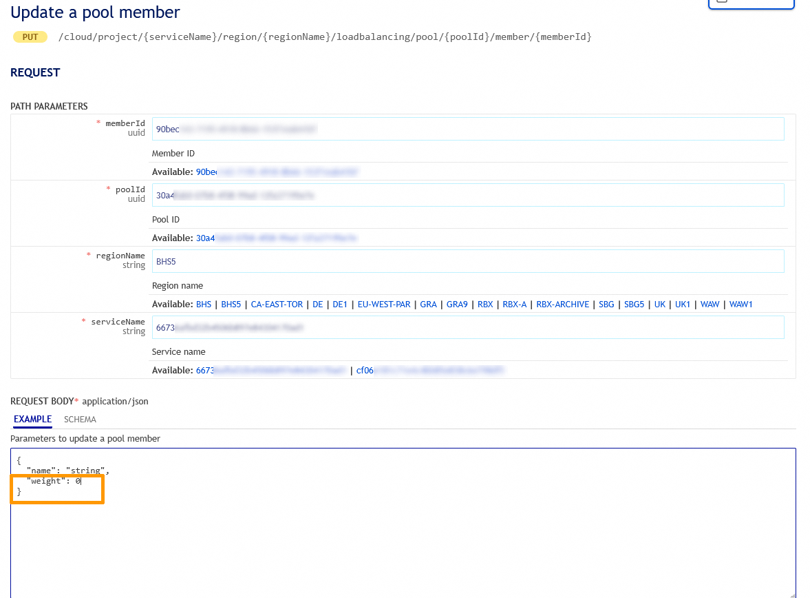

You can update a pool member with the following API call:
Fill in the fields with the previously obtained information:
  • serviceName: The Public Cloud project ID in the form of a 32-character string.
  • regionName: The name of your region.
  • poolId: The Pool ID in the form of a 32-character string.
  • memberId: The Member ID in the form of a 32-character string.
  • weight: Set the weight to 0.
Click on Execute.

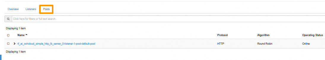

In the tab, click on Pools and then on the pool in which the member is.
public-cloud

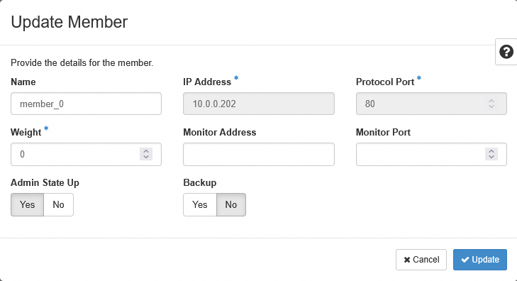

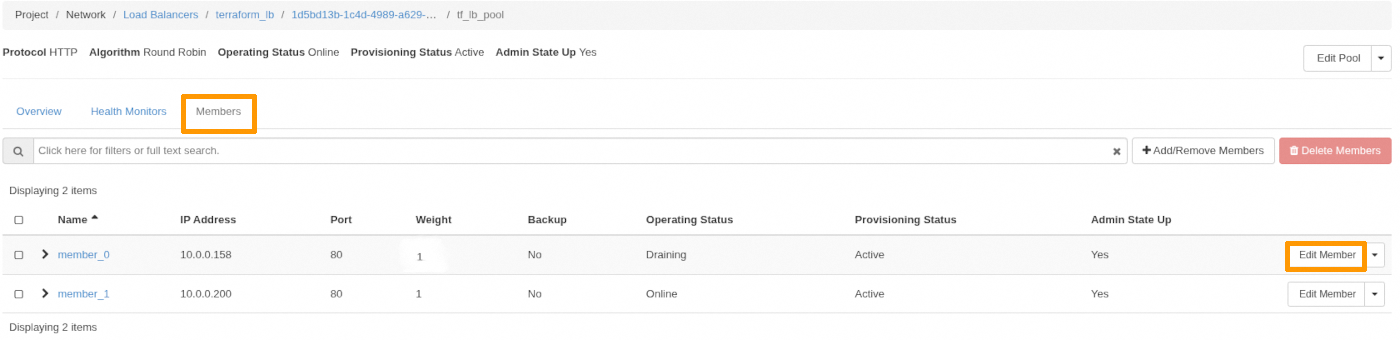

In the tab, click on Members and then on Edit Member.
Update Member Openstack dashboard
Edit the Weight to 0, then click on Update.
Update weight

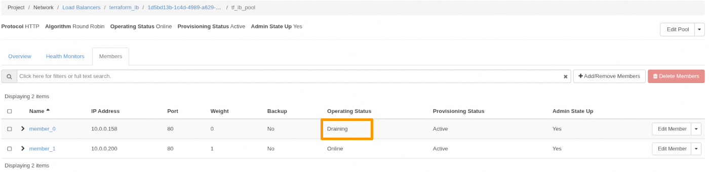

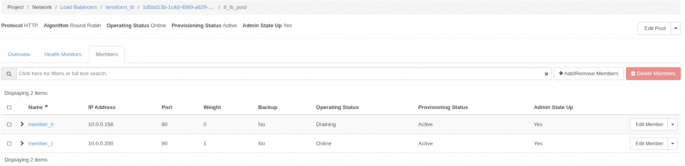

Step 3 - Verify Member Status
After setting the member’s weight to 0, its status will change from ONLINE to DRAINING.
It is important to note that in the current system, the member will remain in the DRAINING state even after all traffic has been drained.
This can be confusing because some users expect a final status of DRAINED once all traffic has been redirected. However, the system does not automatically transition to DRAINED.
  • DRAINING simply means that the member is no longer receiving traffic, not that it is still actively draining traffic.
  • The DRAINED status is not yet supported in the current OpenStack API.
If having a final DRAINED status is critical for your operations, it is recommended to submit a feature request to OVHcloud for this functionality in a future update. However, this will only be possible once this feature is supported by OpenStack.
To check the member's status, click on Network in the left tab then on Load Balancers.
Click on the load balancer concerned.
Click the Members tab:
Update weight
You can check the member’s status using the following command:
$ openstack loadbalancer member list <pool_name>
You should see:
id                                   name       provisioning_status  operating_status   weight
27cfe834-7fef-4548-b71b-fa0ce67222f8 member_1   ACTIVE               ONLINE             1
118756ba-2cae-4141-b9c2-8b18b120c8dc member_0   ACTIVE               DRAINING           0

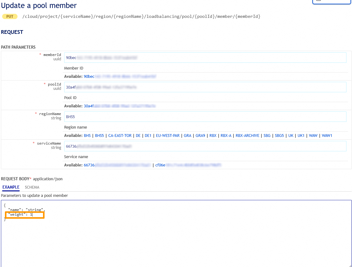

Step 6 - Restore traffic to the member
Once the maintenance is complete, set the weight of member_0 back to its original value (e.g., 1):
To update the weight, use the following API call:
  • weight: Set the weight to 1.
Click on Execute.

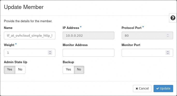

Click on the Members tab, and then on Edit Member next to the corresponding member.
You can edit the Weight to 1 then click on Update
