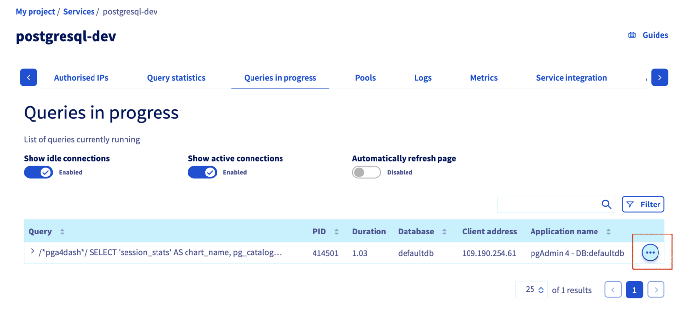

Click on Databases in the left-hand navigation bar and select your PostgreSQL instance.
Click the Queries in progress tab. This table is regrouping ongoing queries with some filtering options, such as showing idle or active connections.
The query table shows the exact query, among with detailed information: PID (Process ID), Duration, Database, Client address and Application name.
In the table list, find the session you want to terminate then click the ... button at the end of the line. You will be able to terminate the session and related backend process directly.
Terminate button
The query will disappear but if your client application is coded to redo the query after a failure, another query and PID will reappear.
