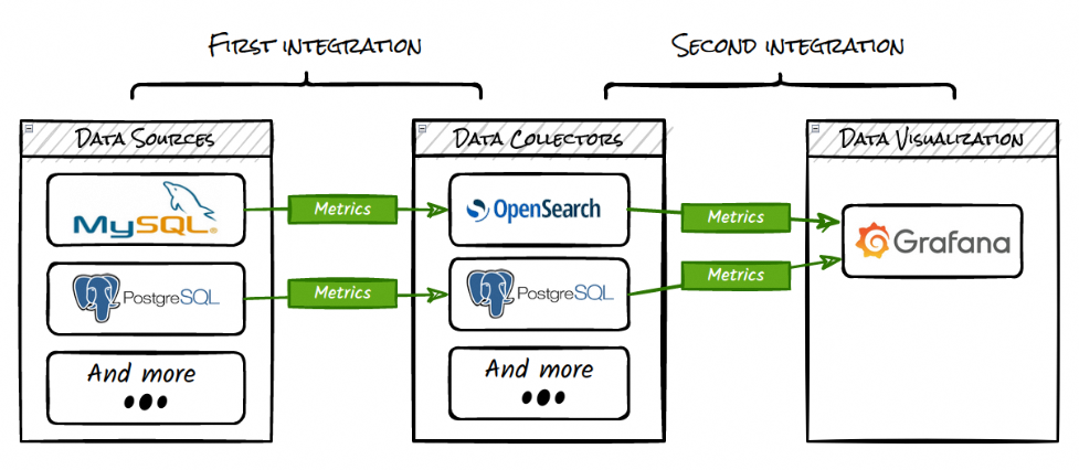

Concept
The Cross Service Integrations for Logs and Metrics allow you for example:
  • To send Valkey or MySQL metrics in PostgreSQL.
  • To send PostgreSQL or MySQL metrics to OpenSearch.
  • To show metrics in Dashboards service.
For that you need:
  • A source service
  • A destination service

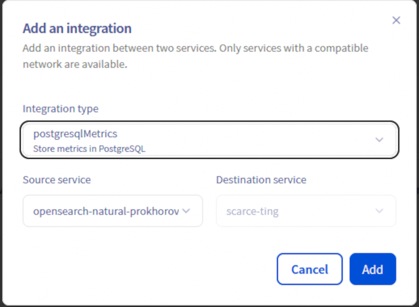

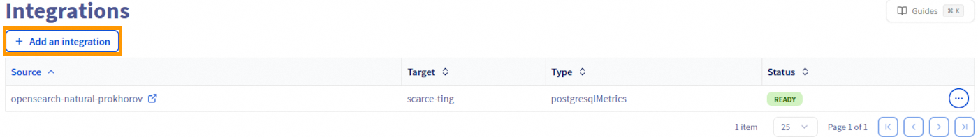

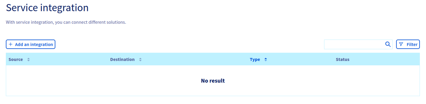

Click on Add an integration:
Service integration
Define the Integration type and the Destination service:
First create a Public Cloud Database for your Destination service via your Control Panel or API.
Create integration

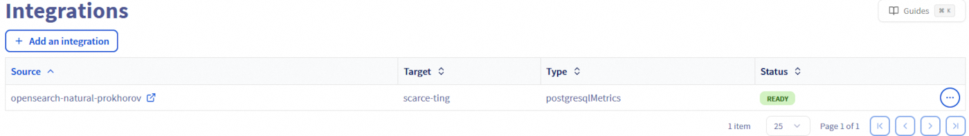

Your first integration is ready:
Result

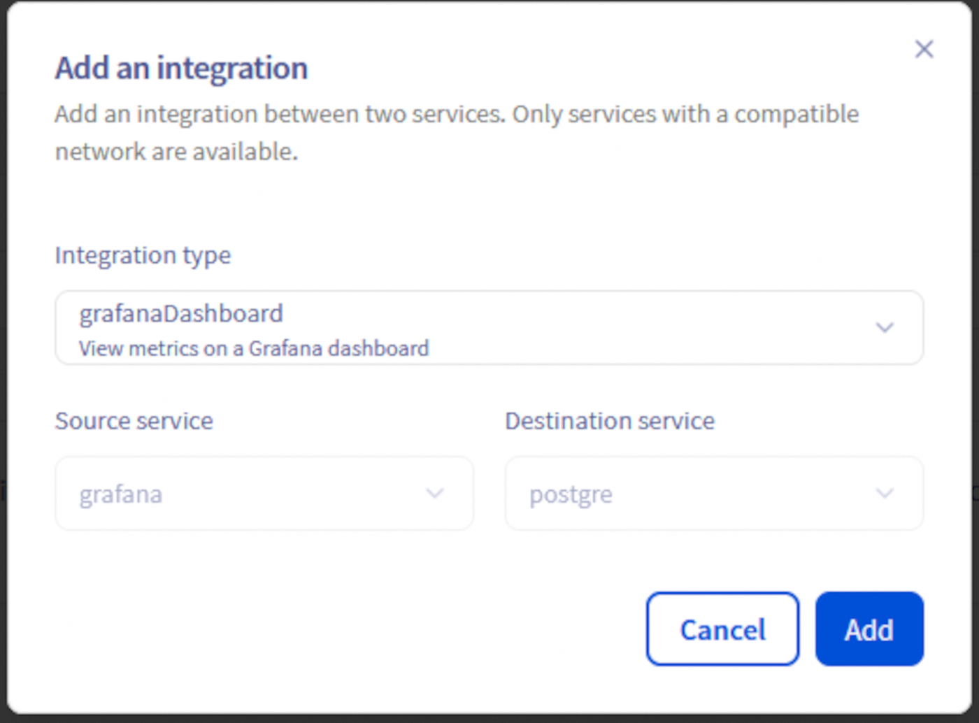

Allow metrics visualization into Dashboards service

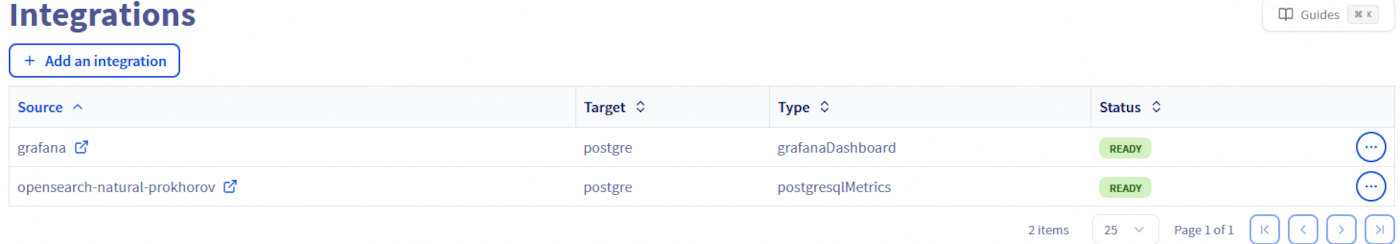

Go to the Service integration tab of your Destination service service and click on Add an integration
Service integration
As you can see, the first integration is referenced.
Define grafanaDashboard as Integration type and the Source service:
Create integration
Your second integration is ready:
Result

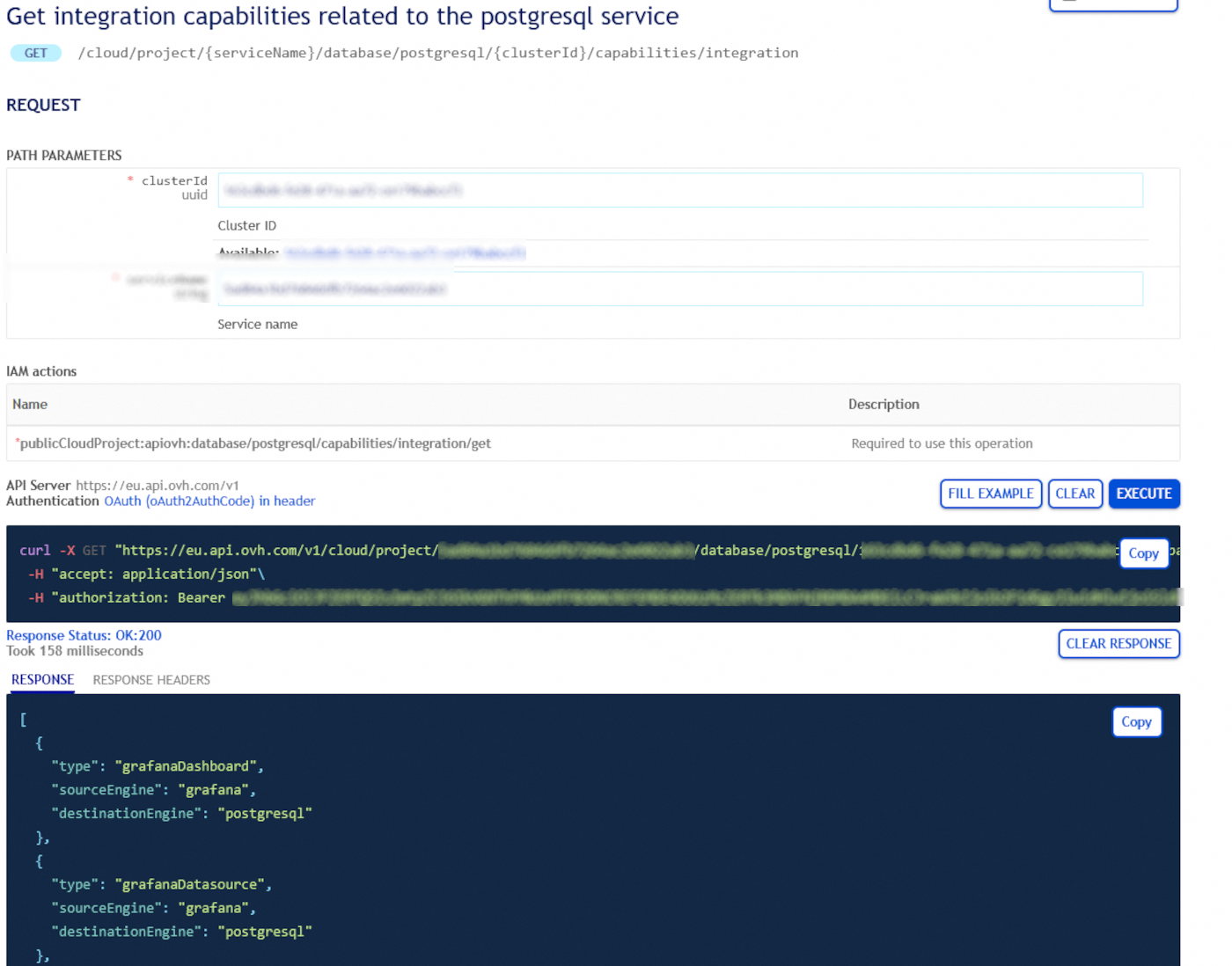

Get integration capabilities
Get integration capabilities related to your Public Cloud Databases service:
Get Integration Capabilities

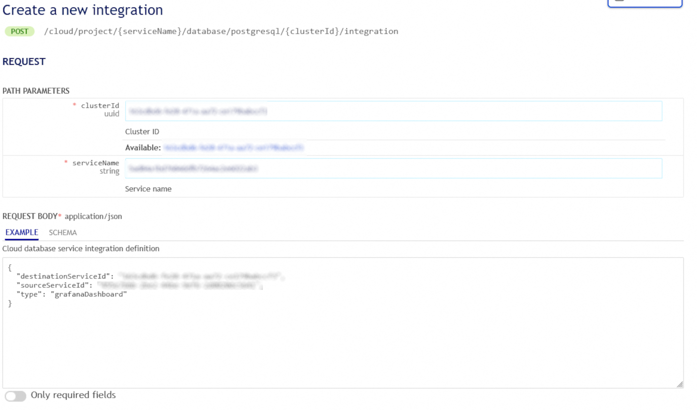

For that, you need to create a new integration:
Fill in the form with the information corresponding to the type of integration chosen.
Create a new integration
The destionationServiceId and the sourceServiceId correspond to the destination cluster ID and to the source cluster ID.

Once done, get the GrafanaDashboard integration capability related to the destination service:
Get Dashboards integration capabilitie
Then create a second integration from your Destination service name:
Create Dashboards Integration
