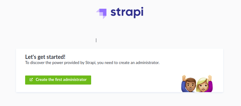

Then restart your instance and your Strapi headless CMS will be online.
Strapi
