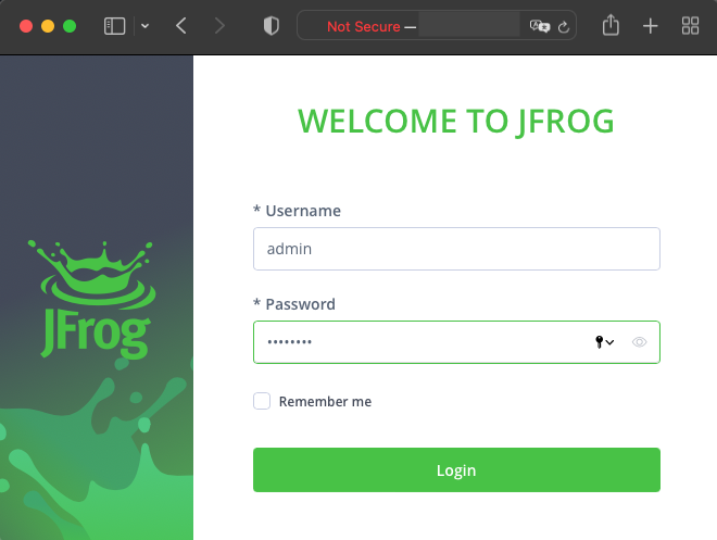

Open the service URL in a browser and enter the default credentials: admin for Username and password for Password:
Artifactory login page
Do not forget to change the default password!

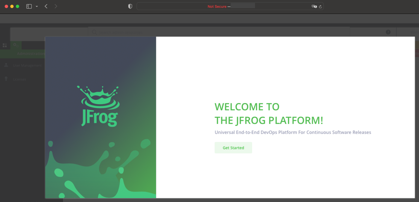

And that's it, you can start using your JFrog Artifactory instance:
Artifactory welcome page

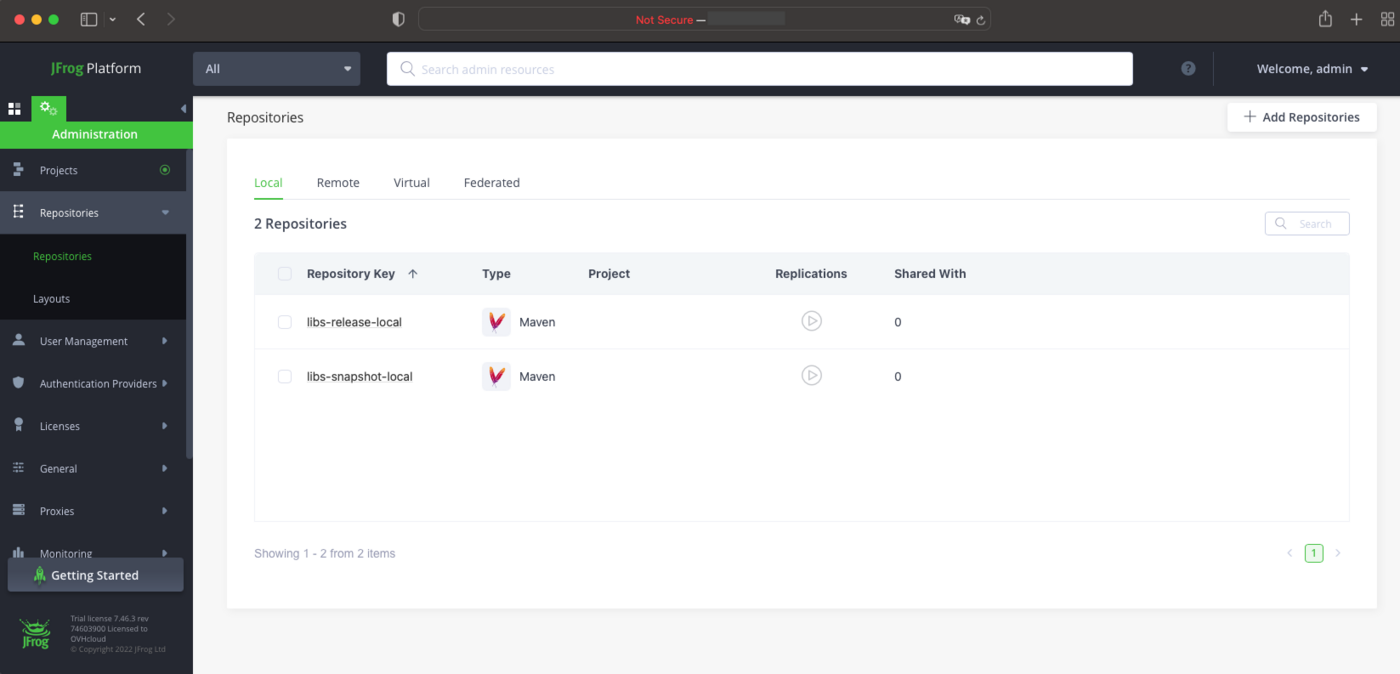

After completing the configuration steps (see the official documentation), your JFrog Artifactory is ready to use:
Artifactory Maven repositories
