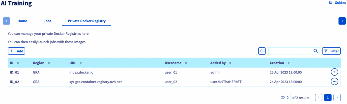

Manage existing registries through UI
Click this link to access your Public Cloud project, then go to the AI Training section, which is located under AI & Machine Learning.
By clicking the Private Docker Registry button, you should be able to see and manage (add, delete) your different private registries.
Note that the shared registry will not appear here. This one is displayed in the Home panel of AI Training.

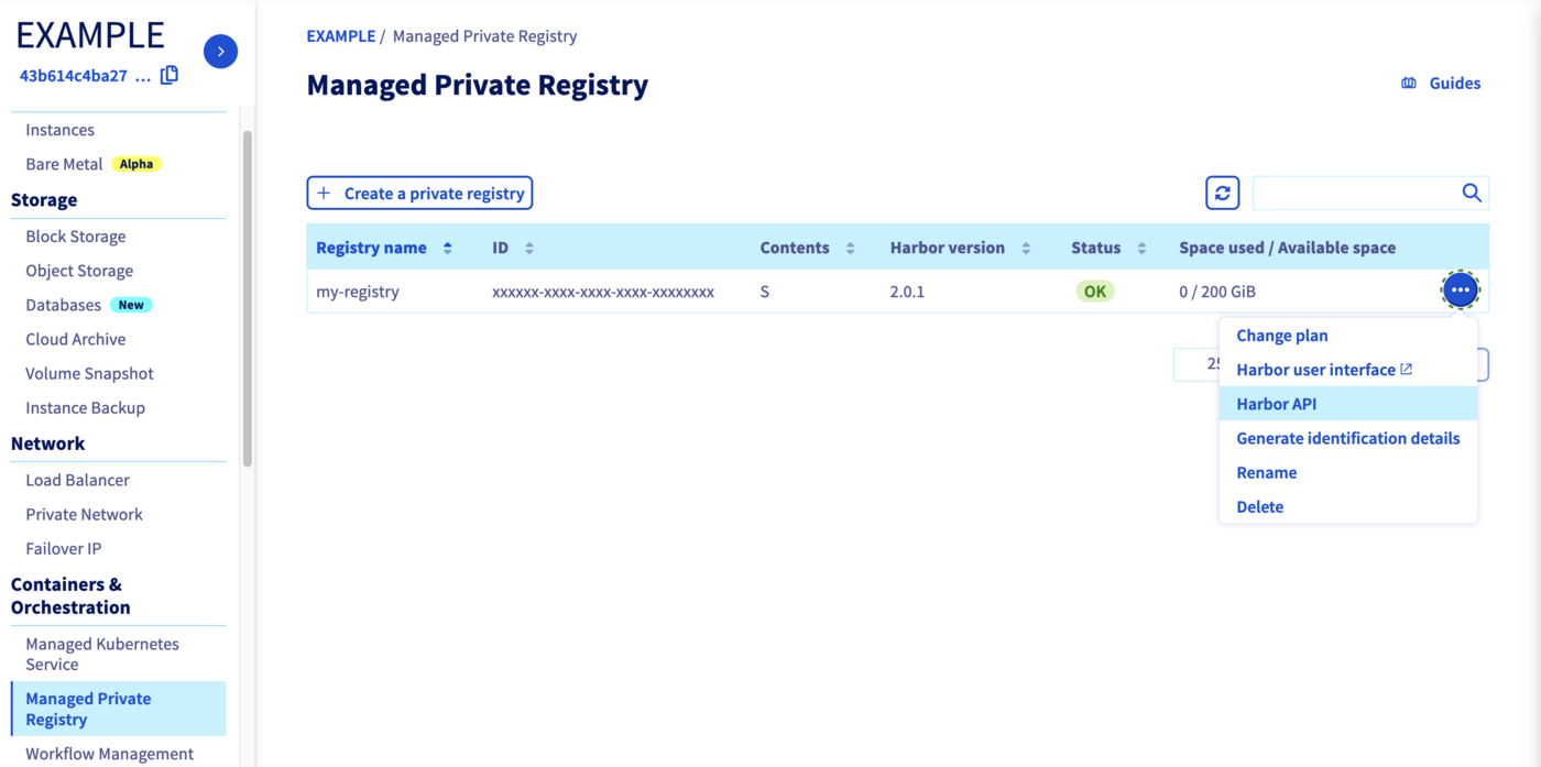

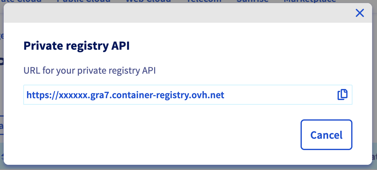

Get your OVHcloud Managed Private Registry API URL
In order to add this registry to AI Tools, you will need to retrieve its URL. To do this, go to the Managed Private Registry section on the OVHcloud Public Cloud Manager, and in the "more options" button (...) at the right, click on Harbor API: image
Then, copy the URL of the Harbor API, which is the URL of your private registry: image

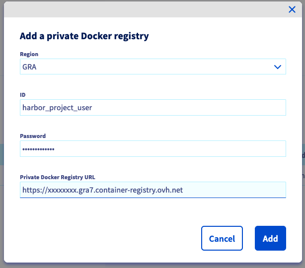

To add your private registry via UI, click this link to access your Public Cloud project, then go to the AI Dashboard section which is located under AI & Machine Learning.
By default, you will be redirected to the Dashboard panel. To add a custom registry URL, click the Docker Registries button. Once there, click the + Add button to add your private Docker registry.
Here, you will need to provide the credentials of your registry along with its URL.
add registry form
When you have finished filling in the form, click Add.

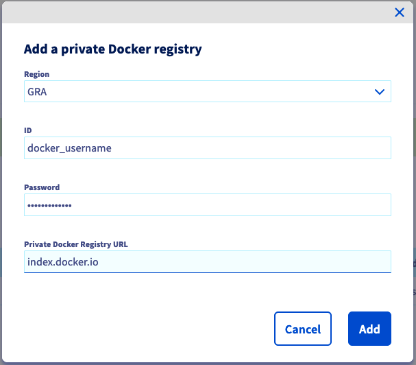

Add the private Docker registry
Once your image is pushed to your Docker account, you will need to add your private Docker registry to the registries of your Public Cloud project.
As with Harbor, this can either be done with UI or CLI. This time, your private registry's URL will be index.docker.io and the requested username and password correspond to those of your Docker account.
During this step, you will be asked your Docker credentials.
Using UI
Click this link to access your Public Cloud project, then go to the AI Dashboard section which is located under AI & Machine Learning.
Here, you will need to provide your Docker credentials along with its URL.
add registry form

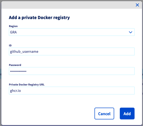

Add a GitHub registry
Once your image is pushed on your GitHub account, you will need to add your GitHub registry to the registries of your Public Cloud project. As with Harbor and Docker, this can either be done with UI or CLI. This time, your registry's URL will be ghcr.io.
You will be asked your GitHub credentials.
Here, you will need to provide your GitHub credentials along with the registry URL.
add registry form
