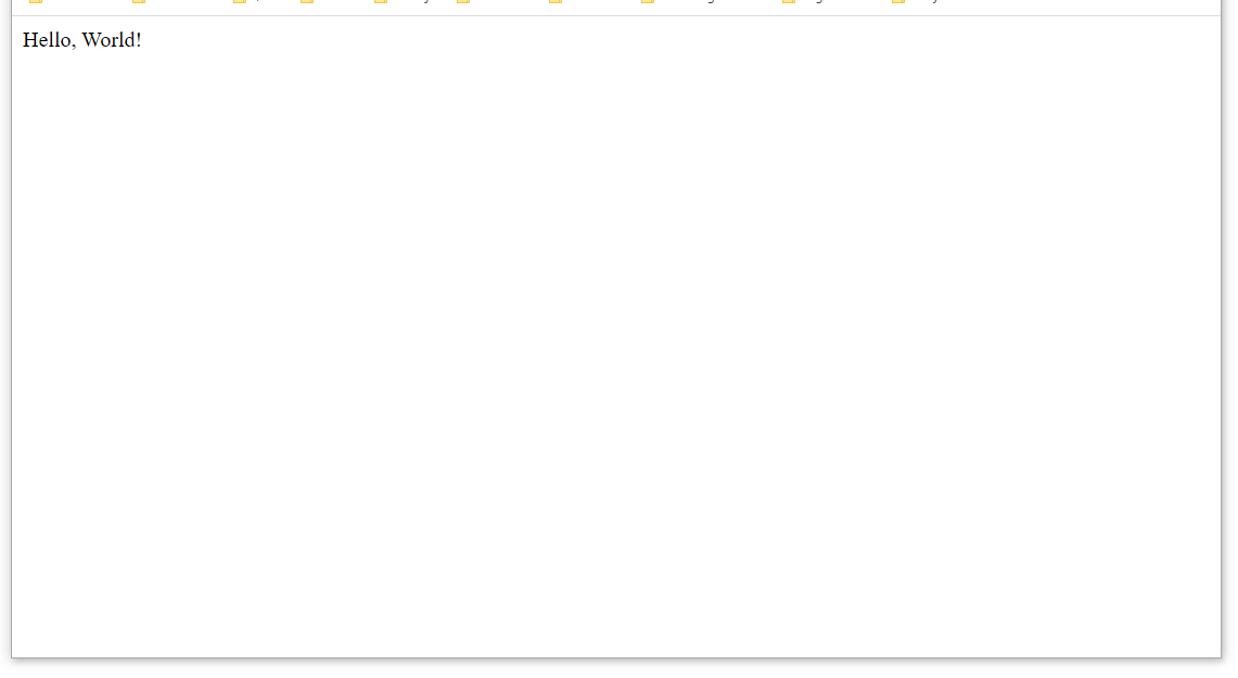

Then restart your instance and your Flask project will be online.
Flask
