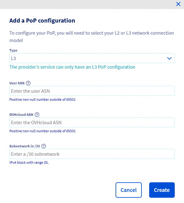

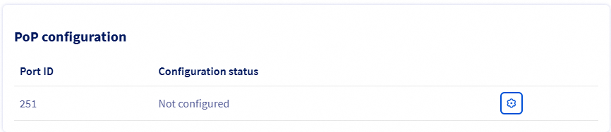

Once you have connected your vRack, click the cogwheel button in the PoP configuration section and select the L3 configuration from the drop-down menu.
PoP addition
You will then need to enter the following:
InformationDescription
Customer ASNYour AS BGP number, which is configured on your router located in the PoP
OVHcloud ASNThe OVHcloud AS number that will be configured on the OVHcloud Connect routers located in the PoP
Subnetwork in /30A size /30 IPv4 block, used for the link between your router and the OVHcloud Connect router located in the PoP
PoP addition

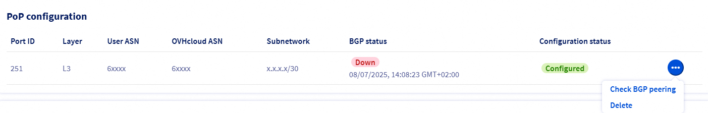

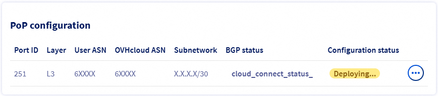

The PoP configuration menu will then appear.
PoP addition

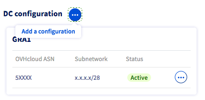

When your PoP configuration has been set, click Add a configuration under the AZ configuration menu.
adding AZ

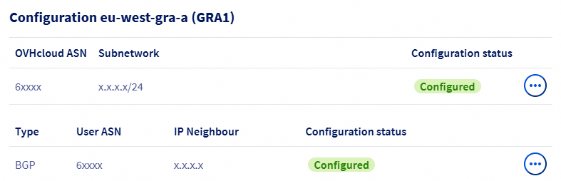

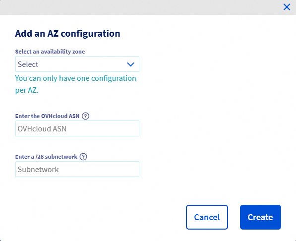

Select an availability zone from the dropdown menu, then enter the information required.
OVHcloud ASNThe OVHcloud AS number that will be configured on the OVHcloud Connect routers located in the AZ. This number may be different from the ASN chosen for the PoP
A /28 subnetworkA private subnetwork configured in your vRack in the selected AZ. This can be an IPv4 block of size /28 or higher
adding AZ

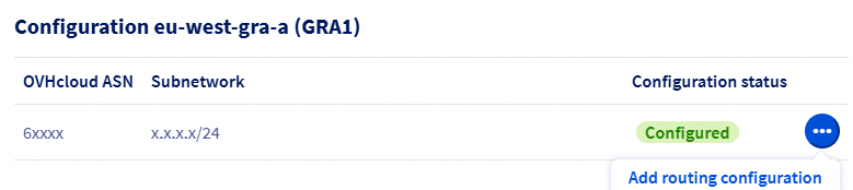

Click on the ... button on the desired availability zone then on Add routing configuration.
add AZ

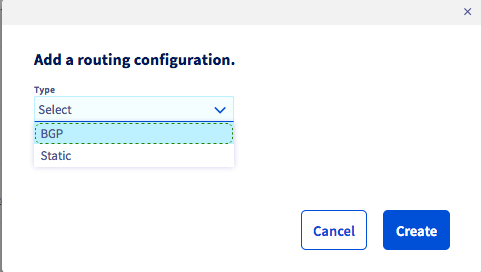

Then choose the routing type between Static and BGP.
add AZ

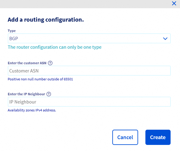

If you choose the BGP type, then enter the required information:
Customer ASNYour AS BGP number, which is configured on your router located in the AZ
IP NeighbourIP address of the BGP neighbour of your router in the AZ. This address must be part of the subnet specified in the AZ Configuration menu
add AZ

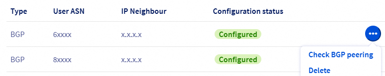

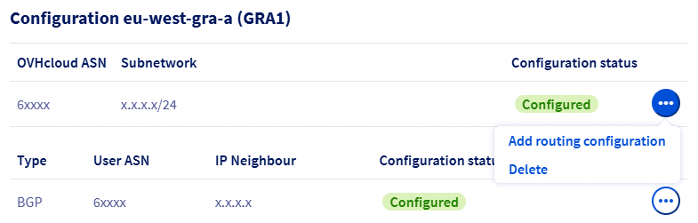

You can add multiple routing configurations within the same availability zone. The configuration type (BGP or Static) chosen for your first configuration will then apply to the next configuration in the same availability zone.
add AZ
