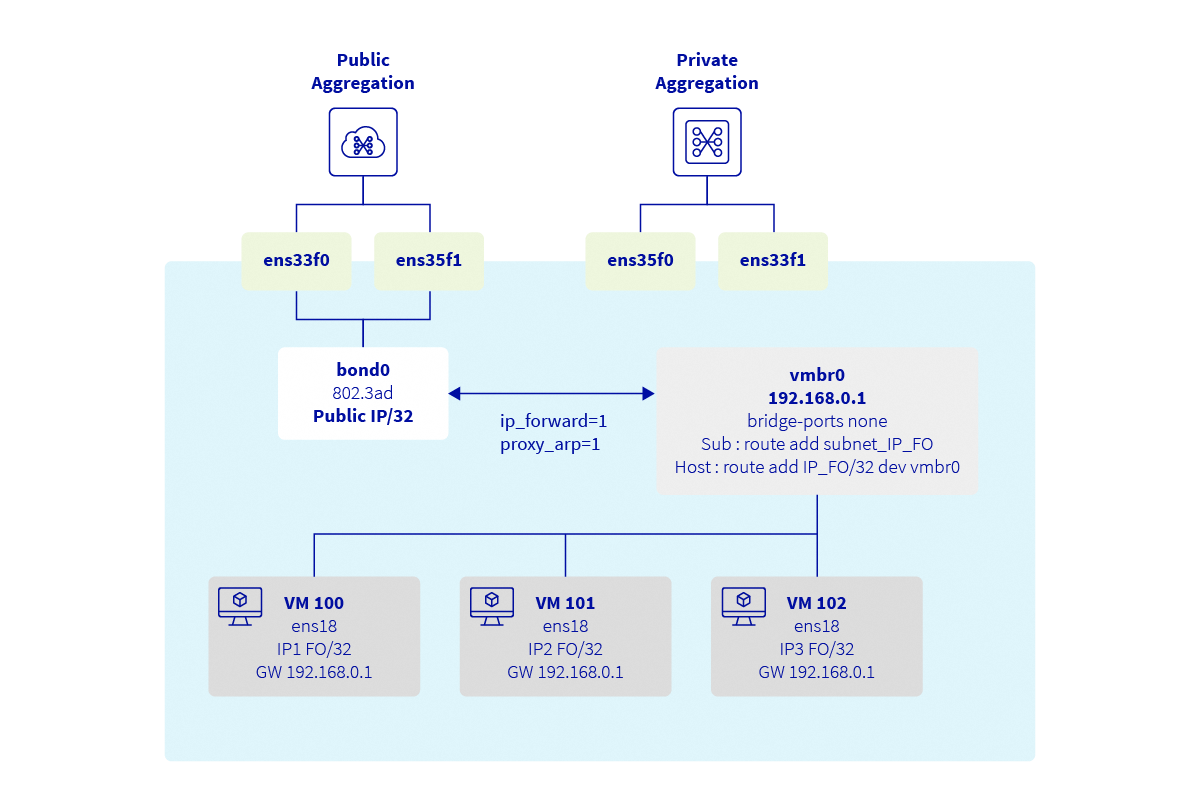

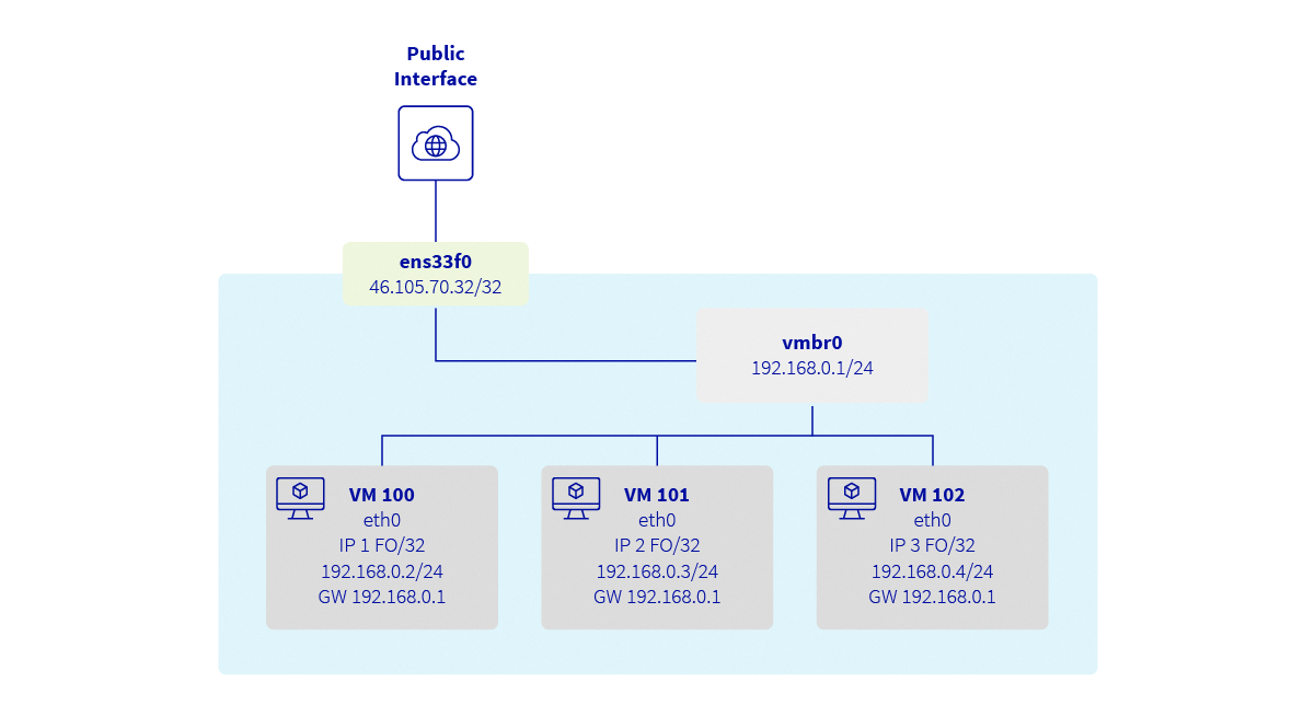

Additional IP in routed mode on public network interfaces
With this configuration, Additional IP addresses must be attached to a dedicated server. If you have multiple Proxmox virtualization servers and you want to migrate a VM from one server to another, you will also need to migrate the Additional IP address to the destination server, via the OVHcloud Control Panel or via the OVHcloud API. You can automate this step by writing a script that uses the OVHcloud APIs.
Target configuration schema
schema route
schema route
Explanations
Proxmox is a Debian-based distribution which relies on ifupdown2 for network configuration. In this guide, the network configuration will be modified via SSH and not via the Web interface.
We will:
  • connect via SSH on Proxmox
  • create a bond interface (only for the High Grade & Scale ranges)
  • create a bridge interface connected to the bond
  • allow packet forwarding between interfaces
  • add routes to the additional IPs

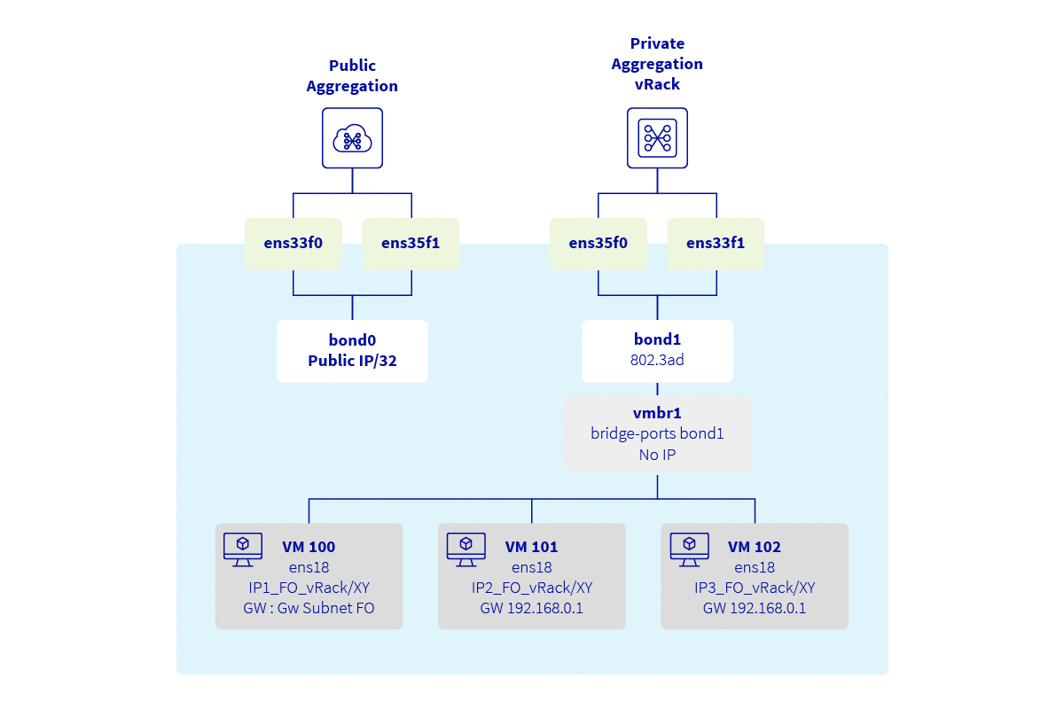

Additional IP via the vRack
This configuration is more flexible as you do not need to associate an Additional IP with a server, but with a vRack. This means that if you have multiple Proxmox virtualization servers and you want to migrate a VM from one server to another, you do not need to perform any action on OVHcloud APIs. The only requirement is for all servers to be connected to the same vRack.
This configuration only works with a block of additional IPs. It is not possible to use a single Additional IP (/32) directly in the vRack. To use an Additional IP, it must be configured on a public interface and cannot be directly integrated into the vRack.
schema vrack
Explanations
We will:
First, add your block of Additional IPs to the vRack. To do so, go to the Bare Metal Cloud section of your OVHcloud Control Panel and open the vRack menu.
Select your vRack from the list to view the list of eligible services. Click on the block of Additional IPs you want to add to the vRack, then click the Add button.
