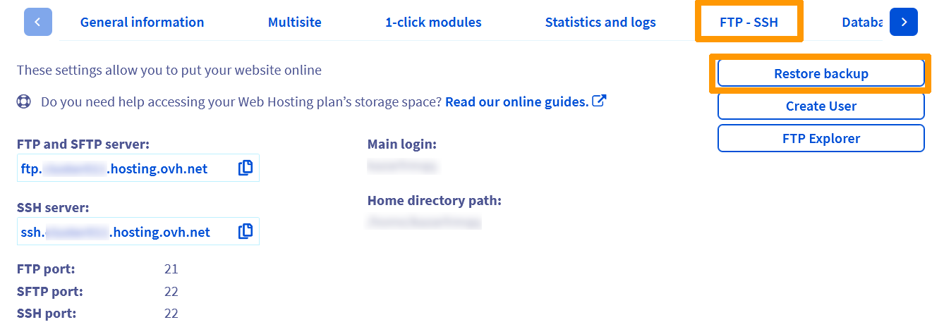

On the page that pops up, click on the FTP - SSH tab.
FTP - SSH
On the new page that appears, click Retrieve backup.
backupftp

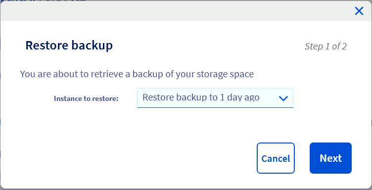

In the popup window that appears, select the restore date you want in the dropdown menu, using the information below:
Date shownTechnical backup date
D-1The same day, at 00:01 (UTC+1)
D-2One day ago, at 00:01 (UTC+1)
D-3Two days ago, at 00:01 (UTC+1)
1 weekLast Sunday, at 01:00 (UTC+1)
2 weeksSunday, 2 weeks ago, at 01:00 (UTC+1)
Once you have selected a date, click Next.
backupftp
Take a few minutes to check that none of your files will be lost after the restoration, e.g. any files saved on your storage space after the restore date you have selected. As a reminder, the restoration will effectively overwrite all of your current data, and replace it with the backup data.
Once you are ready to start restoring the backup, click Confirm.

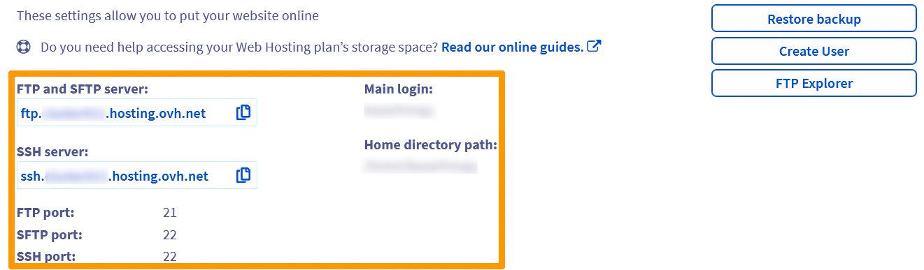

To access the backup data you would like to restore, you will need to log in to your storage space via the interface or software you have selected. To do this, you will need to have the FTP username, its password and your FTP server’s host name.
You can find this information in the FTP - SSH tab of your Web Hosting plan.
FTP- SSH
If you no longer have the FTP user password, please refer to our guide on instructions set out in our documentation on Modifying a FTP user password.
backupftp
