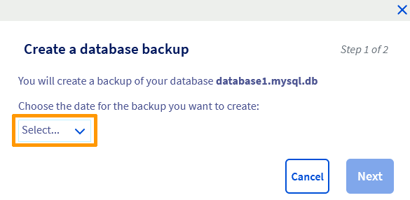

Click the ... button to the right of the database you want to back up, then Create a backup.
databasedump
In the window that pops up, select the date you want to back up, then click the Next button. Check that the information in the summary is correct, then click Confirm to begin the procedure.
databasedump
Wait for the backup to complete. Once it is available, you can retrieve it.

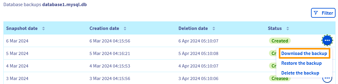

The table that opens contains all of the available backups for the selected database. You can view the exact date on which backups were taken, as well as the date on which they will be deleted from the OVHcloud tool.
To download a backup, click on the ... button to the right of the backup you want to retrieve, then on Download the backup. Accept the download to your machine, then wait for the backup to be downloaded.
databasedump
