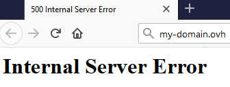

The "500 Internal Server Error" can affect your entire website or only parts of it. It can be permanent, appear sporadically, or result in a blank page.
error500
These errors may also come from updates carried out automatically by components of your website and therefore occur without any action taken on your side.
Learn how to diagnose the most common cases of "500" type errors.
