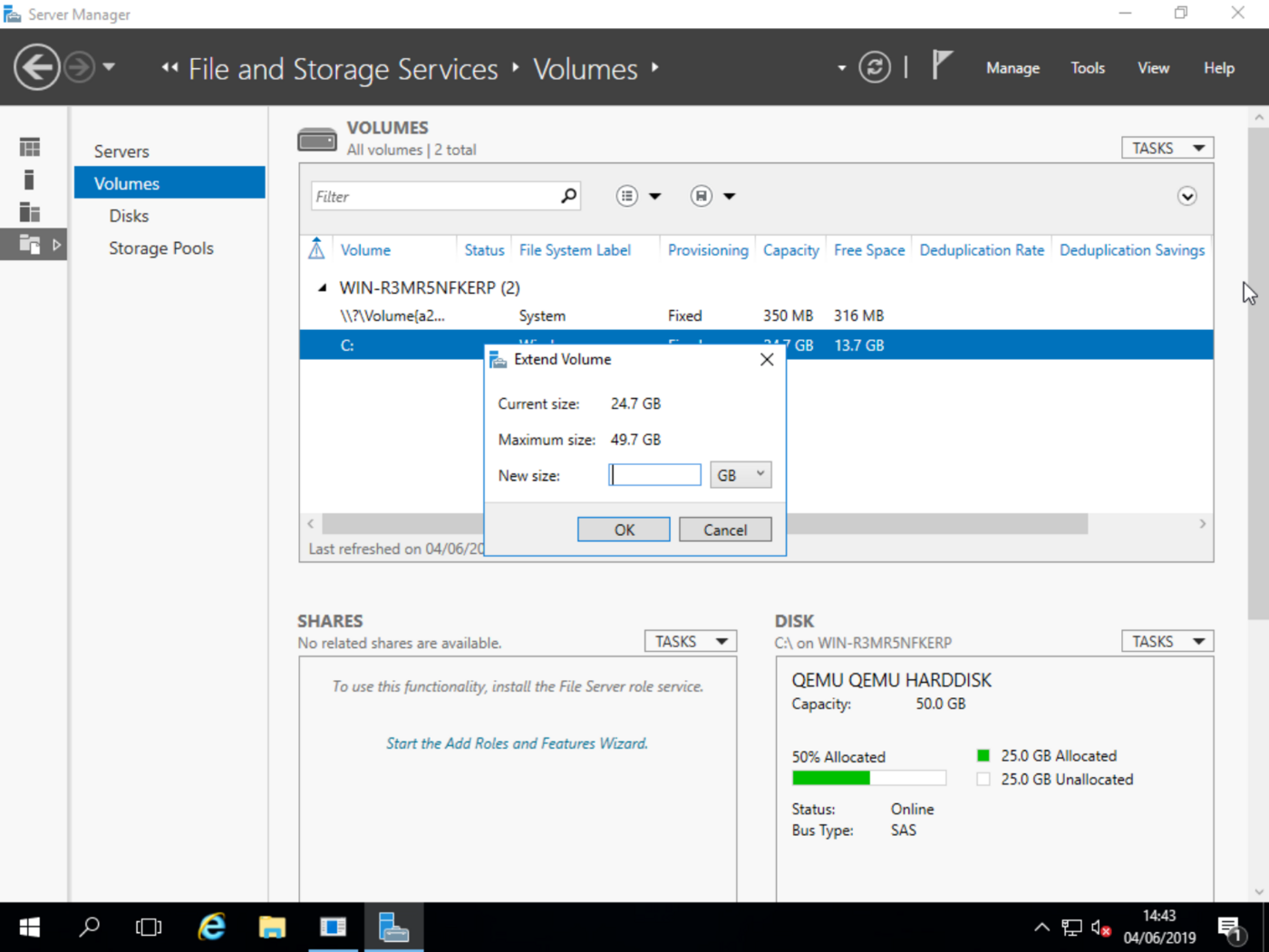

Windows
Access File and Storage Services
You can find this in the Server Manager:
Resize the volume
Right click on the C: volume and select Extend Volume....
You will then be prompted to choose your new volume size:
Set New Volume Size
Enter your desired size and click OK. Your volume will now be extended.
