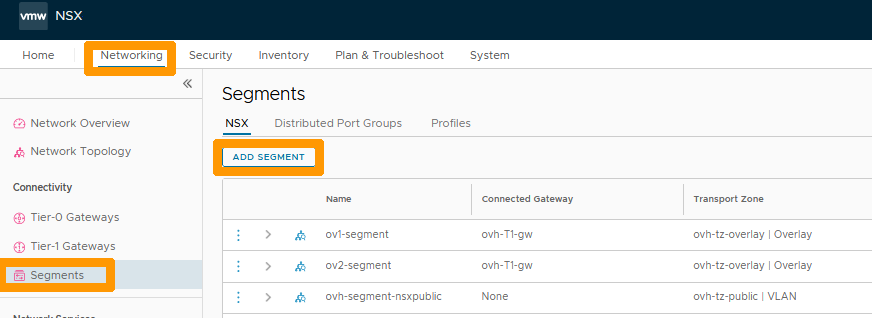

Creating a segment in the NSX interface
We will create an Overlay-backed segment connected to ovh-T1-gw in a subnet in 192.168.1.0/24 with gateway 192.168.1.254.

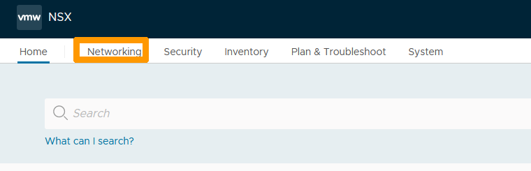

From the NSX interface go to the Networking tab.
01 Create Segment 01
Click on Segments on the left.
01 Create Segment 02

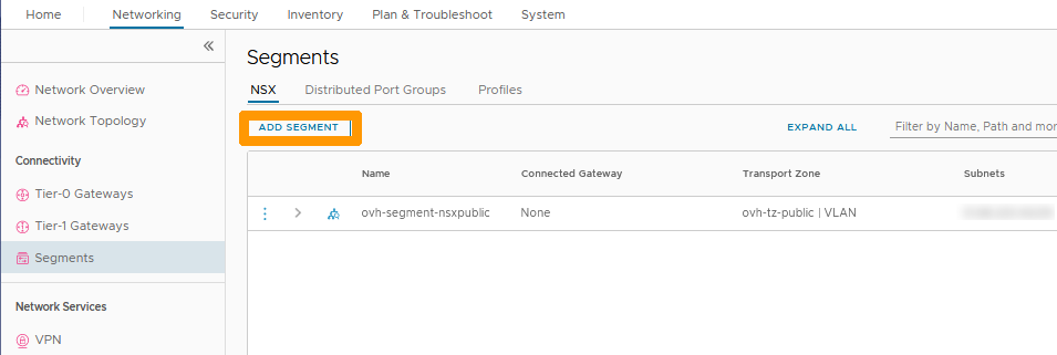

Click on ADD SEGMENT on the right.
01 Create Segment 03
Fill-in this information:
  • Name: Your segment name.
  • Connected Gateway: Predefined gateway ovh-T1-gw | Tier1.
  • Transport Zone: ovh-tz-overlay predefined zone.
  • Subnet: The gateway address of the segment in this format 192.168.1.254/24.

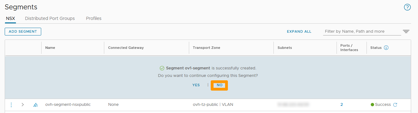

Then click on SAVE on the right.
01 Create Segment 04
Click NO when prompted.

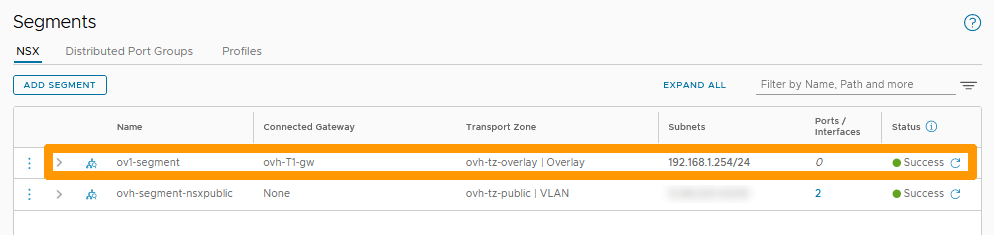

01 Create Segment 05
The new segment appears in the list.
01 Create Segment 06

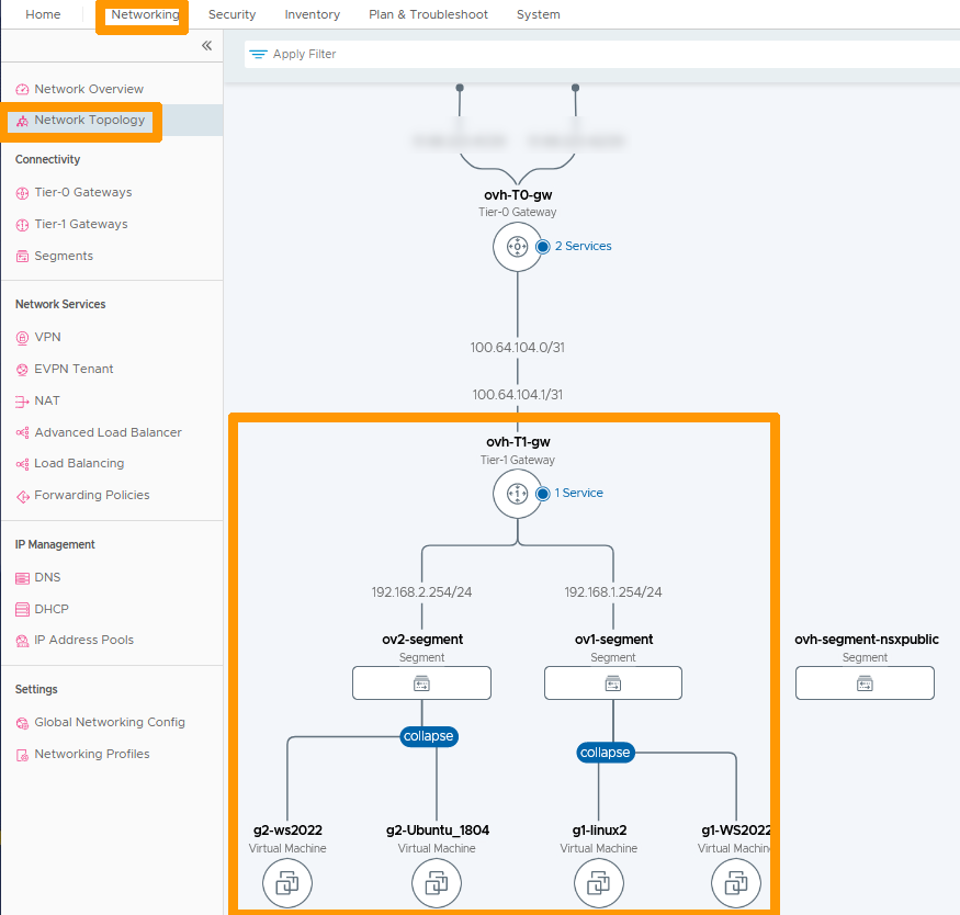

In the Networking tab, click on Network Topology on the left to see the new segment and its location in the network.
02 Display Network Topology 01

Now that your virtual machine is connected to the segment, go back to the NSX interface.
Go to the Networking tab, choose Network Topology.
04 display network topology with one segment and one vm 01
The virtual machine associated with the network appears in the network topology.

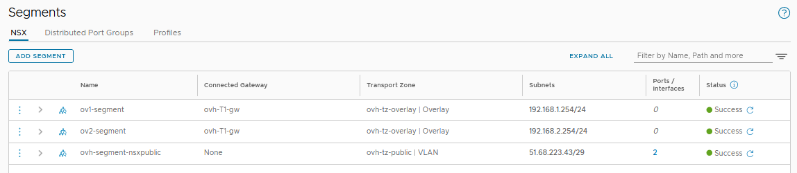

Use the first part of the guide to create a second segment named ov2-segment with these parameters 192.168.2.254/24 in order to have two segments connected to ovh-T1-gw.
05 display four VM on two segment01
Then, from the vCenter console, put two virtual machines on the first segment and two more on the second segment.
Return to the NSX interface in Network Topology to bring up the new network configuration.
05 display four VM on two segment02
Both segments are connected to the gateway ovh-T1-gw. Routing between the two subnets is enabled without any network restrictions by default.

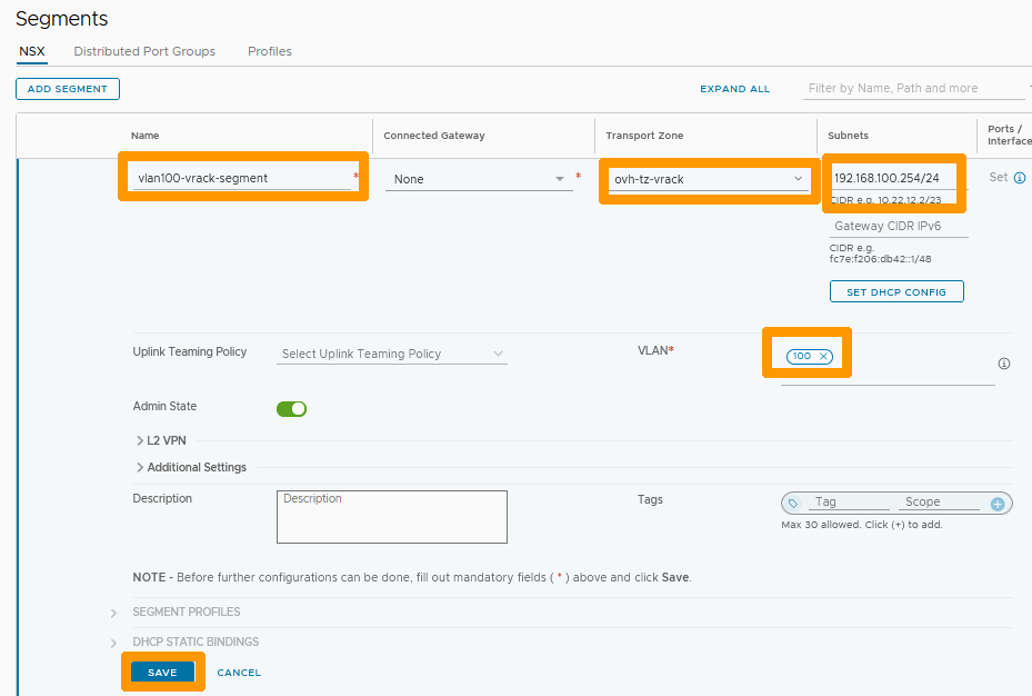

Through the NSX interface, click on the Networking tab and click on Segments on the left in the Connectivity section. Then click ADD SEGMENT.
06 Add vlan segment 01
Fill in this information :
  • Name : Type vlan100-vrack-segment.
  • Transport Zone : Select ovh-tz-vrack.
  • VLAN : Write the number 100.

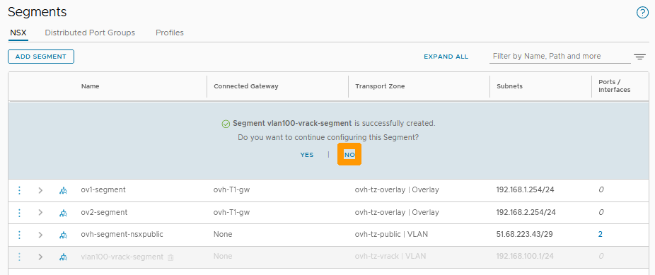

  • Subnets : Enter the gateway address and range on this segment 192.168.100.254/24
Then click SAVE.
06 Add vlan segment 02
06 Add vlan segment 03

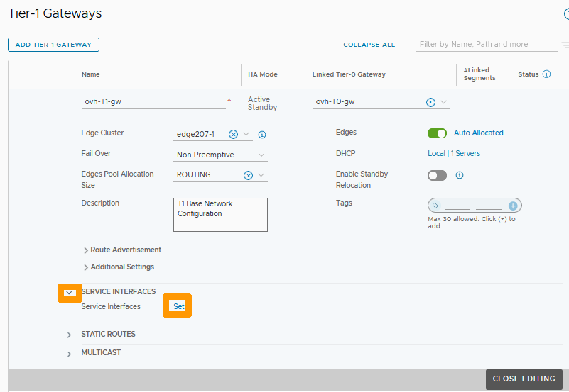

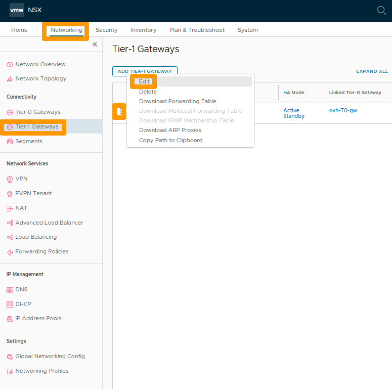

Through the NSX interface go to the Networking tab and click on Tier-1 Gateways on the left in the Connectivity section.
Then click on the three vertical points and choose Edit from the menu.
07 add interfaces to ovh-T1-gw with vlan 01

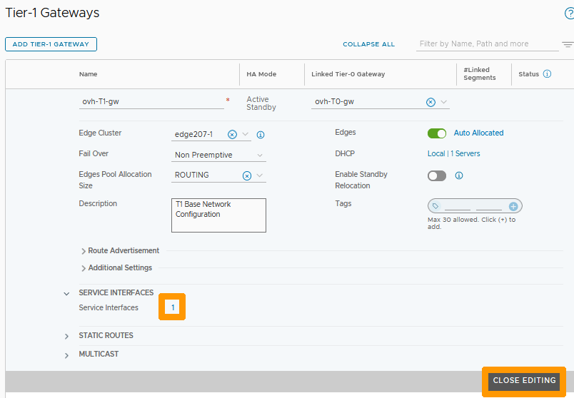

Click on the Down Arrow to the left of SERVICE INTERFACES and click the Set button that just appeared to the right of Service Interfaces.
07 add interfaces to ovh-T1-gw with vlan 02

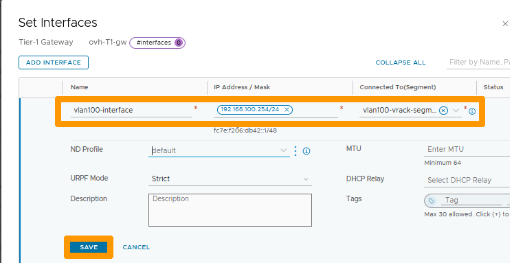

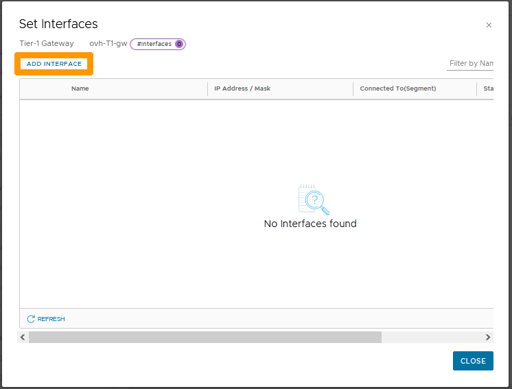

Click ADD INTERFACE.
07 add interfaces to ovh-T1-gw with vlan 03
Choose this information :
  • Name : Type vlan100-interface as the name of your interface.
  • IP Address / Mask : Enter the IP address of the interface 192.168.100.254/24 that should match the gateway.
  • Connected To(Segment) : Take the segment that is on vlan 100 on the vRack named vlan100-vrack-segment.

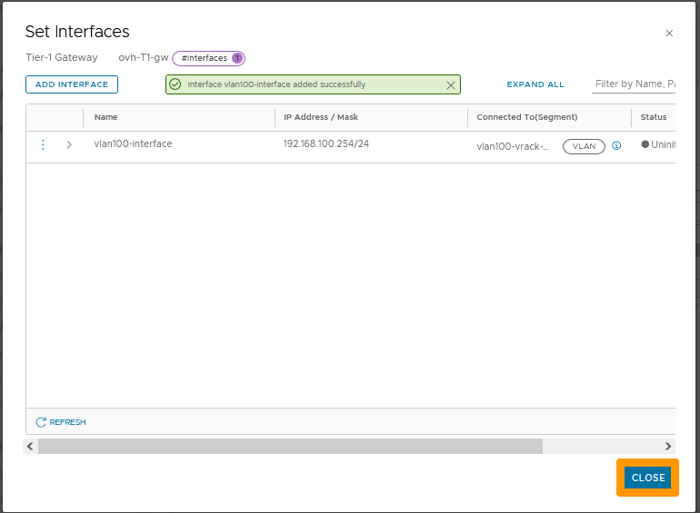

Then click SAVE to confirm the creation of the interface on ovh-T1-gw.
07 add interfaces to ovh-T1-gw with vlan 04
Click CLOSE.
07 add interfaces to ovh-T1-gw with vlan 05
The number 1 next to Service Interfaces indicates that the interface is created, click CLOSE EDITING to complete the creation of the interface.
You can now connect outside this segment through the interface with gateway 192.168.100.254/24.

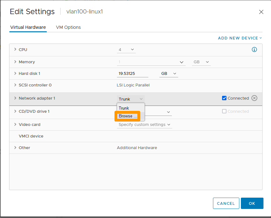

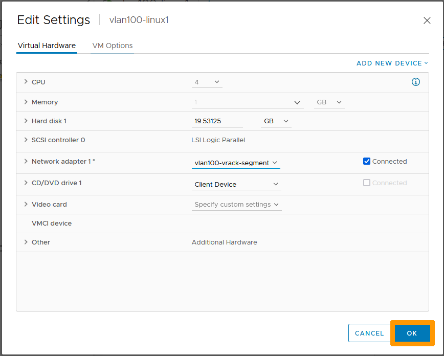

Assigning a VLAN Segment to a Virtual Machine

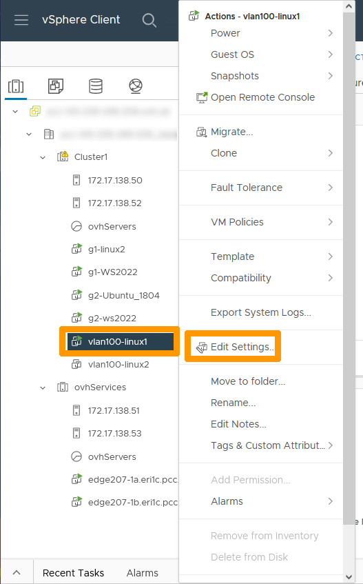

Go to your vSphere interface; right-click your virtual machine and choose Change settings.
08 connect VM to VLAN segment 01
Go to your network adapter and click Browse.

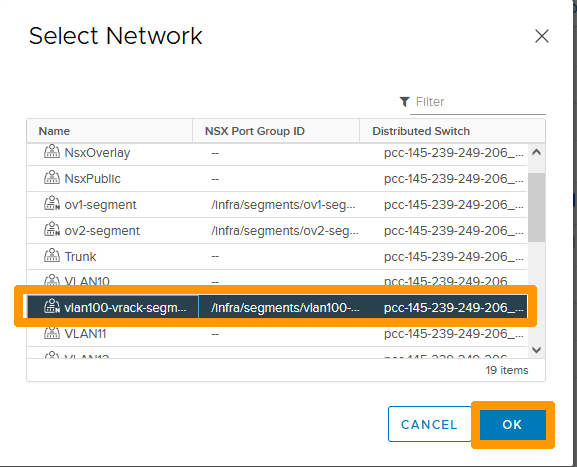

08 connect VM to VLAN segment 02
Click the segment associated with your VLAN and click OK.
08 connect VM to VLAN segment 03
Click OK to commit the changes.
08 connect VM to VLAN segment 04

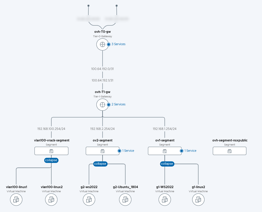

Displaying a network topology with overlay segments and other segments on VLANs
Go back to the NSX interface, go to the Networking tab and click on Network Topology on the left to view a graphical view of the network. You will see networks of type Overlay and those of type VLAN connected through an interface on ovh-t1-gw.
