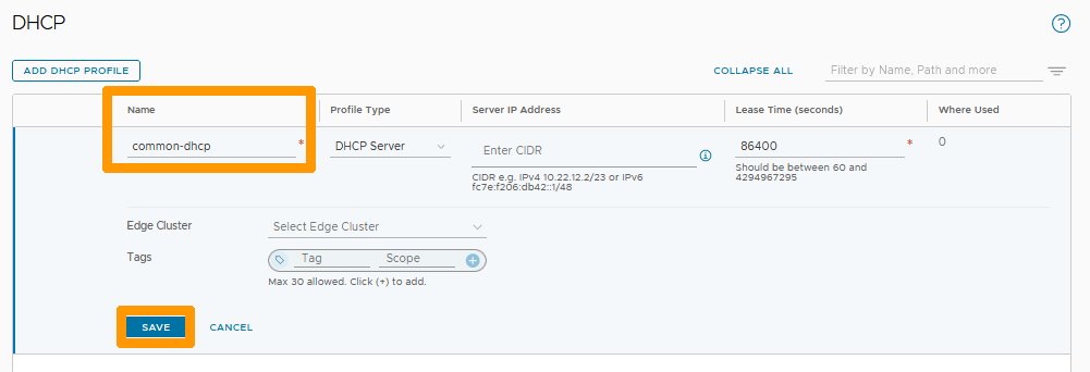

Through the NSX interface, go to the Networking tab and click on Networking Profiles on the left in the Settings section. Then go to the DHCP tab and click ADD DHCP PROFILE.
01 Common DHCP configuration 01
Type Name in Name and click SAVE.

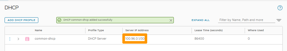

The DCHP server is active, it uses a network in 100.96.0.1/30, do not use this network in one of your segments.

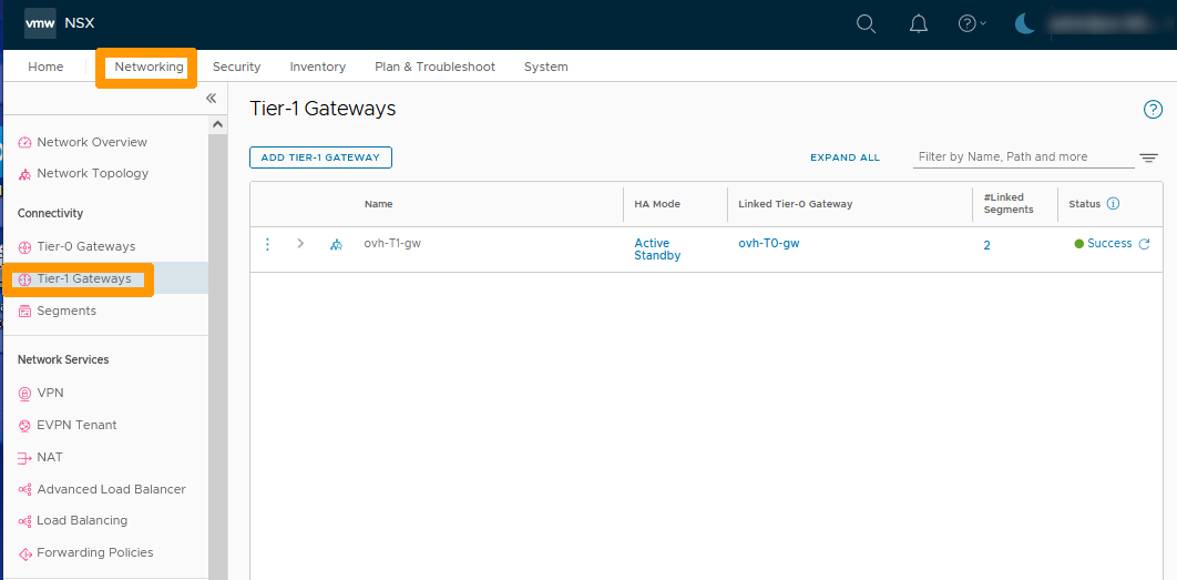

In the Networking tab, click on Tier-1-Gateways on the left in the Connectivity section.
02 Attach DHCP to OVHT1 GATEWAY 01

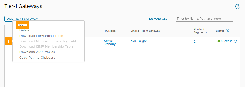

Click the three vertical dots and choose Edit from the menu.
02 Attach DHCP to OVHT1 GATEWAY 02

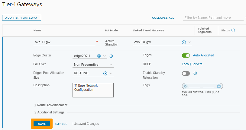

Choose DHCP Server from Type and your DHCP profile from DHCP Server Profile. Then click SAVE.
02 Attach DHCP to OVHT1 GATEWAY 04
Click SAVE.

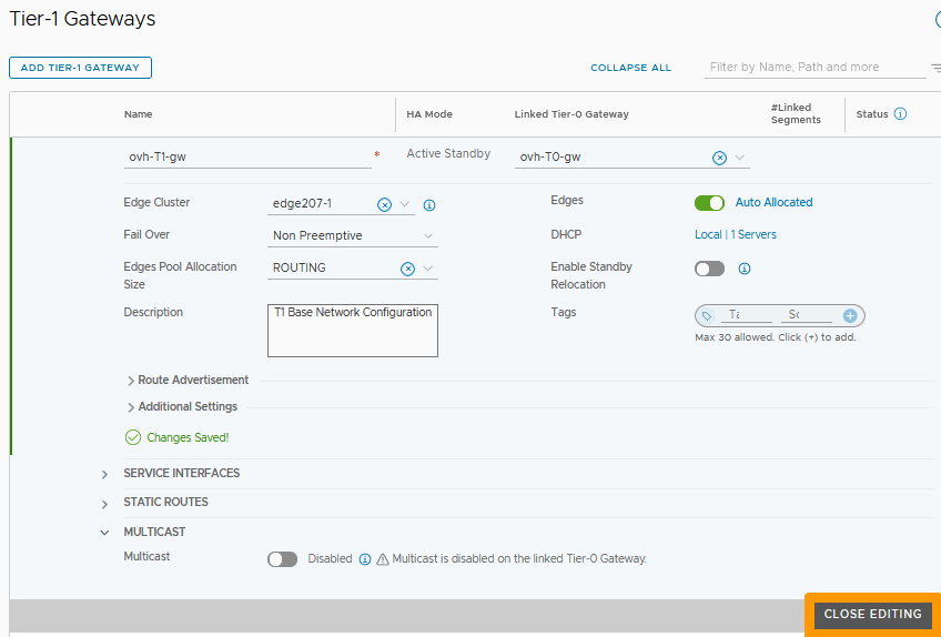

Click CLOSE EDITING.

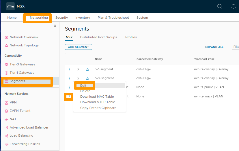

From the NSX interface, go to the Networking tab and click on Segments on the left in the Connectivity section.
Go to the Segments section, click on the configuration icon indicated with three vertical dots to the left of your segment and choose Edit.

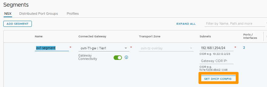

Click Set DHCP CONFIG.
03 add DHCP ON Segment 02

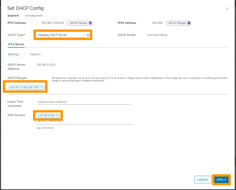

Fill in this information :
  • DHCP Type : Leave DHCP Server Gateway.
  • DHCP Ranges : Enter your range 192.168.1.10-192.168.1.200.
  • DNS Servers : Add OVHcloud DNS server 213.186.33.99.
Click on APPLY.
03 add DHCP ON Segment 03

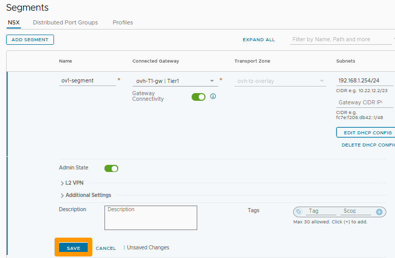

Click SAVE.
03 add DHCP ON Segment 04

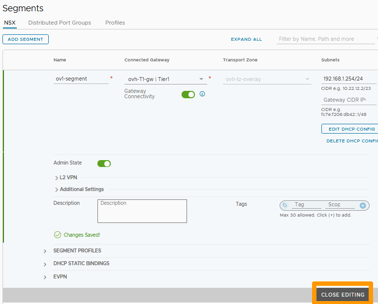

03 add DHCP ON Segment 05
Virtual machines in this segment can now be configured with DHCP.

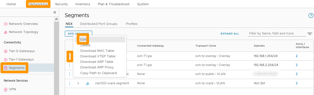

Go to the Networking tab, click on Segments on the left in the Connectivity section, then click on the three vertical dots on the left of your VLAN segment and choose Edit from the menu.
04 Configure DHCP fo VLAN SEGMENT 01

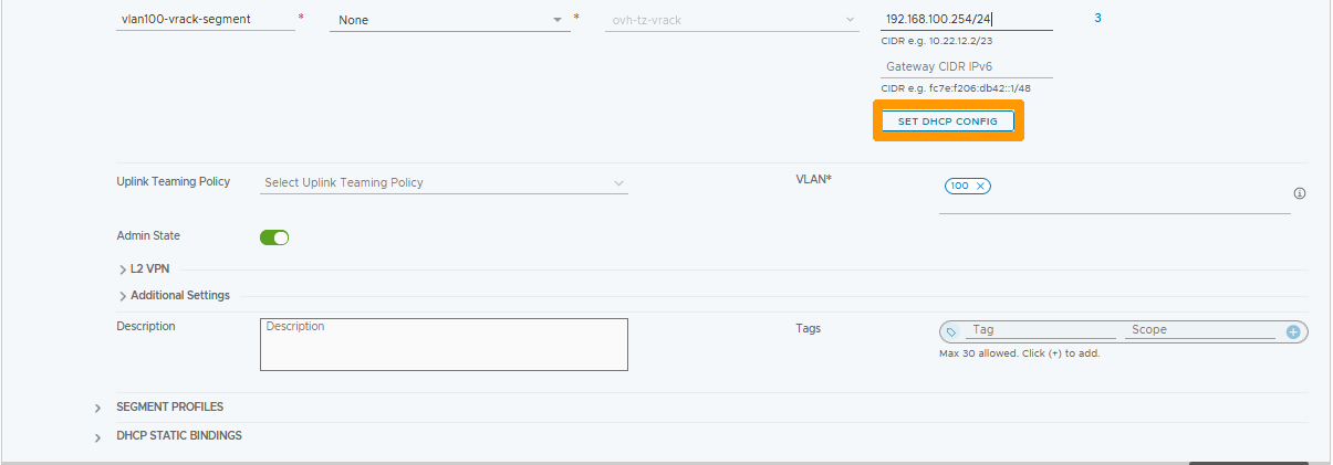

Click SET DHCP CONFIG.
04 Configure DHCP fo VLAN SEGMENT 02

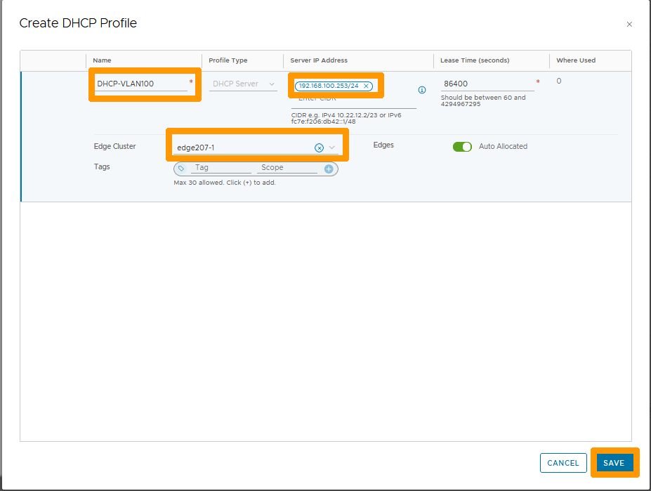

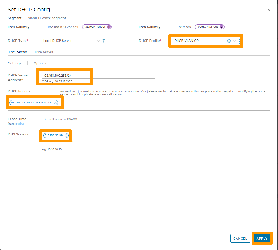

Leave Local DHCP Server in DHCP Type, click the three vertical dots to the right of DHCP Profile and choose Create New from the menu.
04 Configure DHCP fo VLAN SEGMENT 03
Enter this information :
  • Name: Leave DHCP-VLAN100.
  • Server IP Address : IP address of DHCP server 192.168.100.253/24.
Then select your Edge Cluster and click SAVE.
04 Configure DHCP fo VLAN SEGMENT 04
Verify in DHCP Profile that the profile is present and enter this information :
  • DHCP Server : DHCP server address 192.168.100.253/24.
  • DHCP Ranges : DHCP Server range 192.168.100.10-192.168.100.200.
  • DNS Servers : OVHcloud DNS server IP address 213.186.33.99.
Then click APPLY.
04 Configure DHCP fo VLAN SEGMENT 05

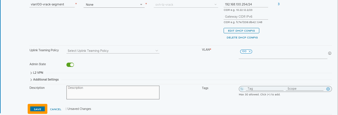

Click SAVE.
04 Configure DHCP fo VLAN SEGMENT 06

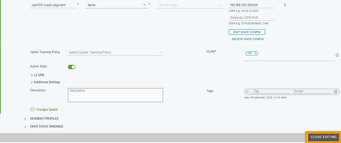

04 Configure DHCP fo VLAN SEGMENT 07
The DHCP server is active on this VLAN segment.
