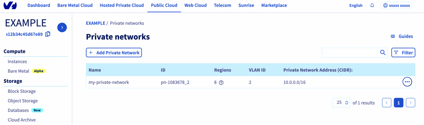

Setting up the vRack
First of all, we will need to set up vRack Private Network for our Public Cloud. To do it, we follow the Configuring vRack for Public Cloud guide. Once you have created a vRack and added it into a Private Network, you can continue.
Setting-up the vRack
As explained in the Known limits guide, the following subnets are not compliant with the vRack feature and can generate some incoherent behaviours with our used overlay networks:
10.2.0.0/16 # Subnet used by pods
10.3.0.0/16 # Subnet used by services
172.17.0.0/16 # Subnet used by the Docker daemon

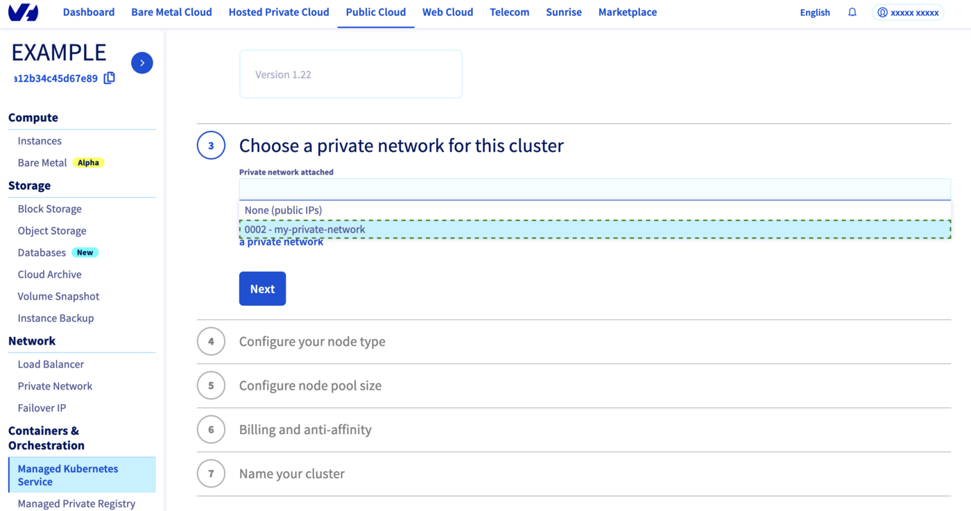

Then we create a Kubernetes cluster, as explained in the Create a cluster guide. Integrating a cluster into a vRack Private Network must be done at the third step on cluster creation, when we can choose an existing private network for the cluster:
Choose a private network for this cluster
Our new cluster will be created inside the vRack Private Network we have chosen.

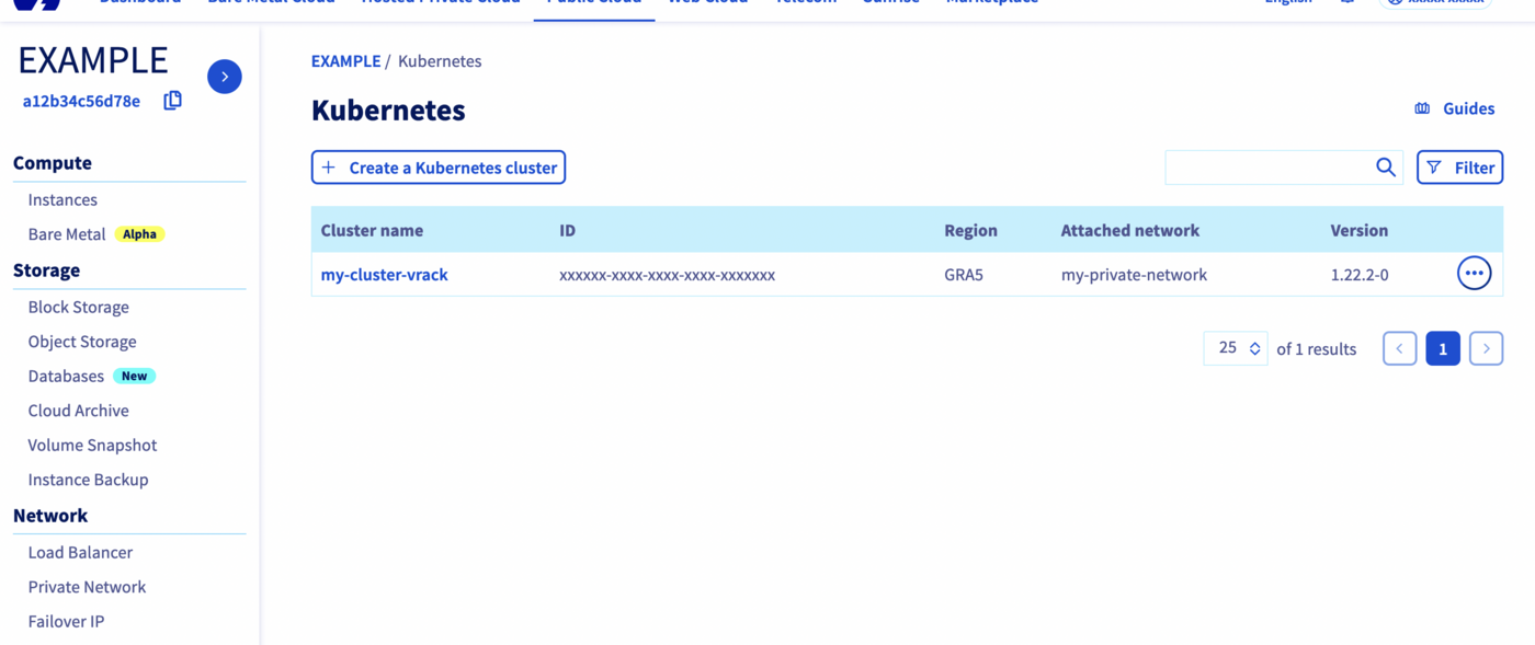

In the Managed Kubernetes Service Dashboard, we can see the cluster, with the chosen private network in the Attached network column:
Private network information in Attached network column

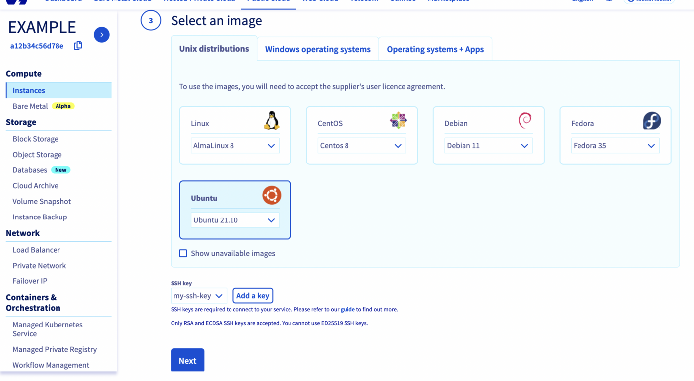

Now we can create a new Public Cloud instance inside the vRack, by following the Integrating an instance into vRack guide.
We are going to create an Ubuntu instance:
Setting-up PCI - Ubuntu instance

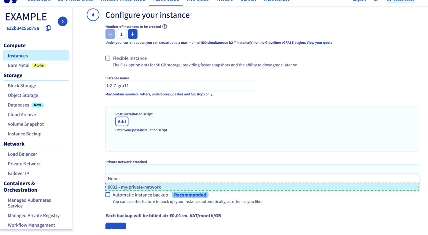

In the fourth step of creation, we attach it to the private network we created before:
Setting-up PCI - Attaching to a private network

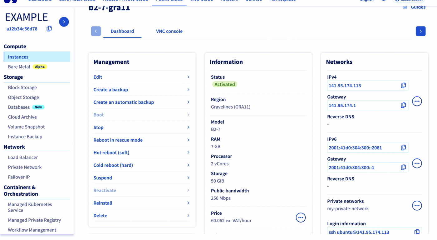

After instance creation, click on the name of the newly created instance, and then scroll down a little in order to see the connection details in the OVHcloud Control Panel.
Setting-up PCI - SSH connection information
If we log in to the instance using SSH, we can see that it has two network interfaces, one attached to the public IP address we used to log in, the other attached to the private network:

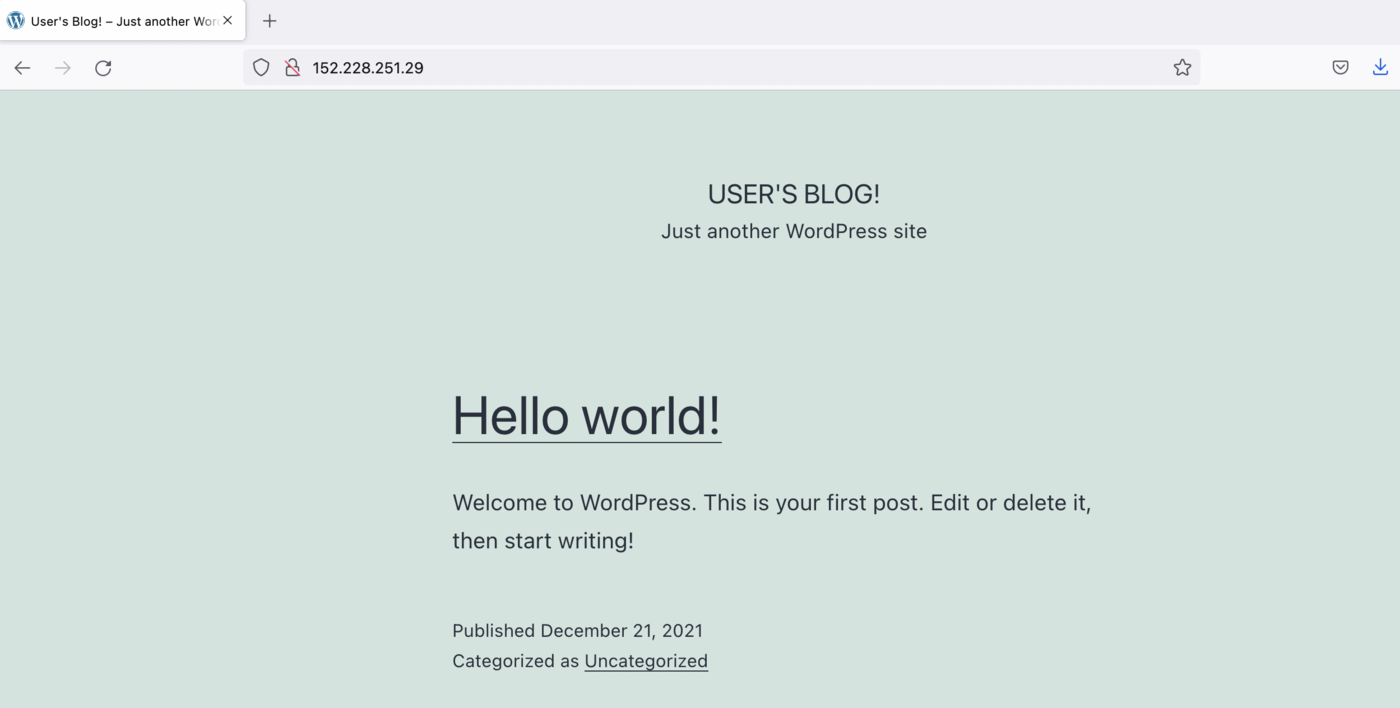

Then we can follow the instructions to get the Admin URL:
export SERVICE_IP=$(kubectl get svc --namespace default my-first-k8s-wordpress --template "{{ range (index .status.loadBalancer.ingress 0) }}{{.}}{{ end }}")
$ echo "WordPress URL: http://$SERVICE_IP/"
WordPress URL: http://152.228.251.29/
$ echo "WordPress Admin URL: http://$SERVICE_IP/admin"
WordPress Admin URL: http://152.228.251.29/admin
And putting the URL in the browser will take us to the new blog, accessing the MariaDB database from the PCI instance via the vRack.
Setting-up WordPress
