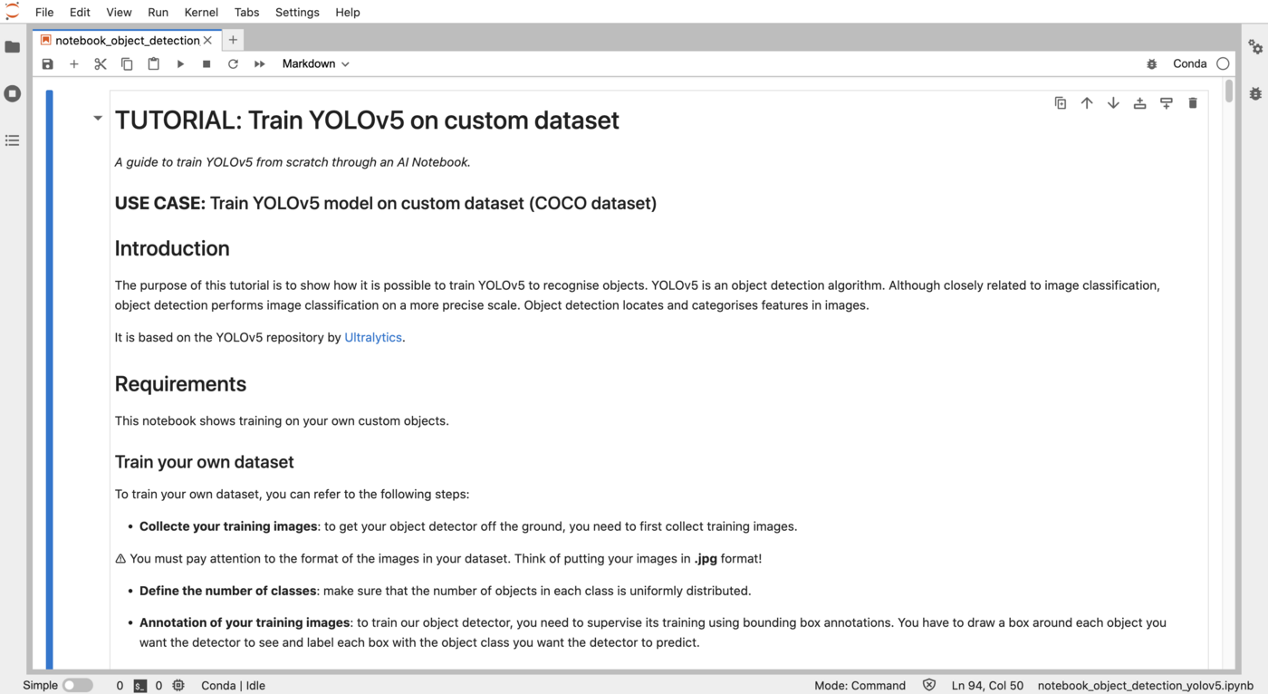

Once the repository has been cloned, find the YOLOv5 notebook by following this path: ai-training-examples > notebooks > computer-vision > object-detection > miniconda > notebook_object_detection_yolov5.ipynb.

Experimenting YOLOv5 notebook
Once your dataset is ready and uploaded, you are able to train the YOLOv5 model of your choice!
A preview of this notebook can be found on GitHub here.
