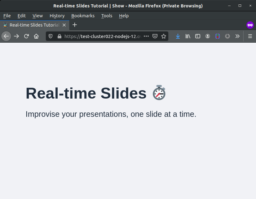

Then restart your instance and your slideshow platform will be online.
Slideshow
