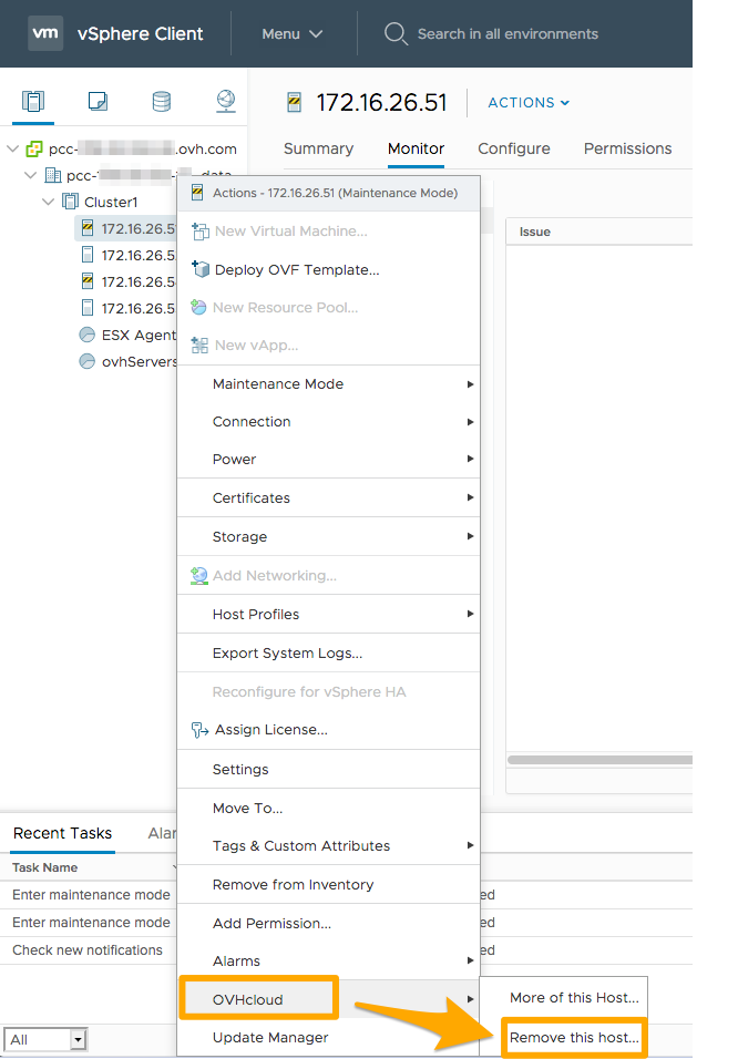

The host server is now in maintenance mode. Right-click on it, then click OVHcloud and Remove OVHcloud host.
Remove host

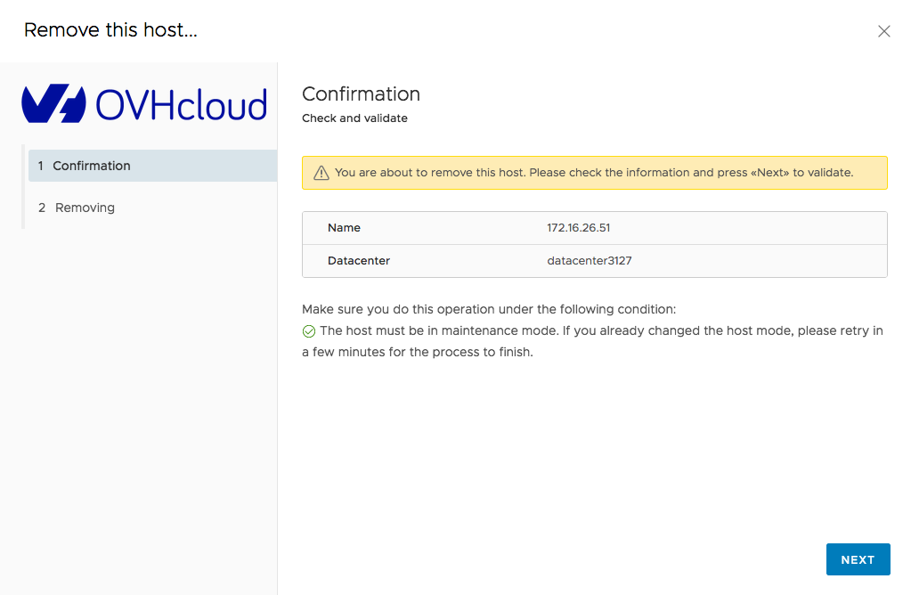

Finally, in the window that appears, confirm that you wish to remove it by clicking Next.
Confirm removal

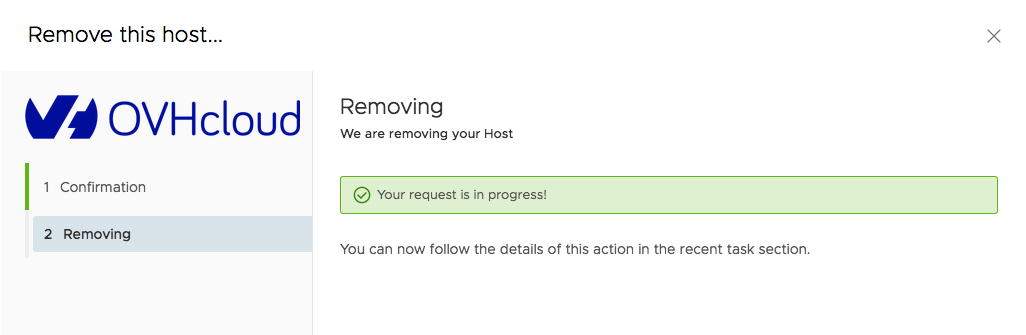

The removal request will then be processed.
Confirm removal

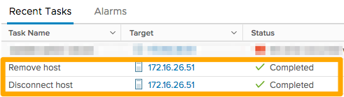

You can track the progress of the host server removal in Recent Tasks.
Removal task monitoring
Within a few minutes, the host server you have removed will no longer appear.
