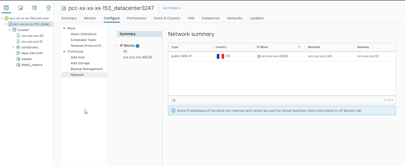

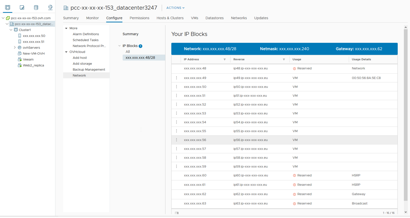

Retrieve your information
You can retrieve the information of your public IPv4 address block directly from the vSphere client, by going to the Hosts and clusters section. Then click on your datacentre and choose the Configure tab. Then click Network below OVHcloud.
Configuration on the OVHcloud Network
On each block delivered by OVHcloud, 5 IP addresses are reserved for network configuration and should never be used for your virtual machines. This is the first and the last four IPs in the block. A Private Cloud IP block is organized as follows:
  • The first IP address marked as reserved corresponds to the network address.
  • The following IPs can be used for your virtual machines. They are marked as Available if no VM is using them, or as Used if they are being used.
  • The last four IPs in the block are reserved, two are dedicated to OVHcloud routers for operating the block, and the other two are used for gateway and broadcast.

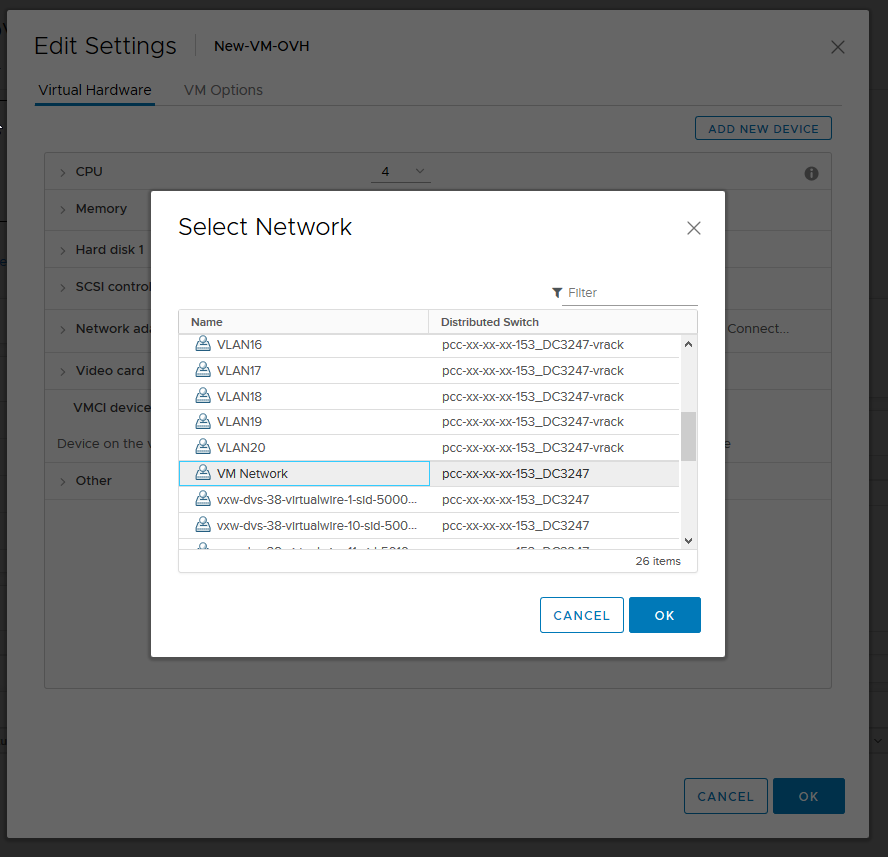

Configure a public IP address

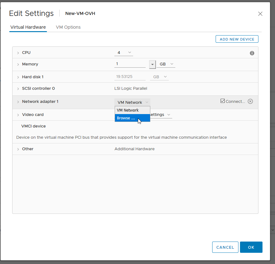

To configure a public IP address on your virtual machine, you must first choose the VMNetwork interface in your VM network adapter settings:
VMNetwork

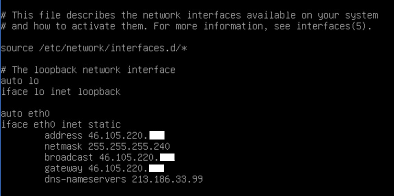

Here is an example of a configuration on the Debian distribution:
IP Interface
auto eth0
iface eth0 inet static
address 46.105.220.xxx
netmask 255.255.255.240
broadcast 46.105.220.xxx
gateway 46.105.220.xxx
dns-nameservers 213.186.33.99
Restart your network system with systemctl restart networking.
You can check the configuration with ip a.

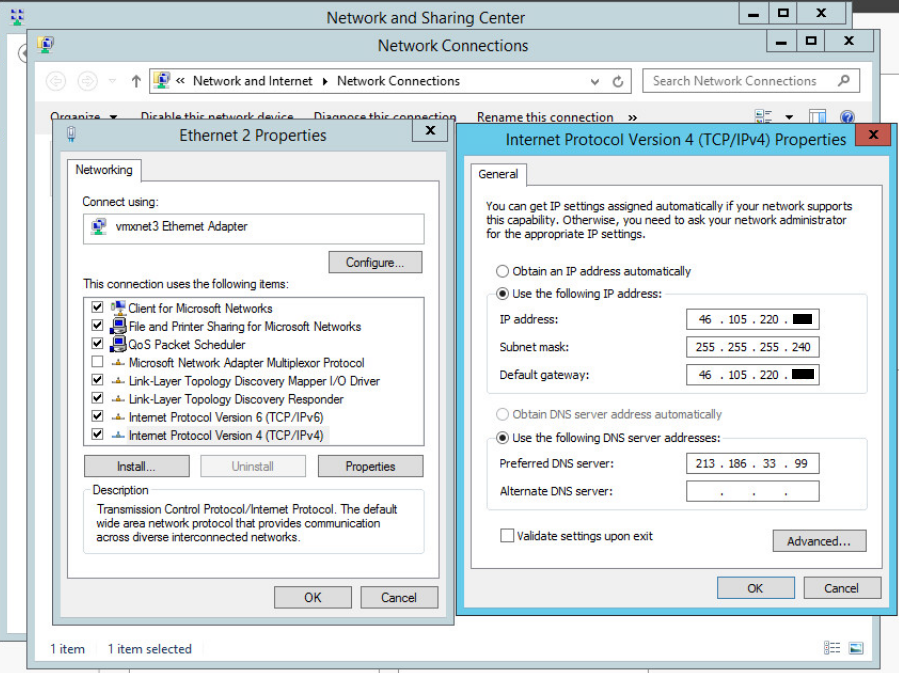

Here is an example of a configuration on Windows:
In the Control Panel, go to Network and Internet then Network and Sharing Center and then Modify the network adapter.
To go faster, you can click on the Windows search field and write Run (which corresponds to simultaneously pressing the Windows key and the R key of your keyboard). The Windows command console will open, and you can enter the following command:
ncpa.cpl
Then right-click the network adapter corresponding to the VMNetwork and select Properties. Then select TCP/IP v4 protocol and click on Properties and enter your IP information as follows:
Windows Configuration
IP Address: 46.105.220.xxx
Subnet Mask: 255.255.255.240
Default Gateway: 46.105.220.yyy
DNS Server: 213.186.33.99

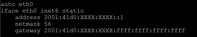

Here is an example of a network configuration on the Debian distribution:
IPv6 Interface
auto eth0
iface eth0 inet6 static
address 2001:41d0:xxxx:xxxx::
netmask 56
gateway 2001:41d0:xxxx:xxxx:ffff:ffff:ffff:ffff

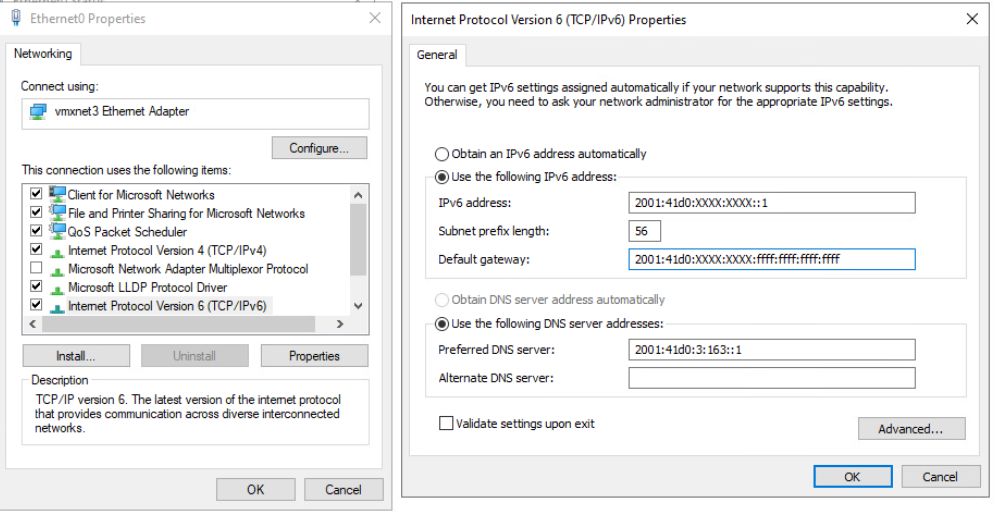

ncpa.cpl
Windows IPv6 Configuration
IP Address: 2001:41d0:xxxx:xxxx::
Subnet Mask: 56
Default Gateway: 2001:41d0:xxxx:xxxx:ffff:ffff:ffff:ffff
DNS Server: 2001:41d0:3:163::1

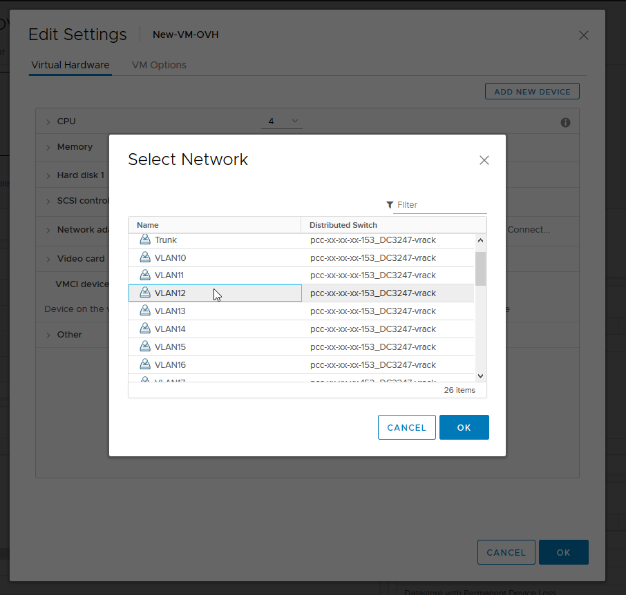

Configure a private IP address

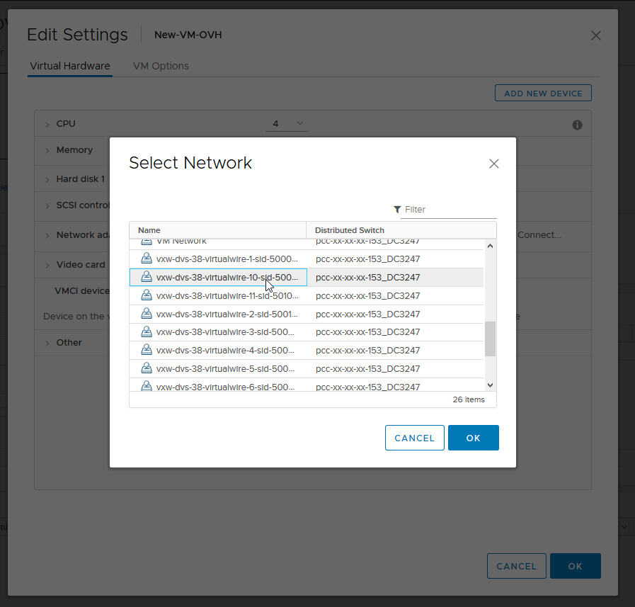

The process for configuring a private IP address is similar to that of a public IP address. However, you must use the network adapter configured for your VLAN or VxLAN.
In your interface options, you can edit the following settings:
  • A VLAN interface (10 to 20 by default and linked to the vRack, you can create more by consulting this guide).
  • A VxLAN interface (vxw-dvs, etc.).
In your virtual machine settings, you can use a VLAN or a VxLAN:
VLAN for SDDC
VLAN for SDDC
VXLAN on the Private Cloud

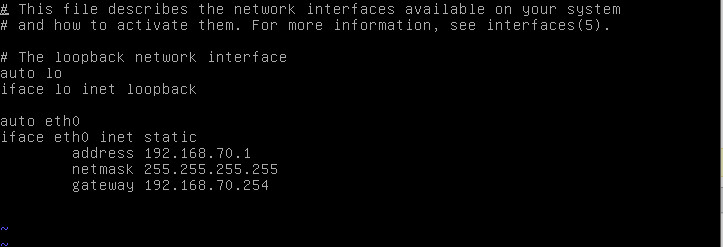

Here is a configuration example on a Debian operating system:
Private IP address on Linux
By editing the interfaces file, you can assign a private IP address on your chosen IP range:
auto eth0
address 192.168.70.1
netmask 255.255.255.0
gateway 192.168.70.254

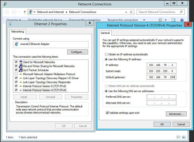

Here is a configuration example for Windows:
In the configuration panel, go to Network and Internet, then Network and Sharing Centre, and then to Change Network Adapter.
To speed up the process, you can click on the Windows search field and write Run (or press the Windows and R keys at the same time). The Windows command console will open, and you can enter this command:
ncpa.cpl
Right-click on the corresponding VMNetwork adapter and click Properties. Then select TCP/IPv4 protocol and click again on Properties, then enter your IP information as follows:
Configure a public IP address on Windows
By modifying this interface, you can assign a private IP address on your chosen IP range:
IP address: 192.168.70.2
Subnet mask: 255.255.255.0
Default gateway: 192.168.70.254
