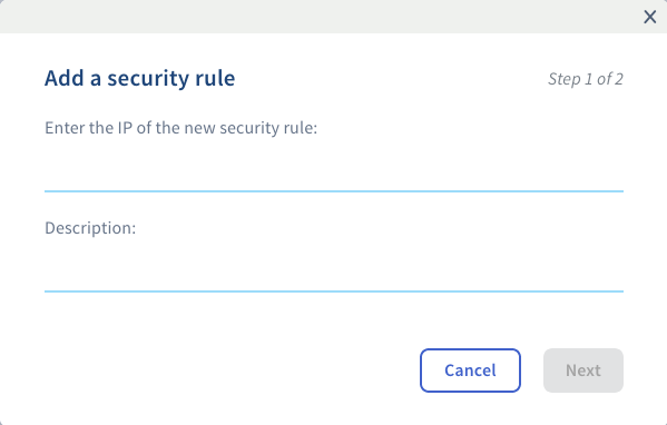

In the new Window, enter an IP address (range) that should be allowed access. You can also add a description to make the organisation of the whitelist easier.
vCenter
Click on Next when you have filled in the fields, then click on Confirm to apply your changes. Connections from this IP address (range) will now be possible.
