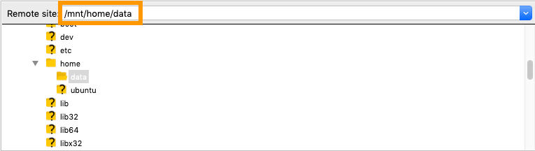

The server's file system will be located in the directory you have defined as the mount point in rescue mode ("/mnt" in this example).
remote site sftp rescue mode

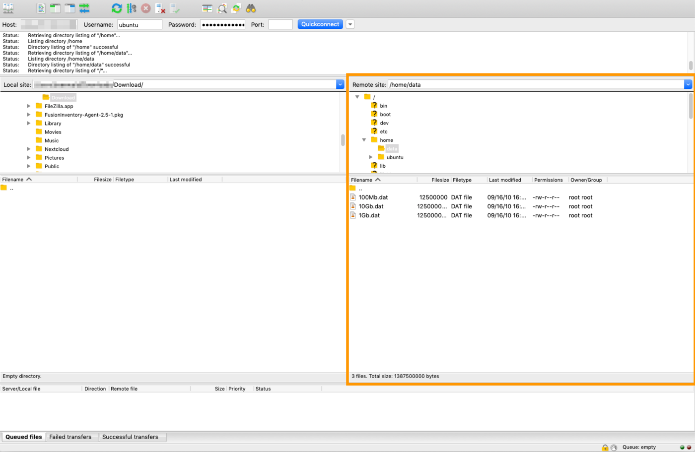

Once the remote connection is established, a tree-view of the server's files will be displayed in the Remote Site section.
remote site sftp
The middle section of the FileZilla interface acts as a file explorer. You can select multiple files or folders, delete them, drag and drop them from one side to the other, etc. Since the usage details might be different, depending on the software version and your local operating system, refer to the FileZilla user guide for details.
For example, to retrieve files located in the folder "/home/data" of the server, open this folder in the right-hand pane (Remote Site). Select the files or folders to download and drag them to the left-hand pane (Local Site) into a folder of your local device.

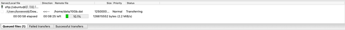

The progress of the data transfer will then be displayed in the transfer queue section at the bottom.
sftp transfer progress
