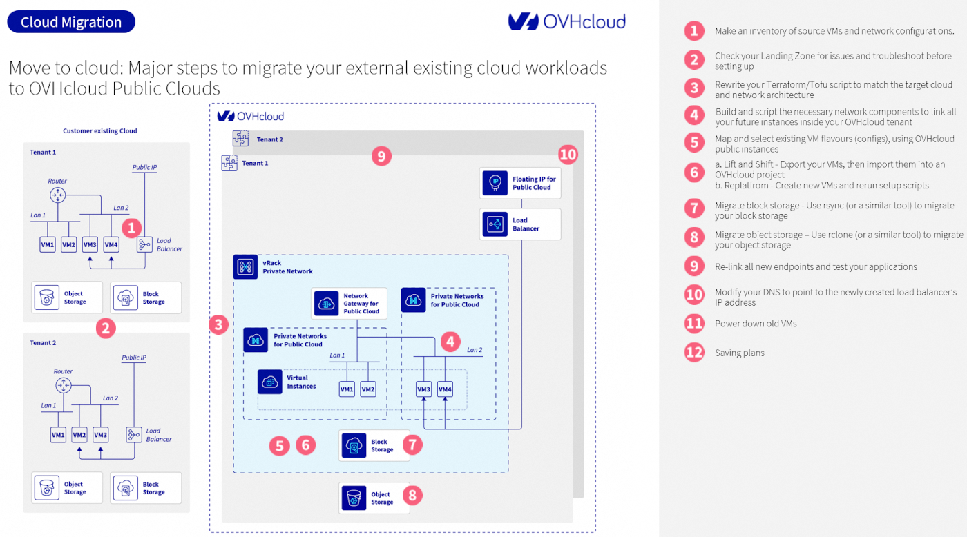

Before going into detail on the major steps, the diagram below provides an overview of the main phases of a migration to OVHcloud Public Cloud.
IAAS migration schema
1. Inventory your source VMs, storage and network configuration
Before starting your cloud migration, it’s crucial to create a detailed inventory of all your current resources:
  • Virtual Machines (VMs): List all your VMs, grouping those that belong to the same application (for example: a web server, an application server, and a database). This approach helps you migrate applications one at a time, minimizing service disruptions.
  • Storage: Identify your block storage volumes as well as your object storage buckets.
  • Network resources: Map out your entire network topology, including Layer 2 (L2) and Layer 3 (L3) network layouts, routers, load balancers, and firewalls.
Also, list your subnets and associated VLAN IDs. This information will be essential to correctly set up your target network within the OVHcloud Public Cloud environment.
With OVHcloud’s vRack feature, you can create over 4000 VLANs and keep your existing IP addressing plan. This greatly simplifies network migration and avoids potential conflicts or the need to renumber IPs.

6. Choose and execute your VM migration strategy
6a. Perform a Lift and Shift migration
The Lift and Shift method allows you to migrate your existing virtual machines (VMs) without making significant changes to their configuration or architecture. It’s a fast way to move workloads to the OVHcloud Public Cloud with minimal reengineering.
To begin, export your source VMs from your current infrastructure. OVHcloud supports several image formats, including: ami, ari, aki, vhd, vmdk, raw, qcow2, vhdx, vdi, iso, and ploop.
Once exported, you need to upload the VM image to your OVHcloud project. To do this, make sure you have a local Python environment ready and install the OpenStack CLI (to do this, follow this installation guide). You’ll also need your API credentials to authenticate.
After uploading the image, you can deploy a new instance from it using the OVHcloud Control Panel, OpenStack CLI, or via Terraform/OpenTofu. You’ll find step-by-step instructions on how to import a VM image in our guide "Uploading your own image".
You can then connect the instance to your defined private network, attach block storage, and configure any required load balancers.
If you’re migrating several VMs, consider automating the process using scripts or infrastructure-as-code tools. You can also contact our Professional Services team to get support or delegate the migration process entirely.
6b. Perform a replatforming with clean deployments
The replatform method involves creating new virtual machines in your OVHcloud Public Cloud environment and reinstalling your applications from scratch. This is ideal if you want a cleaner setup, or to take advantage of modern automation and infrastructure tools.
You can provision new instances using your Terraform/OpenTofu stacks or directly through the OVHcloud Control Panel, selecting the appropriate regions, availability zones and instance flavours.
Once your infrastructure is deployed, two possibilities:
  • Use Ansible playbooks to automatically install and configure your applications.
  • Set up your services manually on each instance.
Be sure to use the same applications versions as in your source environment to ensure compatibility with your existing data.
Once configuration is complete, migrate your data using tools like rsync, scp, or database utilities, and validate that everything is working as expected.
7. Migrate block storage using rsync (or a similar tool)
To move your block storage to OVHcloud, start by configuring your target storage volumes. You can do this either manually on the instance or automatically using tools like Ansible.
Once your volumes are ready, use a tool such as rsync to copy data from your source infrastructure to the new OVHcloud environment. rsync ensures that files are transferred efficiently and can resume if interrupted.
This method allows you to migrate data progressively and validate it as you go.
If you need help setting up this process or automating it across multiple instances, you can contact the OVHcloud Professional Services team.
8. Migrate object storage using rclone (or a similar tool)
To transfer your object storage to OVHcloud, use a tool like rclone, which supports most S3-compatible services.
Start by ensuring you have the correct permissions to access both the source and destination buckets. Then:
  • Install rclone on your local machine or a cloud instance.
  • Configure access credentials for both environments (source and OVHcloud).
  • Use rclone sync or rclone copy to migrate your data.
This method ensures reliable and resumable transfers for large datasets. Follow our guide Object Storage - Use Object Storage with Rclone for the necessary steps.
If your setup includes versioning, lifecycle rules, or other advanced features, or if you require automation, the OVHcloud Professional Services team can help you design a tailored migration process.
After migrating, update all your applications to use the new endpoints, including those for S3-compatible object storage.
Make sure every connection points to the correct OVHcloud resources.
Then, thoroughly test your entire workflow and run all integration tests to verify that your applications works correctly in the new environment.
10. Update DNS records
Once you have confirmed that your applications are running smoothly, update your DNS records to point to the IP address of your new OVHcloud load balancer.
After making the DNS change, rerun your tests to ensure all services are fully functional and accessible.
11. Decommission legacy infrastructure
After verifying that your new OVHcloud environment is fully operational, you can safely shut down and decommission your old infrastructure.
Ensure all data and services have been successfully migrated and backed up before powering off legacy systems.
