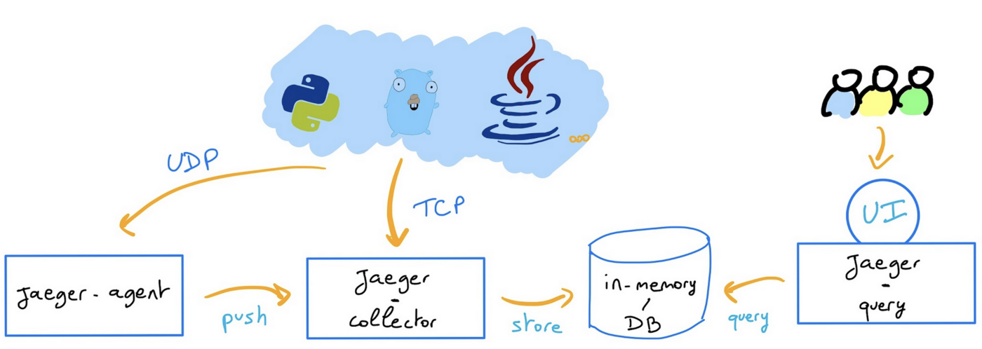

Jaeger contains several components:
Jaeger
Read more about Jaeger architecture and components.

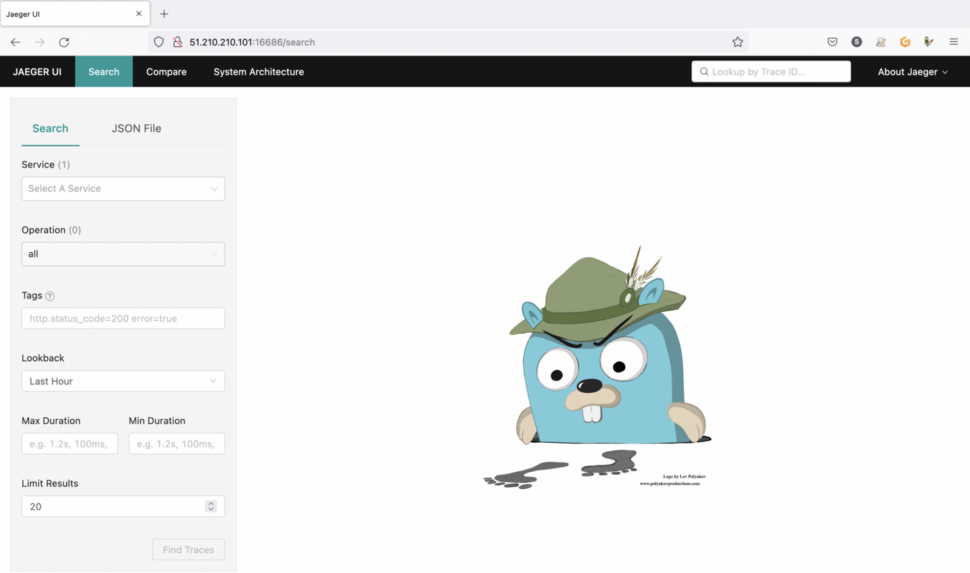

Access to Jaeger UI
Now you can retrieve Jaeger UI URL with the following command:
export JAEGER_URL=$(kubectl get svc jaeger-query -o jsonpath='{.status.loadBalancer.ingress[].ip}')
echo Jaeger URL: http://$JAEGER_URL:16686
You should obtain the following result:
$ export JAEGER_URL=$(kubectl get svc jaeger-query -o jsonpath='{.status.loadBalancer.ingress[].ip}')
$ echo Jaeger URL: http://$JAEGER_URL:16686
Jaeger URL: http://51.210.210.101:16686
Open your browser and go to the Jaeger interface.
Jaeger Query

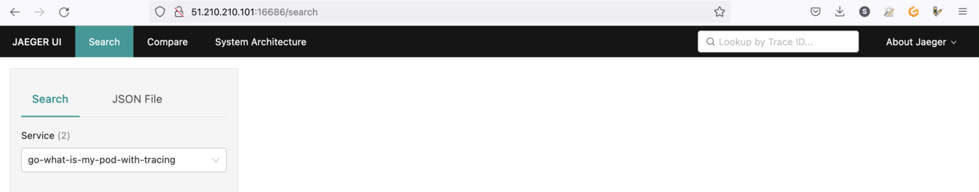

Open your browser and go back to the Jaeger interface (http://$JAEGER_URL:16686).
Jaeger query services
You should now see two available services:
  • go-what-is-my-pod-with-tracing
  • jaeger-query

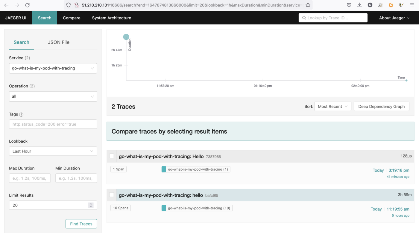

Select go-what-is-my-pod-with-tracing service and click on Find Traces button.

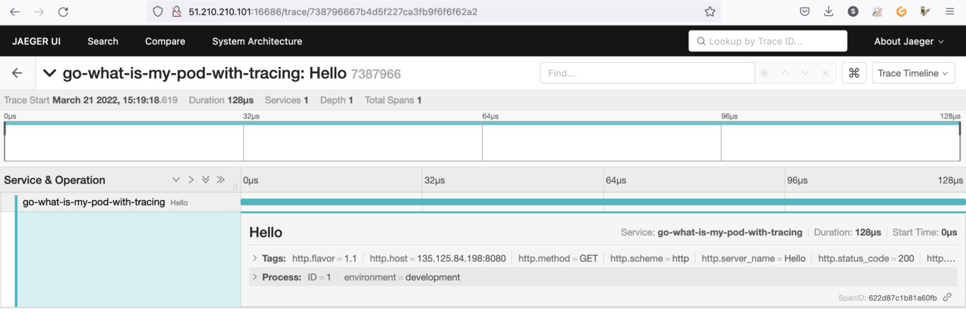

Jaeger query traces
You can now click in a trace and visualize useful information.
Jaeger query trace details
