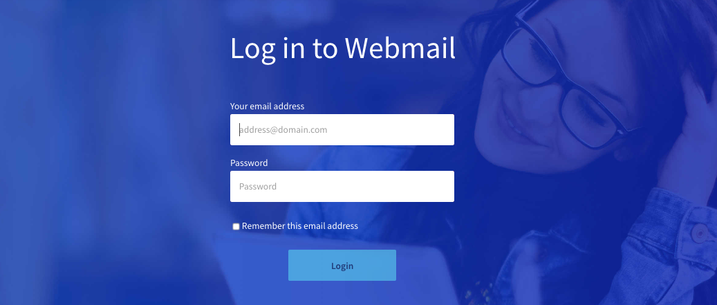

Are emails functional from webmail? (sending and/or receiving)
To ensure that the malfunction is not linked to a configuration error, send and receive a test email directly via OVHcloud webmail. If everything is working properly, check your software configuration using the guides provided.
From your computer browser or smartphone, go to the address Webmail.
I cannot log in to webmail
Make sure you have the right password. If necessary, you can modify it. Also check if two-factor authentication is enabled (Exchange only).
To change the password for an email address, please refer to our guide "Changing a password for an MX Plan email address".

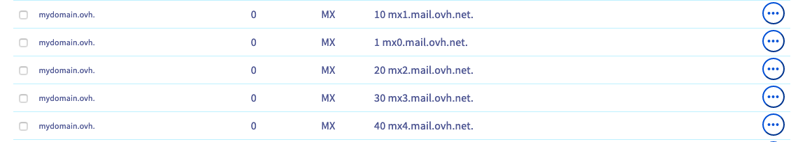

Is the domain name pointing correctly to my email service? (receiving)
Check that your domain name points correctly to the OVHcloud email servers. To do this, you will need to configure MX records in your DNS zone.
Please refer to our guide "Adding an MX record to your domain name's configuration".
To check your domain name's DNS configuration, regardless of its registrar, you can use the Zone Master tool, using our documentation "Tutorial - Using Zonemaster".
