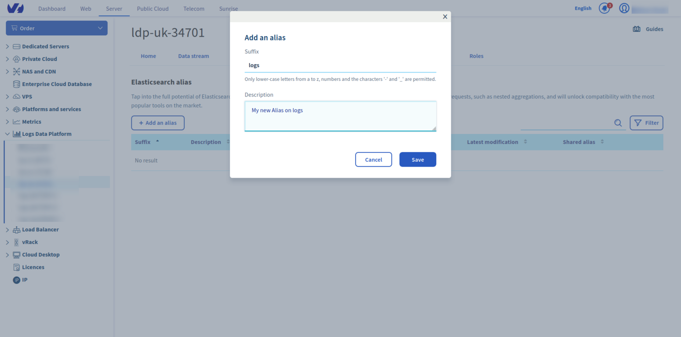

To access your logs from OpenSearch Dashboards, you will need to setup an OpenSearch Alias and link them to your Graylog streams, so here we go:
  1. In the Alias tab, click on the Add an alias button
  2. Choose a name and define a description for your alias
  3. Save the entry by clicking the Save button
  4. Once the alias has been created, use the ... menu to the right and select Attach content to the alias option.
  5. Define there the graylog streams you want to associate to your alias
  6. That's it.
Alias creation

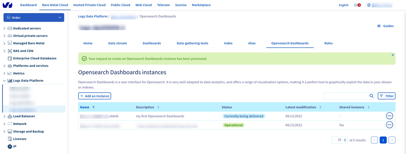

To create your OpenSearch Dashboards instance, click on OpenSearch Dashboards tab, click on Add a instance, put a description and click on Order to launch the creation of your instance. Your instance will be created and delivered in approximately 20 minutes.
osd creation

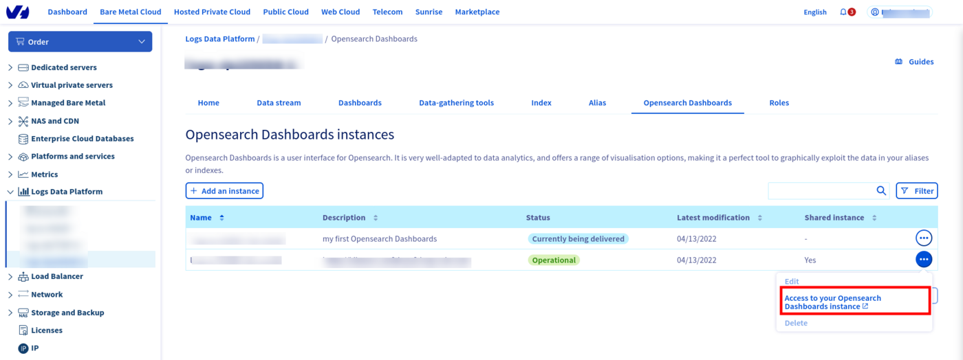

Use the ... menu to the right and select Access to your OpenSearch Dashboards instance option to be redirected.
osd access

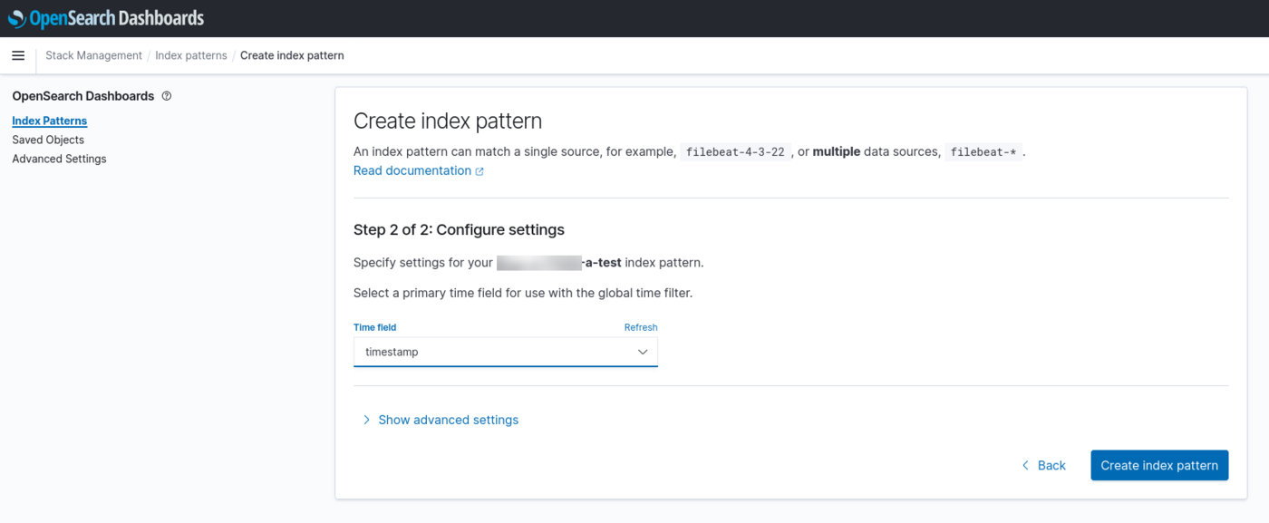

Once there, use the right Identity provider to sign in and set on the first page. Click on the Add data button to add sample data you can play with. However if you want to use your own data, you must configure Index Patterns in the stack management page. This page is accessible by clicking on the Manage button next to the "Add data" button. You can also use the "Stack Management" option in the left side menu, displayable by using the top left the sandwich button.
In this configuration page, you can configure as the Index name, the full name of your alias ldp-XXXXX-a-XXXXX, but you can also use wildcards. Choose timestamp for the time field name then click on Discover tab to read your log entries.
osd setup
