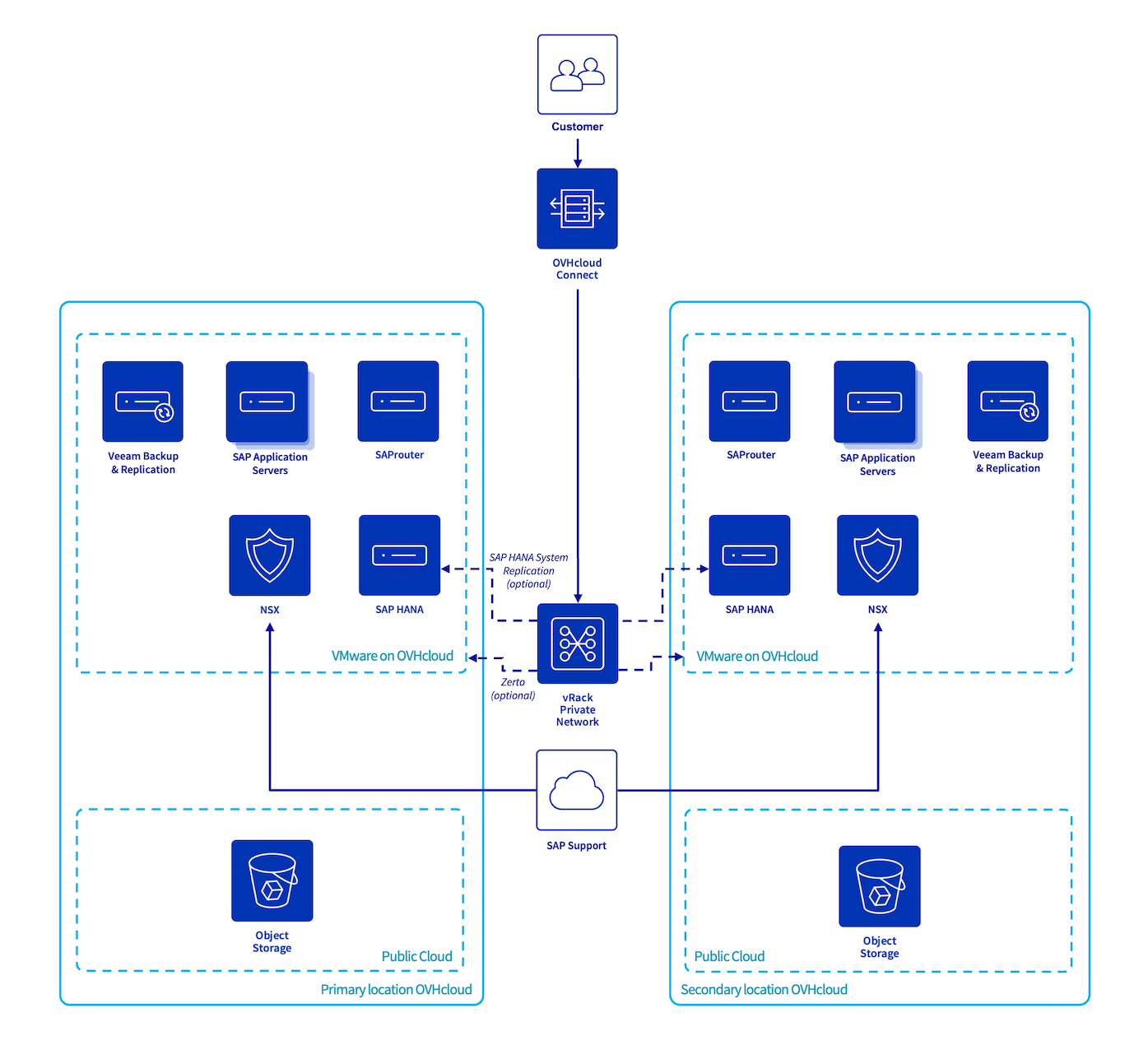

The following concept allows you to build an architecture with an SAP HANA database up to 1.5 TB, to use all VMware on OVHcloud features (templates, Zerto, NSX, DRS, Fault Tolerance, High Availability) for your SAP infrastructure in a single OVHcloud location or multiple OVHcloud locations.
schema
ObjectiveDescription
Objective #1Building an SAP infrastructure based on OVHcloud Managed VMware vSphere®, Hyperconverged Storage SAP HANA pack or OVHcloud Managed VMware vSphere®, Software-Defined Datacenter SAP HANA pack.
Objective #2No compliance requirements with SecNumCloud regulation or PCI DSS certification.
Objective #3An Infrastructure Recovery Point Objective (RPO) of 15 minutes.
Objective #4 (optional)An SAP infrastructure available in a second location which can be activated in the event of a major issue impacting the primary location. This second location offers an Infrastructure RPO near to zero.

1 - Network connectivity
To guarantee the quality of communication between your local site and your SAP infrastructure hosted at OVHcloud, we recommend using OVHcloud Connect. This solution offers you a secure and high-performance link between your offices and OVHcloud. To get more information, please refer to the OVHcloud Connect documentation.
Instead of using OVHcloud Connect, a point-to-point VPN can also be deployed with NSX if you use a OVHcloud Managed VMware vSphere®, Software-Defined Datacenter SAP HANA pack. To learn how to configure an NSX Gateway VPN with OVHcloud, please refer to our documentation. If you use a OVHcloud Managed VMware vSphere®, Hyperconverged Storage SAP HANA pack, you must deploy a virtual machine to manage this point-to-point VPN.

4 - Backup infrastructure
We recommend using an Object Storage bucket in a different OVHcloud location from the one on which your workload runs, to protect yourself from a major outage on the primary OVHcloud location.

7 - Dual locations (optional)
To eliminate the risk of losing a single OVHcloud location deployment, consider adding a secondary OVHcloud location.
7.1 - Network connectivity
As with the primary OVHcloud location, we recommend using OVHcloud Connect. If this solution is not suitable for you, a point-to-point VPN can also be deployed with NSX, or a virtual machine which handles this role for the second OVHcloud location.

The SAP HANA System Replication called SAP HSR is used to replicate the data and configuration of primary OVHcloud location to your secondary OVHcloud location. This replication allows you to secure your data in another SAP HANA database and thus achieve the lowest RPO possible.
To discover the replication modes supported by SAP HANA, please refer to the official SAP documentation available on the SAP Help Portal. However, within the scope of this concept with two OVHcloud locations, we advise you to enable the data and log compression and use the ASYNC replication mode. Find more information on the SAP Help Portal.
If you trigger a takeover to your secondary OVHcloud location, you should switch the SAP Application Servers too, to guarantee the performance between the SAP Application Servers and the SAP HANA database.
Another solution could be to use the feature named Zerto in your VMware on OVHcloud solution, allowing you to replicate your virtual machines to a VMware on OVHcloud solution hosted on a secondary OVHcloud location. By default, every 15 minutes, a log backup is written on the disk, therefore even with this technical solution, the RPO stays at 15 minutes.
If you are interested in use cases with Zerto in an SAP HANA context, we advise to read the Zerto documentation.

To secure your infrastructure in the event of a major incident in your primary OVHcloud location, we advise you to enable the feature named Zerto for your VMware on OVHcloud solution, allowing you to replicate your virtual machines to a VMware on OVHcloud solution hosted on a secondary OVHcloud location. With this feature, you secure your SAP Application Servers on a secondary OVHcloud location with a synchronous replication, and you reduce the RTO and the RPO if you have to switch to your secondary OVHcloud location.
To know how to enable this feature, please refer to the OVHcloud documentation.
If you trigger a switch to the secondary OVHcloud location through Zerto, the SAP HANA database has to be switched too, to ensure the performance between the SAP Application Servers and the SAP HANA database.

As mentioned previously, we recommend using an Object Storage bucket on a different OVHcloud location from the one on which your workload runs, to avoid a major outage on the primary location. A cross backup is safer for your business data.
7.5 - SAP Support connection
To guarantee the connection continuity with the SAP Support, we recommend configuring a second SAProuter on the secondary OVHcloud location. If your Disaster Recovery Plan is triggered, and if the SAP Support has to connect to your SAP systems, only the public IP address in the SAP Support LaunchPad should be updated to recover the connection.
