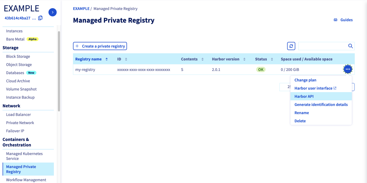

Go to your private registry section on the OVHcloud Public Cloud Manager, and in the more options (...) button at the right, click on Harbor API.
API Harbor

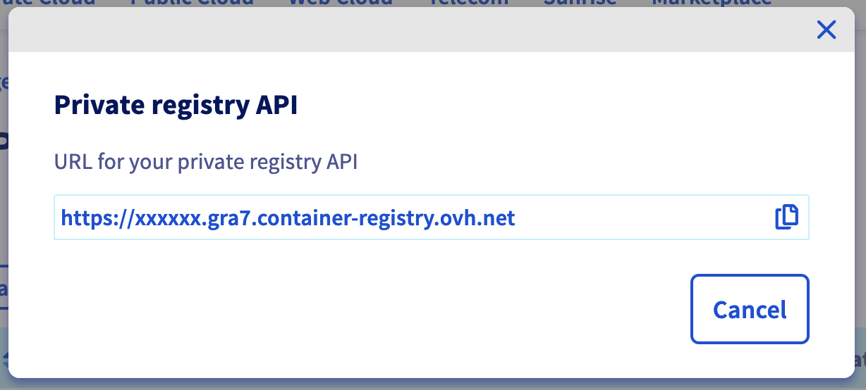

Copy the URL of the API Harbor, it's the URL of your private registry and we are going to use it several times in this guide.
API Harbor
In fact, when you click the copy button as indicated by a hand icon in the image, the copied string starts with https://. Please remove the https:// part.

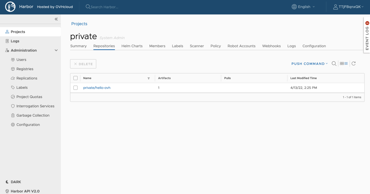

If you go to your Harbor UI, you will see that a hello-ovh repository in the private project:

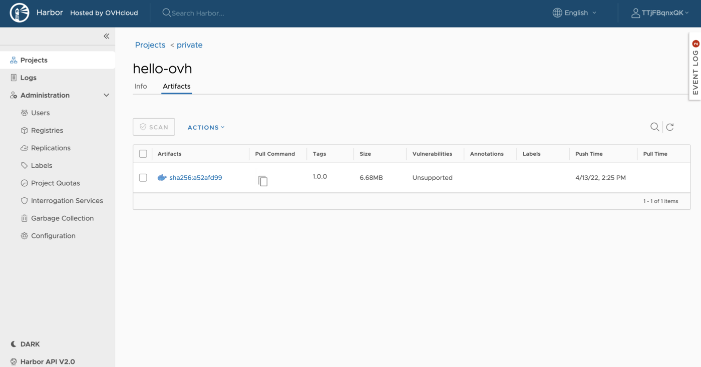

This repository will store all the versions of the hello-ovh image (right now only the 1.0.0):

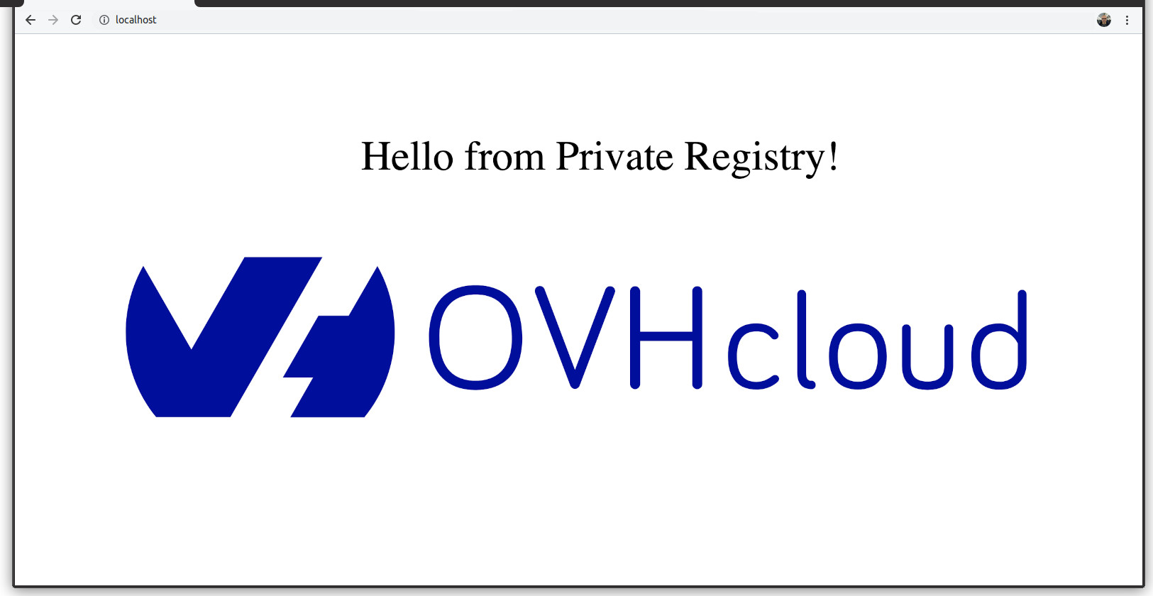

Or in your browser:
hello-ovh
