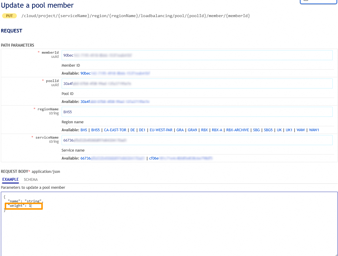

You can update a pool member with the following API call:
Fill in the fields with the previously obtained information:
  • serviceName: The Public Cloud project ID in the form of a 32-character string.
  • regionName: The name of your region.
  • poolId: The Pool ID in the form of a 32-character string.
  • memberId: The Member ID in the form of a 32-character string.
  • weight: Set the weight to 0.
Click on Execute.

Once the maintenance is complete, set the weight of member_0 back to its original value (e.g., 1):
To update the weight, use the following API call:
  • weight: Set the weight to 1.
Click on Execute.
